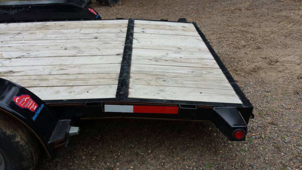

I am thinking of adding 4 feet total to a 16 foot car trailer. I have been looking on line about the 60 40 rule now everybody had their own way of doing it so how would you do it?

Sell the trailer and buy another.
I'm not being a smart azz. It's tougher than it looks and the reality is it will end up being heavier than it needs to be, pull awful, and be something no one else wants at a later date.

I have been in the boat and trailer business for over 25 years. It just doesn't work out doing that much modifying. Weight and balance are always a issue.
The side rails and axles are sized accordingly. To do it your will have to add structure. That's going to raise the trailer making it tougher to load, less stable, less fuel efficient, ect. It also will add significantly to the empty weight. About 500 to 700#. This will make the trailer easily overloaded.
Lastly, the cost. You will need new decking, the steel, the welding supplies, new wiring for lights and brakes, ect.

In my area good used trailers sell for about 75% of new ones, it's crazy. With a new one you will get new tires, new lights, new deck, wiring and brakes, for 25%.
If it's an old trailer, and not attractive enough to sell well, I'd lengthen it to make it work for you. I'd do the 60/40, that's 20" longer in the back - not much. Make sure you use the same materials it was built with, same channel etc and put doublers on the inside. The outside you can grind it to be invisible. Longer trailer holds more "stuff", so be careful not to overload it. Someone else may be unaware it's a smaller trailer with a big deck, assume the axles are bigger etc, and overload it, that's the downside.

Is the trailer 60/40 now? If it's a pro-built trailer maybe extend it the same ratio as the mfr did.
I agree about giving it a hard thought. Set a 4x8 sheet of plywood on blocks, or on the ramps behind the trailer, and look it over. 4 feet is a lot bigger. Can you get what you need by adding 2 or 3 feet?

Well I can get the tractor on and the bucket to on the trailer but the tractor is so far back!!!!.I'll post a pic.later. After thinking about it more you guys are right it looks easy but I don't know trailers. I have the add on CL and no calls and the price is good but one wants to buy now.

Just to weld on 4 ' would be a lot of work!. That black band is right at 14 feet that where my tractor wheels land so this way I could have the few on the trailer also.

I suppose you have tried backing the tractor on, that doesn't work? Is there too much tongue weight?
When you extend it... consider deleting that bend. Maybe it won't need to extend a whole 4 feet. How close are you to the "MFR's weight limit"?
And are you confident of your weld/fabrication ability? This is kinda serious business, you want a bit of experience behind this kind of fabrication (to put it lightly).

I think I am close if you go by the numbers on the web. If I do it that way I won't have to move the axles at all!.
