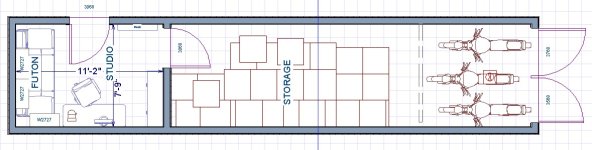

Why do you need a door to get to the storage area from the living area? Why not just go through the existing doors and not have that door taking up wall space?
Or if you keep the door, why not put a bathroom there?
Eddie

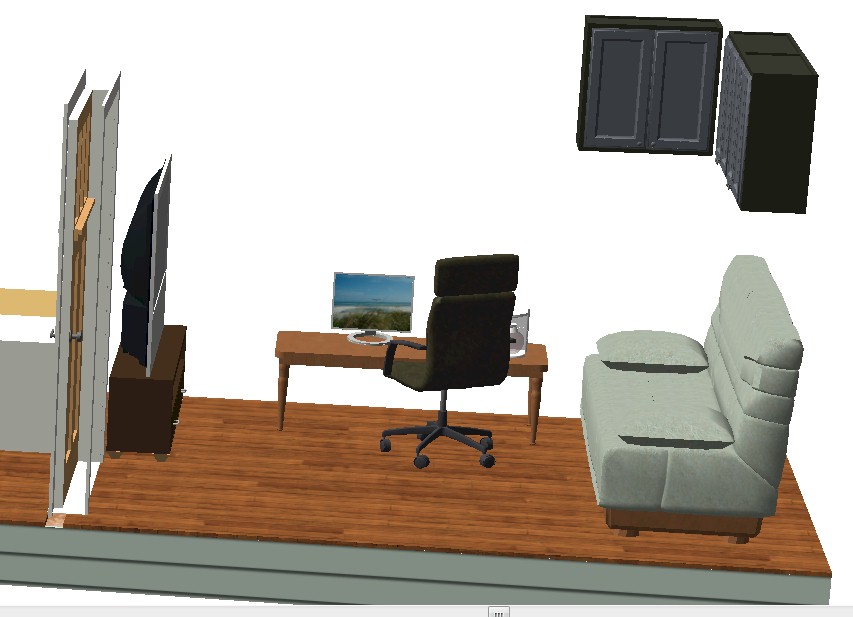

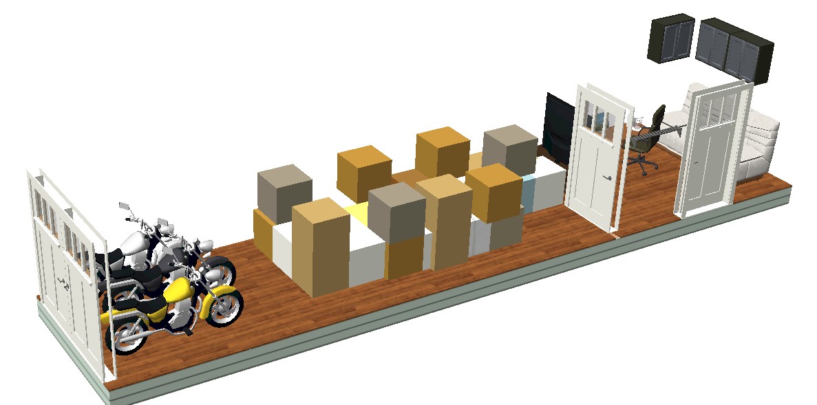

Ah, some background info is needed: I am going to be driving trucks for the next year or two, where I expect to be living out of the truck 24 days a month, and home about 6. So, I will only be living in the bunker about 2~5 days a month. A bathroom would be great but a. I will have access to a bathroom near by (my folks) and b. I really don't think there will be any room left over. I've packed most of my stuff and I'm worried 30 feet of storage may not be enough. :ashamed: I do want a door inside, so I can access the storage section from the living quarters, will make it a lot easier if I can store clothes and households nearby without cluttering the living quarters.

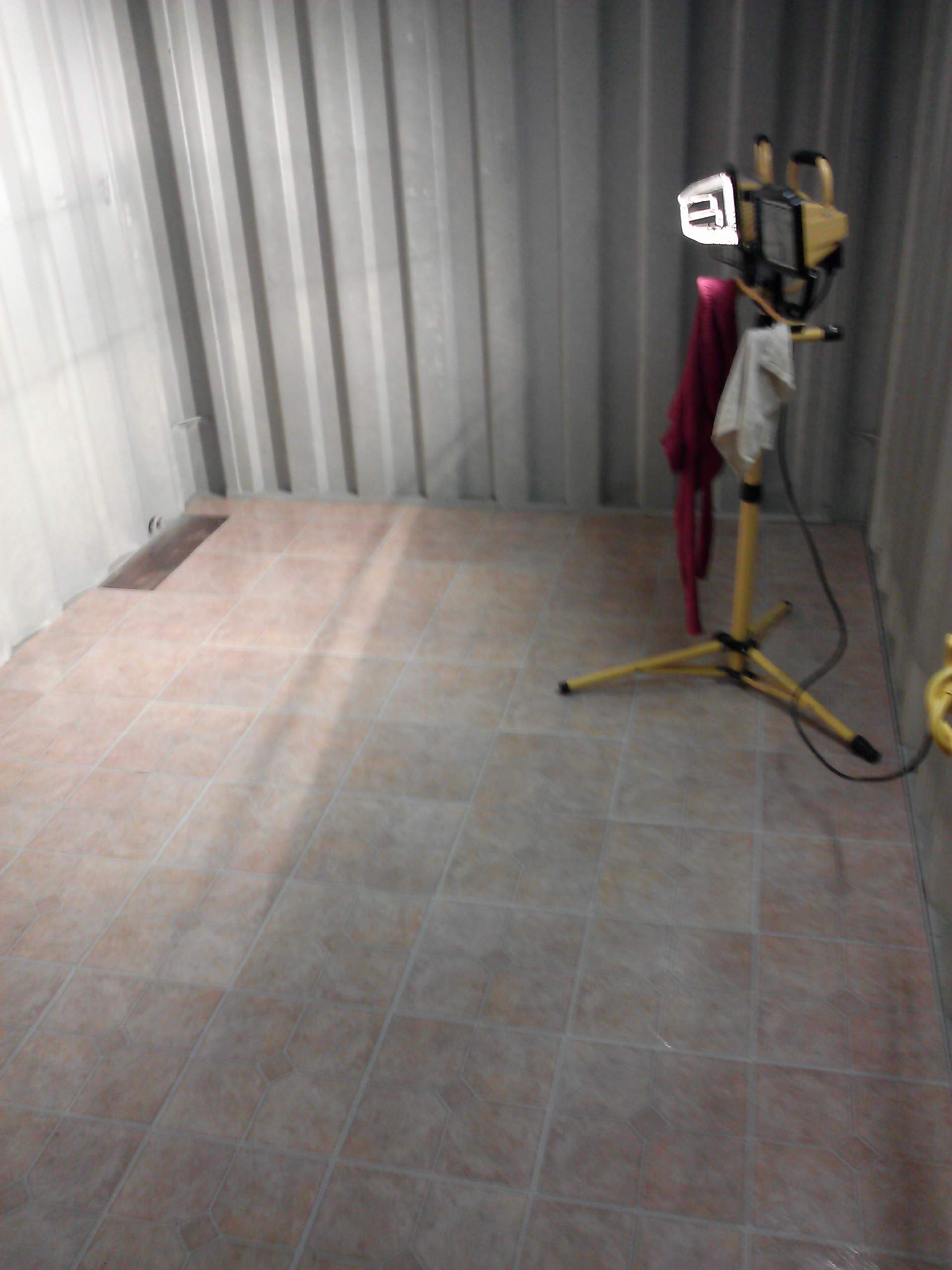

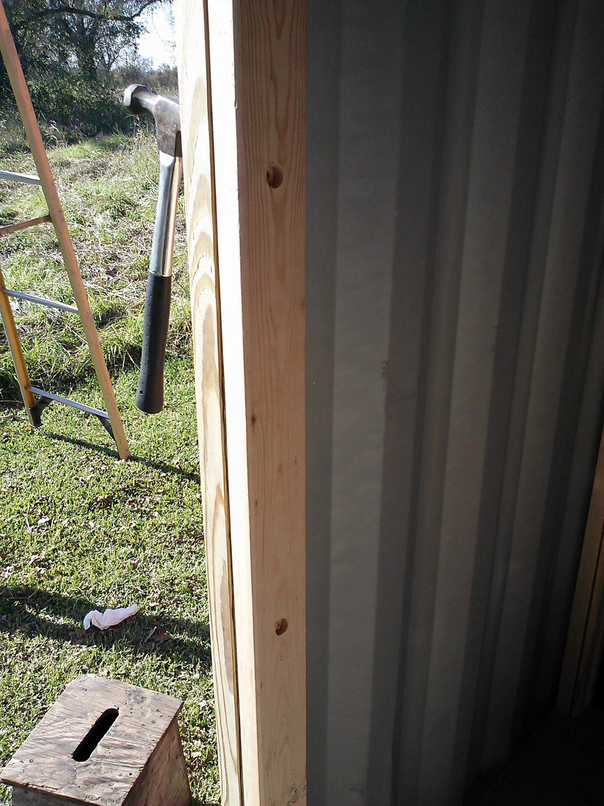

Today was a busy one! We built a shelf in the storage section, about 16 x 4 and 4.5 feet high. You can only stack boxes so high, so this allows me to stack to the roof.
Also, got the interior wall done, Next-- an entry door.

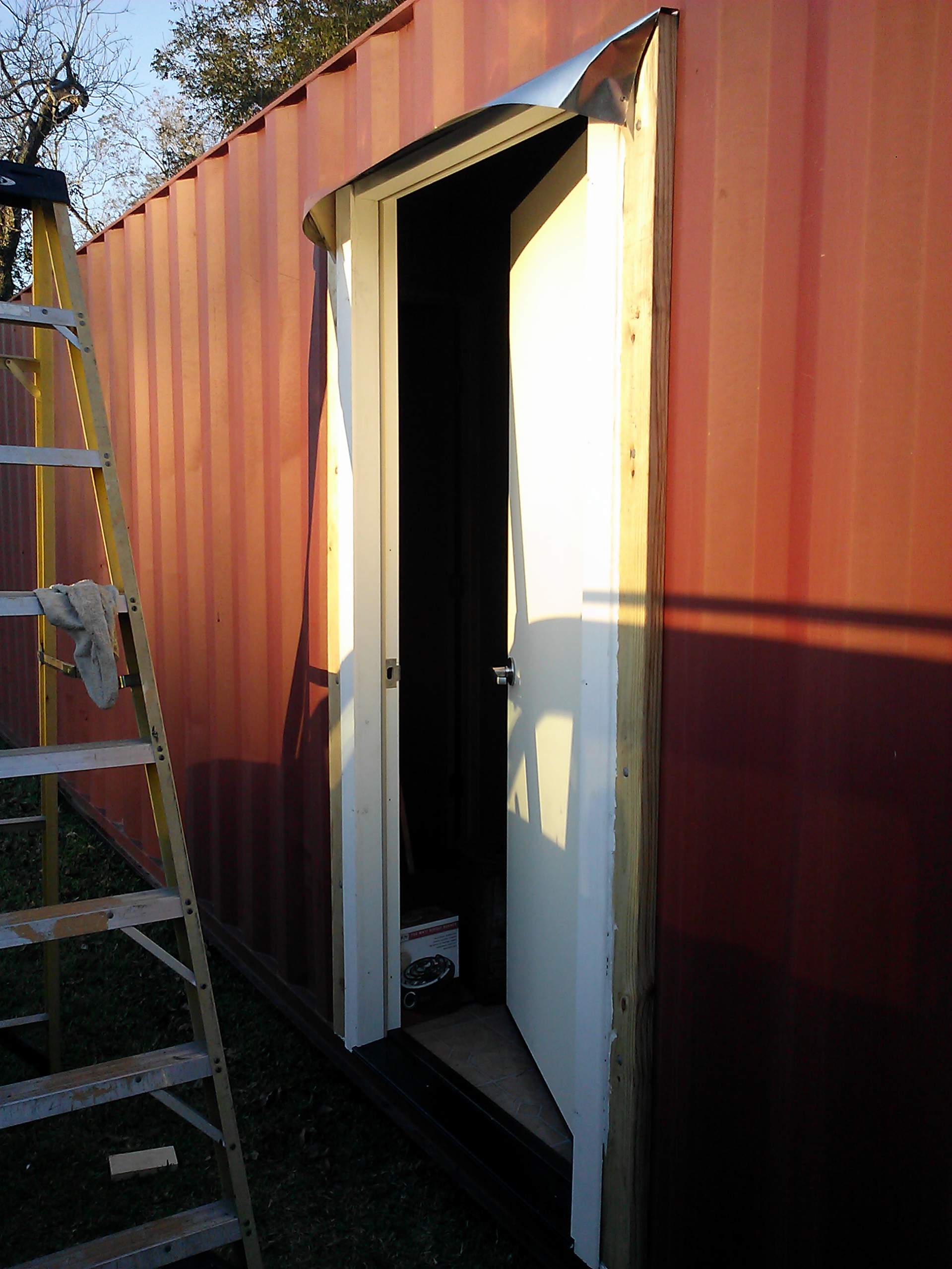

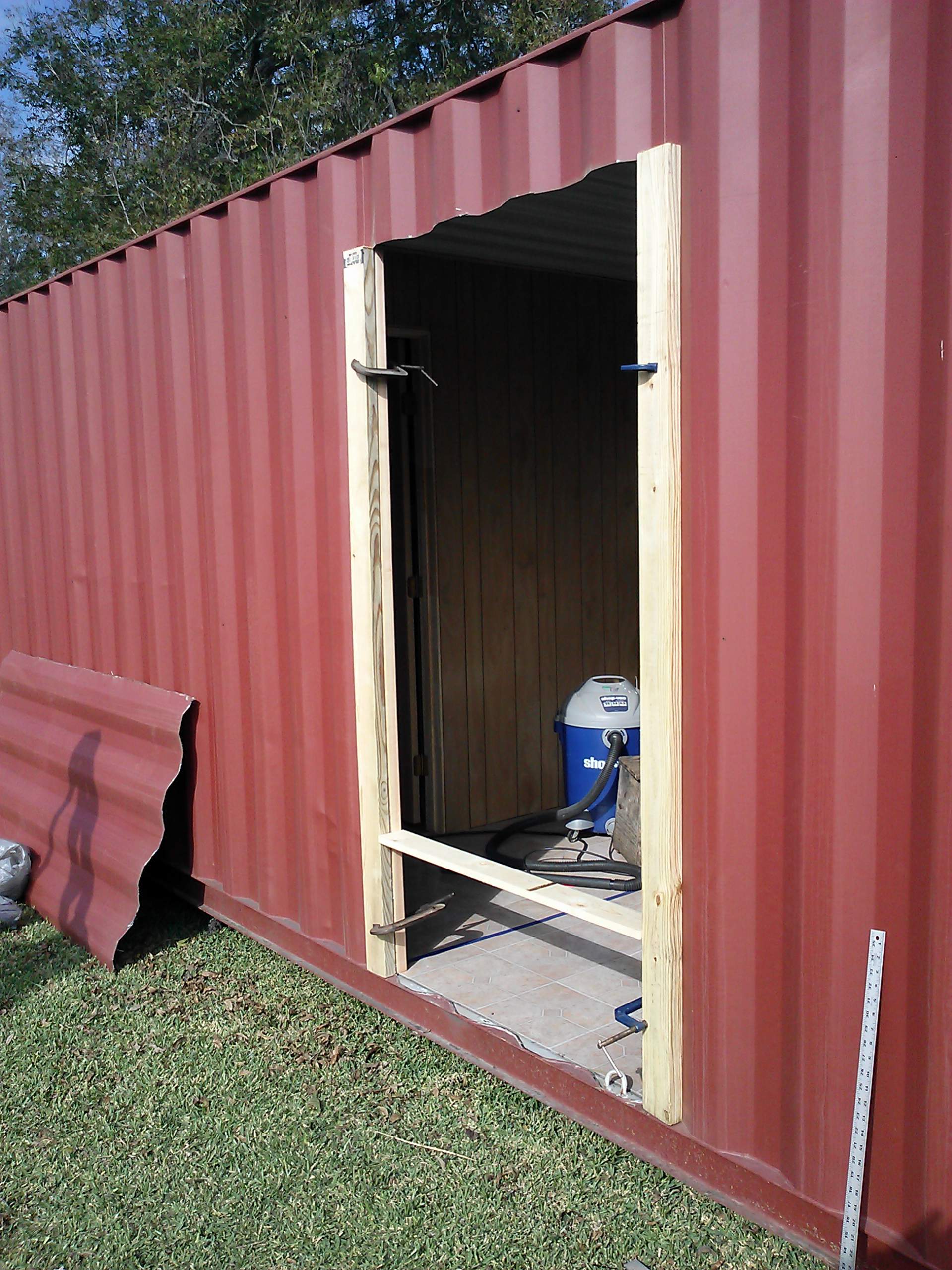

Finished the exterior door, and also here are some pics of the solar powered vent (which has since stopped working :confused3:, they are sending a replacement).
