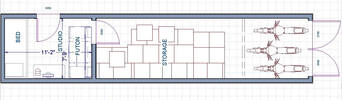

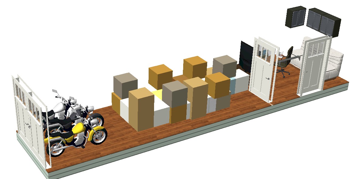

I've never bought a window unit before, so I am researching what I need. I have a 40 ft shipping container, with an 8 x 11 foot section walled off at the end opposite the big doors.
I am looking to cool the room section to about 76. It's about 88 square feet. The window units are rated by BTUs and the vendors list suggested room size, such as this one from Lowes. Yeah, that seems like a lot of AC for a small room, right? I intend to add Foam it Green to the exterior walls around the 8 x 11 room section and paint with rubberized roof paint, so the end of the shipping container should be fairly insulated.
I am thinking the window unit should be a bit more powerful than a unit rated to cool a 100 sq foot room, because this is a shipping container... but it doesn't make sense to go overkill with a unit that's exceedingly too powerful. It's hard for me to determine what's about right...
I have been reading your threads here for a few years and I am definitely interested in your thoughts! :thumbsup:

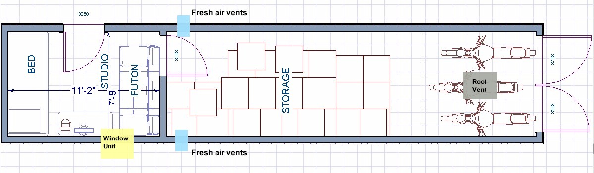

The interior door has a 2" gap at the bottom, Should l allow it to function as a vent to the rest of the container, so that the Cool air flows through to the uninsulated section, to help keep it cool and dry? I know it won't be 76 degrees, but some cool, dry air would be good, right? Or would that be really inefficient and cause the unit to run endlessly?
I have already installed a solar powered vent on the roof at the end by the double doors, would it make more sense to add a pair of fresh air vents and seal the interior door?
Thanks for your feedback.

You may also want to do a little re-design of your layout to keep the futon from almost completely blocking the interior door. Maybe if you moved the interior door to the opposite side, turned the futon so it is aligned with the bottom wall, the put the desk on the wall next to the exterior door, it would work a bit better. Just play with your design a bit to make it more functional. Maybe even make the room a little larger as a 5K BTU would cool a much larger area than you have planned.

I think I would try to seal off the storage space completely. A little bit of cold air from under the door might be doing just the opposite of what you want and cause condensation or mold problems especially in the really moist air around Houston just like an iced tea glass "sweating". I would put in some vents at the floor level and again at ceiling height so there is natural circulation sucking in the cool air at the floor and venting hot air out the top. I wouldn't mess with putting anything thru the ceiling due to the corrugated construction of those containers it is very hard to get a good seal on those flat roofs which have to channel the water to the edge and depending on how you set it, it could hold some water on top. I like to set them lower on one side by about 1" so they drain well.

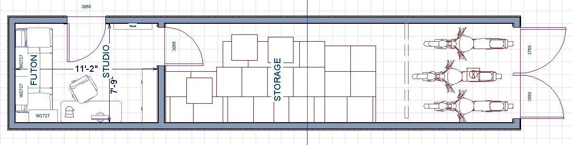

I think you're right, Gary, it makes more sense to seal off the living quarters and use ambient venting on the storage area.

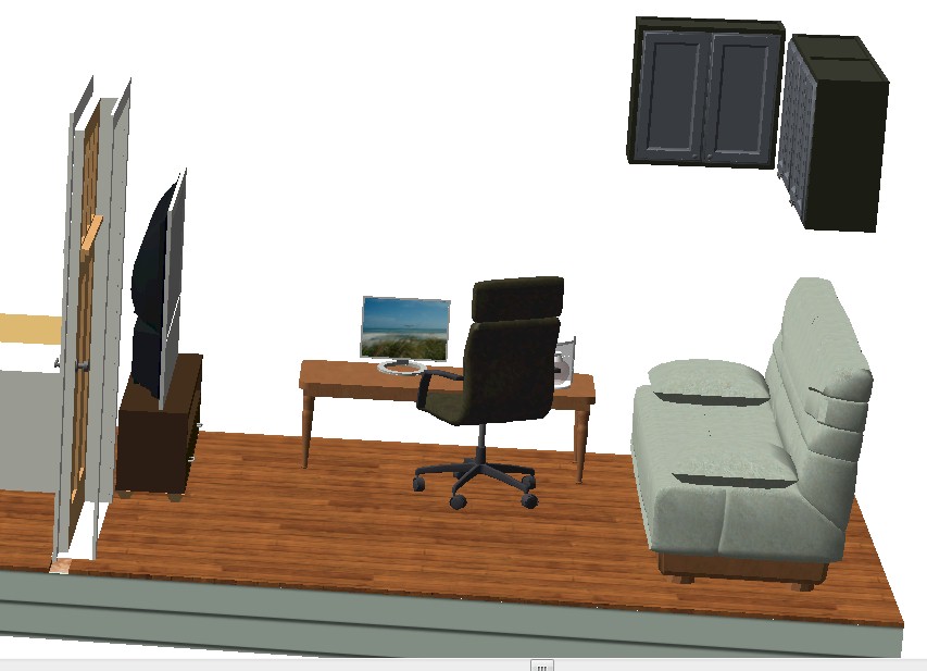

I've modified my floor plan, per your suggestion, may as well use the futon as a sofa and a bed, since that is what it's designed for :cool:

Why do you need a door to get to the storage area from the living area? Why not just go through the existing doors and not have that door taking up wall space?
Or if you keep the door, why not put a bathroom there?
