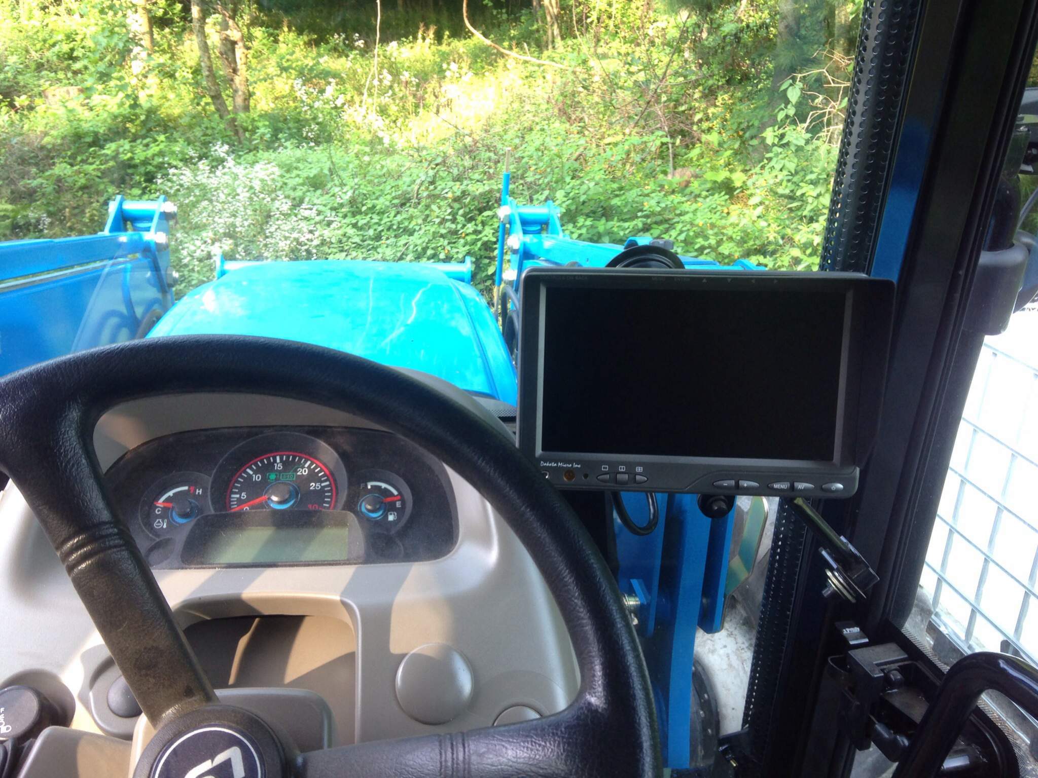

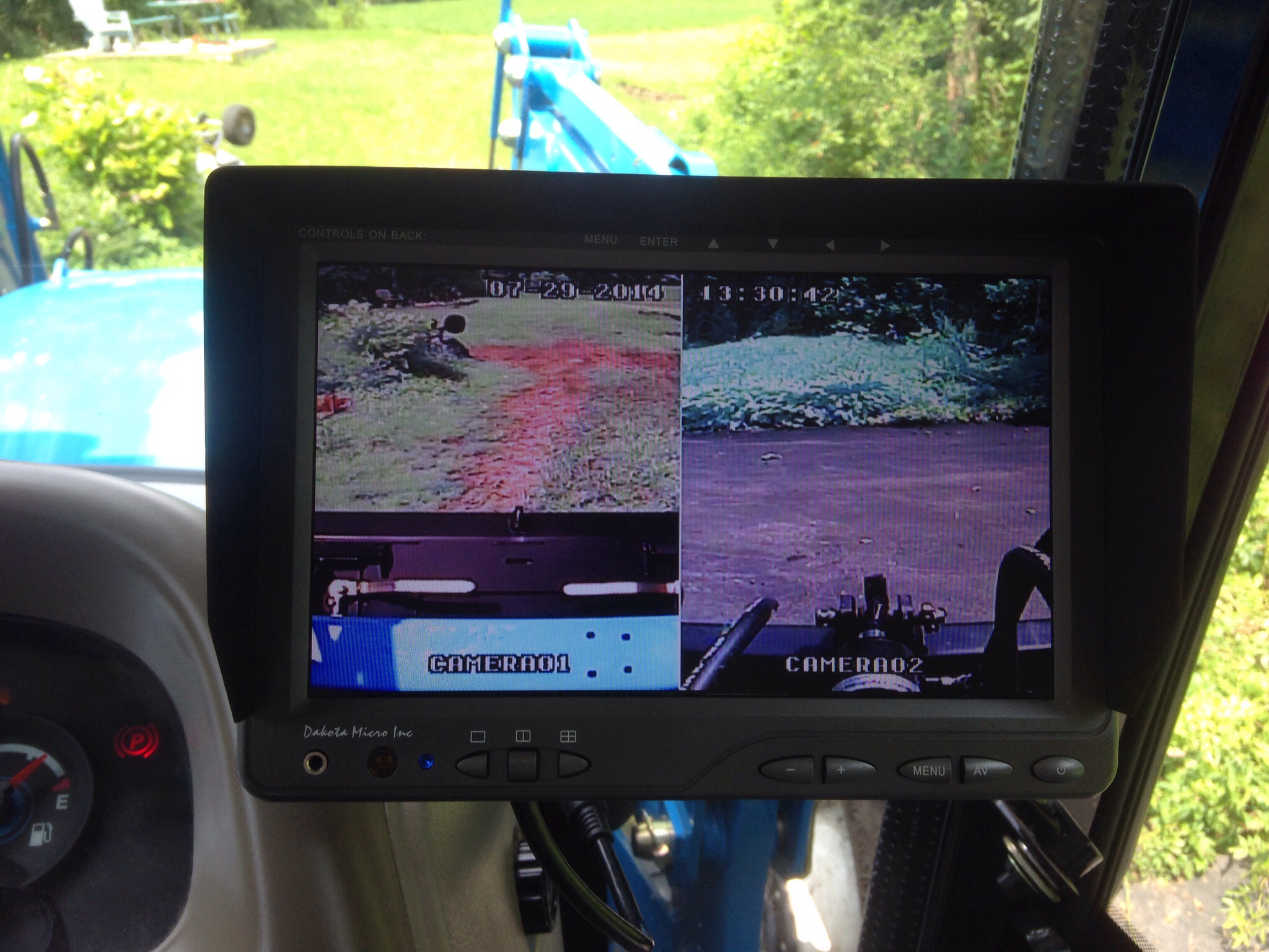

Installed my monitor and backup camera in the truck today. Also works very well.

My camera and monitor arrived today. It was only a few days ago that I placed the order. Installation was quick and easy and it works fine. I only began mowing at 8:00 this evening, but there was a good 45 minutes of decent light. When it got dark and I kicked the LED's on the picture had a little washout because of the bright lights. Here's a pic with normal but fading daylight. I already managed to use the camera to back the deck in between the mailbox post and an adjacent utility pole.

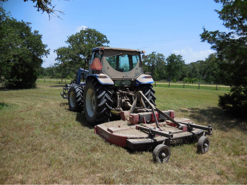

I bet the camera is nice for mowing.
Picture looks good chim, very acceptable.

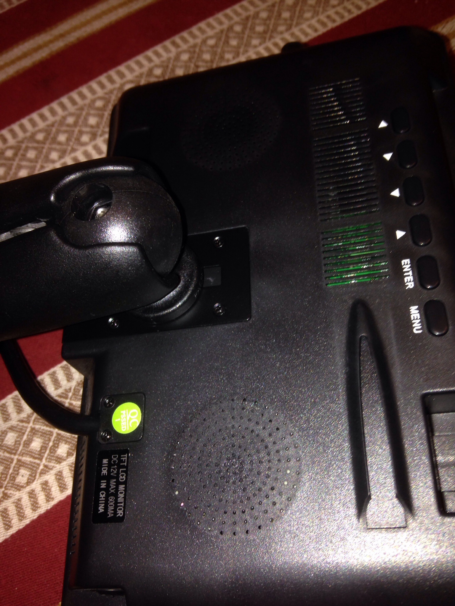

Detail of monitor mount.
Example of monitor in and out of direct sunlight.

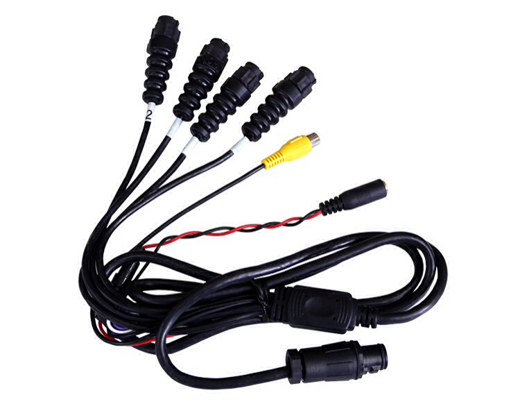

How do the cameras hook up to the agcam? My camera uses a yellow A/V cable like a the inputs and out puts on a tv.

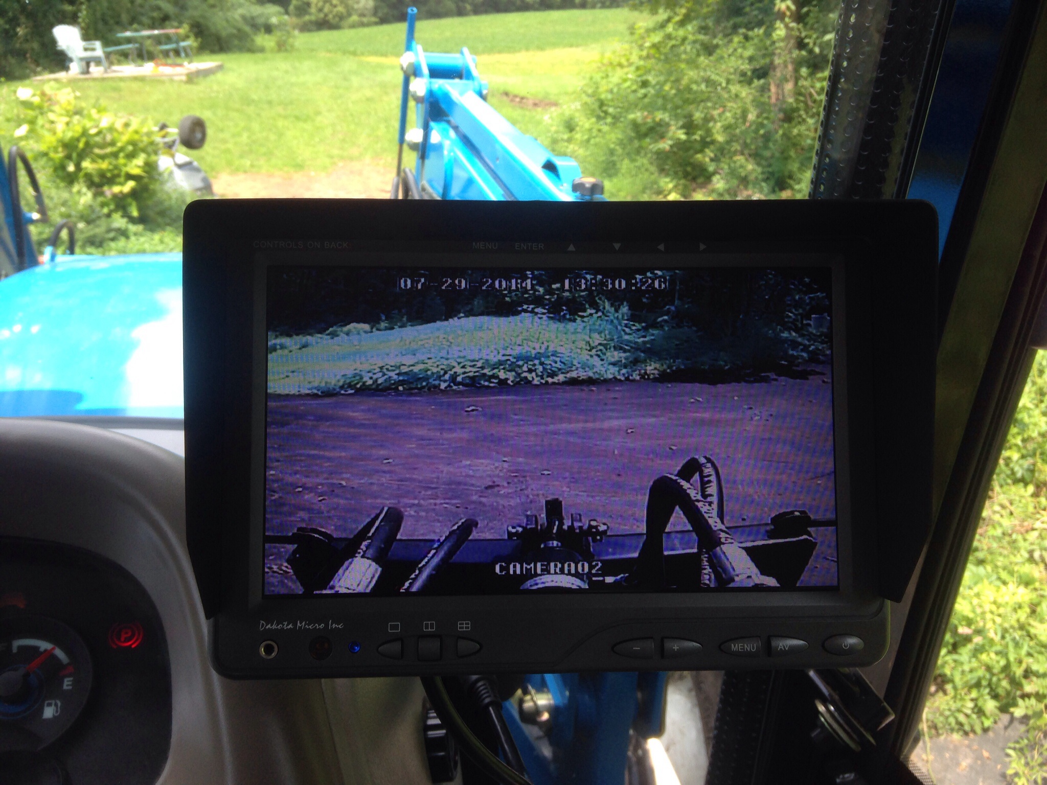

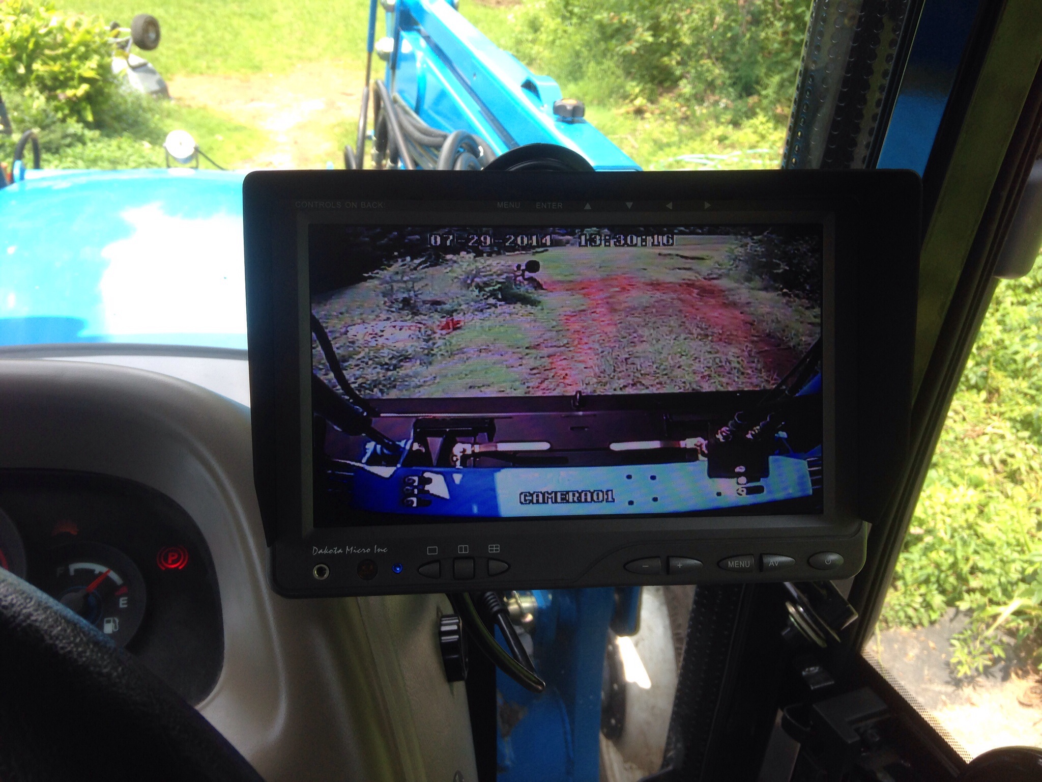

Not sure if I have a bonafide "problem" other than image quality of a $599 monitor versus one for $28. To be totally fair it does have some nice features. Up to 4 cameras, time and date on screen, split screen, automated switching with programmable intervals, lines that can be turned on or off etc. Not sure how many of them I will use, but they are there.
The cameras themselves seem pretty bulletproof and are waterproof including all connections so I would list them as a positive. But I'm not sure if I had a better HD capable monitor that these standard def cameras would look any better. 10 years ago these would be sweet! Maybe my expectations were a little high considering the difference in price.
Here are some screen shots and a picture of the cable connection.

I bought an AgCam adaptor to convert their plug to RCA but it came with a 12 volt power supply also. Only way you can get it.
The resolution was fine on the 7 inch, a nice smooth picture but washed out and dull. In my opinion. So the more you adjust the color the more it would shake. It looked good once adjusted but the picture would shake.
So nice green grass would be moving in the monitor turn the color down and it would stop. They said is was because of the quad monitor stuffed into a 7 inch case.
I could not fit the 9 inch monitor on top of my gauges so they sent me another new 7 inch, it was better but I wanted something better then that.
They said the 9 inch did not shake in there tests. The 7 inch non quad monitor did shake a little less but the 9 inch according to them did not shack at all.
What is wrong with your picture? Did you try to adjust it? The resolution should be fine. When I say that I mean the pixels are very close together my 7 inch was good in that regard.
Use your adjustments, that monitor should work well. If it does not I would contact AgCam and complain, have them send you another. They told me the 9 inch was fine.
I'll be interested to see how the cameras compare to each other. I'm wondering how a wireless camera would work.
That is a nice mount.
View attachment 384593View attachment 384594View attachment 384595
The monitor does sound like it has some nice features. Hopefully you can adjust the settings like Waxman suggested and get the picture quality to improve.

Has anybody used the blue wire on their monitor? I did not have a use for it since I only have 1 camera. I'm not sure if the blue is used for turning the monitor on when the vehicle is in reverse or it changes the channel when the vehicle is reverse. IDK how it works but if the blue wire changes channels when the vehicle is in reverse it would be nice for those of you with a FEL cam and backup cam. You could keep it on the FEL cam when you were doing loader work and it would automatically switch channels.
/ A backup camera for $50!!!!!!!!!!! #77
The blue wire is for reverse sensing. I taped my blue wire off. To have the monitor flip to the reverse camera hook it up to anything that gets 12v in reverse only.

My monitor and camera arrived late last Friday afternoon and I bench tested with a 12 volt battery in my shop Saturday. I will install first camera on front of tractor to get a better view of grapple, bucket, pallet forks etc. I did not get a chance to figure out how to use the blue (backup) wire. The instructions with camera and monitor that I received were all but useless. Maybe they missed sending the real instructions? I had to pretty much guess how to hook everything up so don't have a clue on how blue wire works. Think I will be happy to just select Camera 1 or Camera 2 from monitor controls.
I plan to create a temporary (maybe permanent?) magnetic mount so, I can find optimal location for front camera to achieve best view while giving camera some protection. Ordered a windshield mount today with 1/4-20 screw for mounting monitor in cab. Should receive it Friday. My plan is to mount it in upper middle of windshield which should help with outside light reflection, etc.
