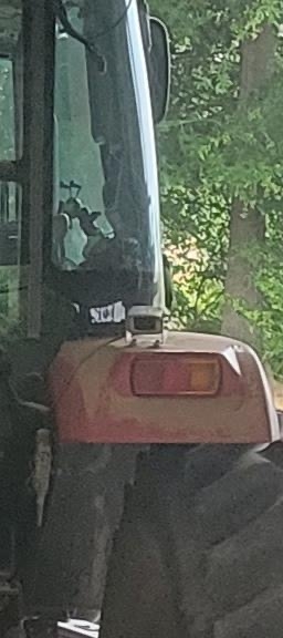

I just installed a camera on my Branson last week;
What have you done to your Branson today?
I used a more expensive camera and monitor then many do.
The monitor is a 9 inch which can do numerous display modes from single camera views to multiple cameras at the same time.
I also got digital HD wireless cameras and the nicer part a magnetic mounted battery to power the magnetically mounted camera.
The resolution and picture quality is very good

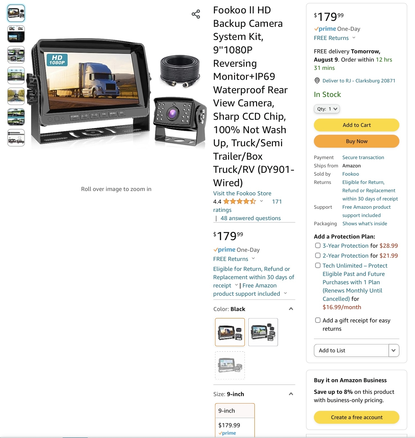

I have these two. I like them both. The cheaper one resets all the settings every time I shut it down so I had to fiddle around with it some. The more expensive one is worth what I paid for it but there are cheaper options on Amazon that are probably just as good. As with all cheap Chinese electronics, your mileage may vary from unit to unit and vendor to vendor.
One thing I did was mount all my cameras and monitors with neo magnets. In the case of my excavator, I used the monitor mounting adhesive strip to stick the magnets to monitor mounting bracket so I can move the monitor around at will. Three magnets are plenty strong to hold it and I can still use my flip-up front glass without it hitting the monitor. In my skidsteer, I don't have the space problem with the flip door so I just stuck it the monitor and to the left near a switch block with an empty slot.

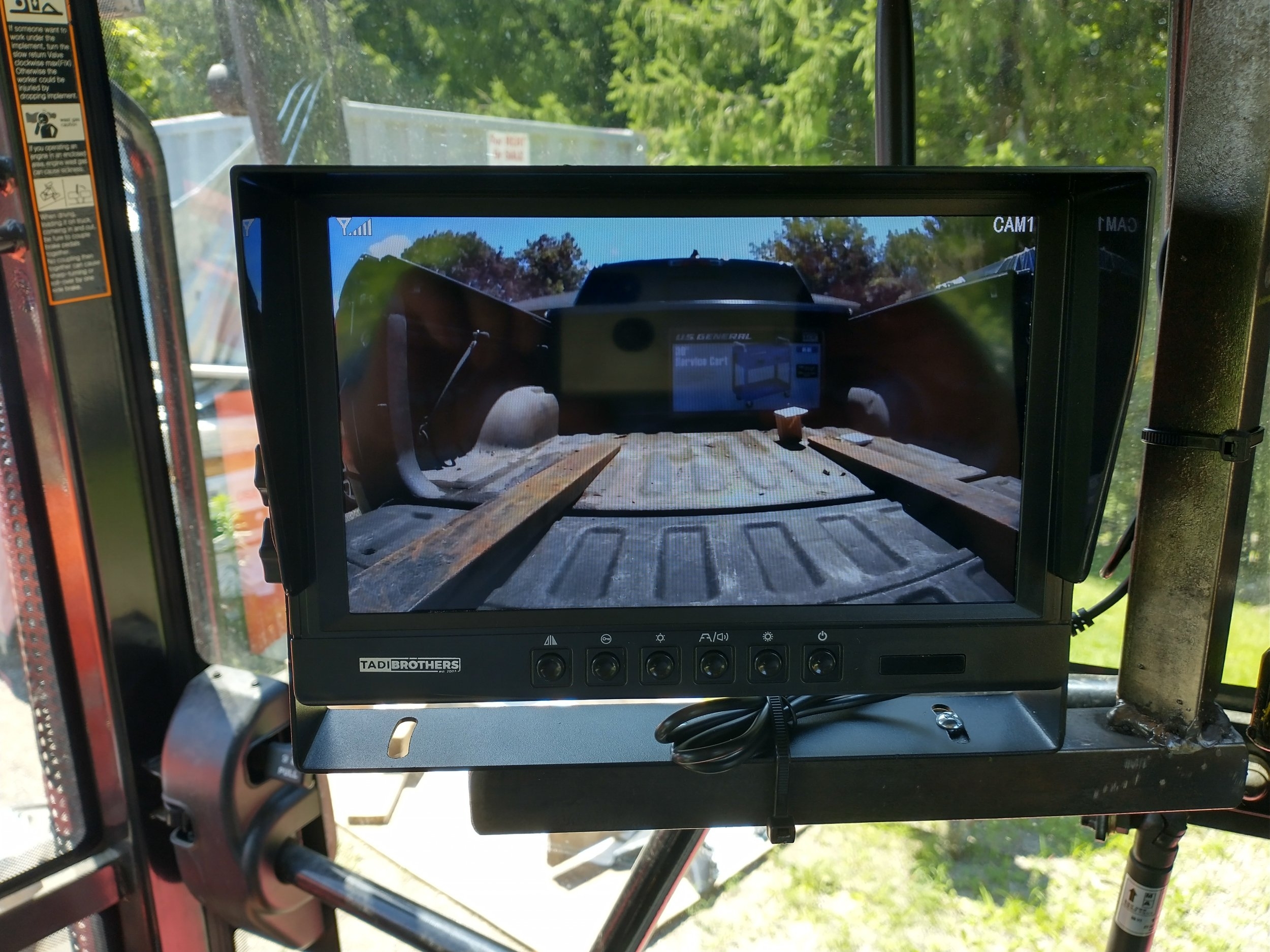

This is a photo of my wireless cameras monitor with the camera mounted on the fork mount.
taken while the tractor is running.
