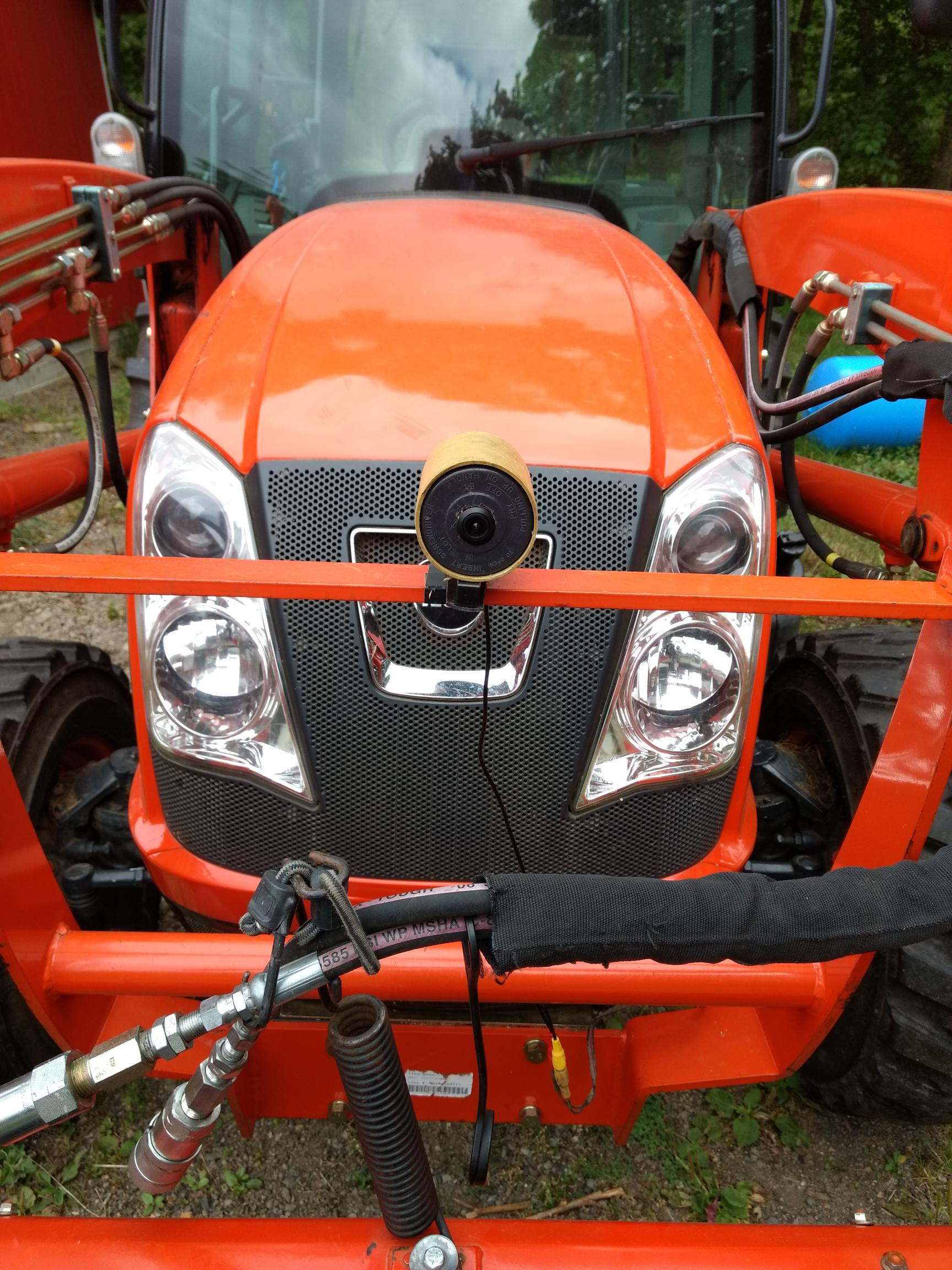

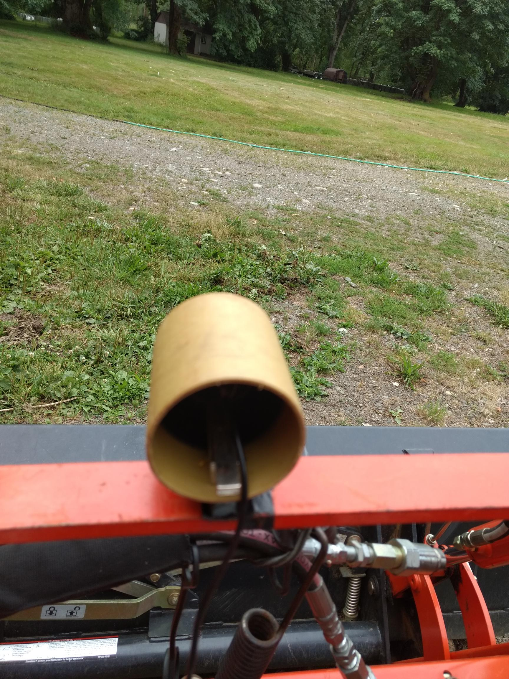

I'd thought that I'd posted pictures but apparently I had not. So... Here is what I came up with for a movable front camera mount, one that can protect the camera and take a beating (needs to provide some give). It's a section of a PTO shaft cover with a spray can lid fitted in the front with a hole to receive the camera (in theory the camera will snap-fit in) I need to perfect this- can't use any drill or saw to make the hole in that plastic as it's too brittle- need to cut with heat. Attaching to the tractor is accomplished via a couple of super magnets; one on the inside of the shaft guard and one on the outside (they pinch and hold the inner cap from rotating/moving- can kind of see this in the picture taken on the backside); an additional piece of plastic goes between the outside magnet and whatever you're going to attach to (otherwise the super magnet is going to stick like crazy and scratch paint). I struggle with placement in order to SEE when I'm using my pallet forks. I've found that moving the camera to the brush guard's vertical side bracket allow me to angle the camera up or down for best angle: display on monitor then needs to be rotated to match reality.
Looking from the front:
From the rear:
Yes, no front grill guard. I know I'll curse myself, but with over 1,800 hrs operating two tractors in really nasty stuff I have not really damaged anything at the front: I need a top hood guard, though, as I've managed to dent the tops of BOTH hoods!
