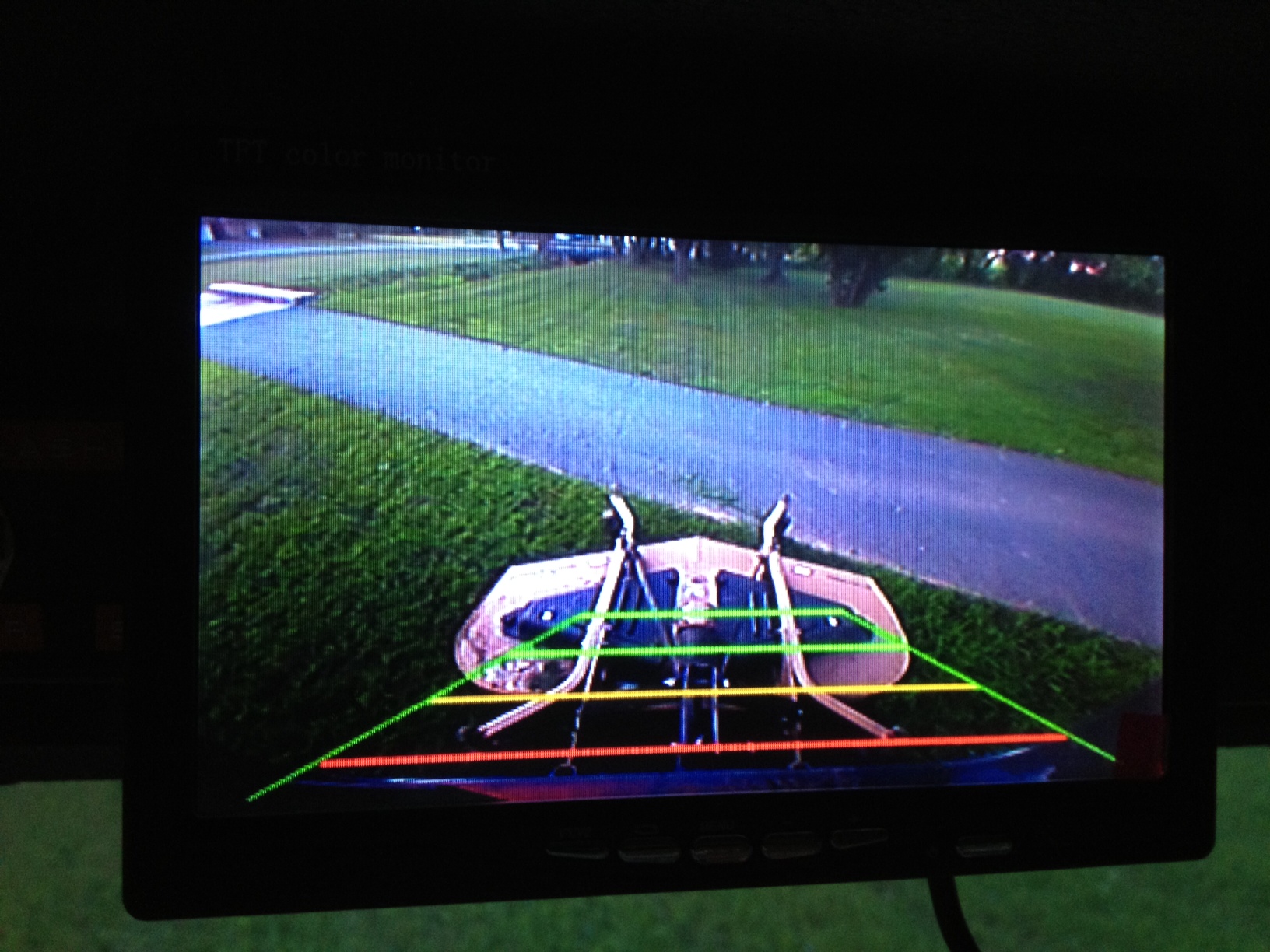

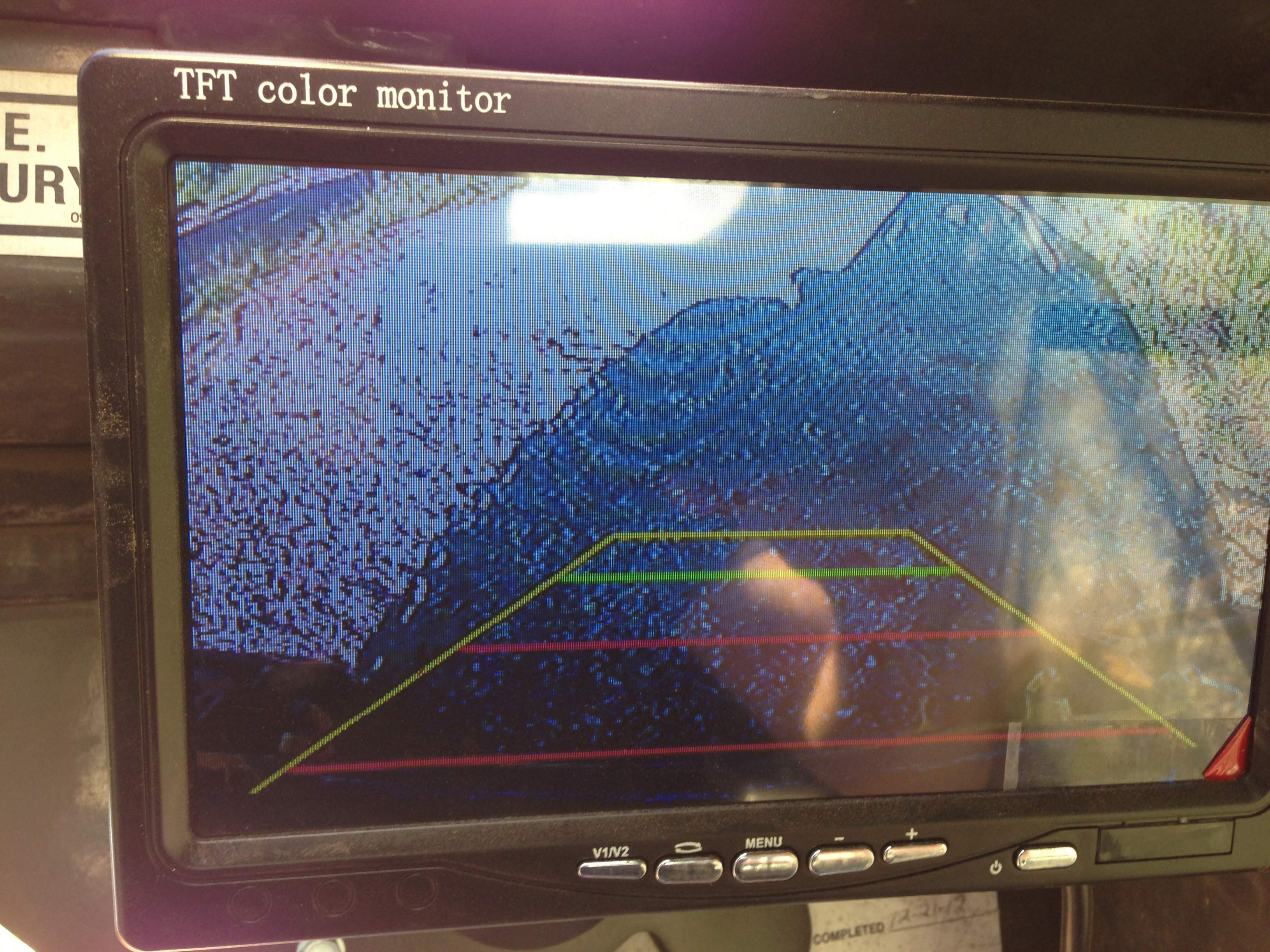

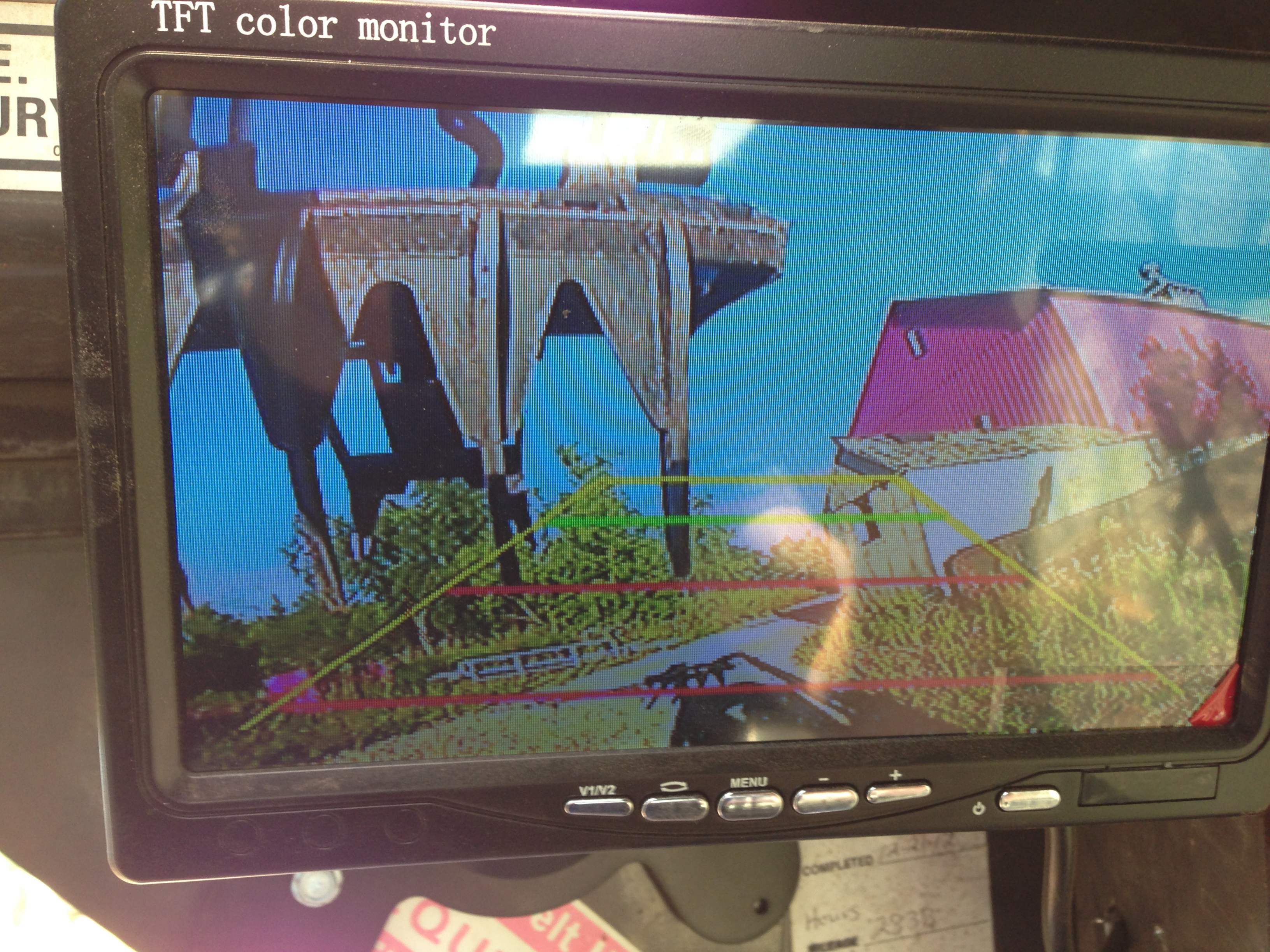

I fiddled with the colors last night and got this better, but the colors are still terrible. By biggest issue is with the resolution. I can barely make out the objects that are more than a few feet away.

That may indeed prove to be an issue since these units are designed as "backup" cameras where you only care about a few feet of view so, any great depth of field is not needed.

My monitor arrived a few days before the cameras. I hooked up another camera (a spare from my home security system) to see how it worked and was disappointed. A few days later the cameras arrived and I thought the view on the display monitor was pretty good. I don't know why but yours seem to be pixelated (especially the first pic). I only want to see where the tips of my forks are in front and the 3 pt attachment on back. I don't expect hi resolution perfect views for $50. I think the view is comparable with the backup cams in my car and truck which cost a lot more.
Take the protective plastic off your display to see if that helps.

Cord, I installed the same make monitor last week, and presumably the same camera if yours is the one Roger originally linked to in this thread. My image is much sharper than than the ones in your pics, and the colors are quite good after adjusting contrast and brightness. So I'd say something is defective in your case, most likely that monitor. Since it's only $28 (or whatever they are this week), I'd probably just order another one to compare. If it's o.k., keep it and send the first back. If not, send 'em both back at once.
FWIW, we have a 2014 motor home with a factory-installed Pioneer HD video display in the dash and a black and white back-up camera. The image on the tractor unit is as good as on the MH. :confused3:

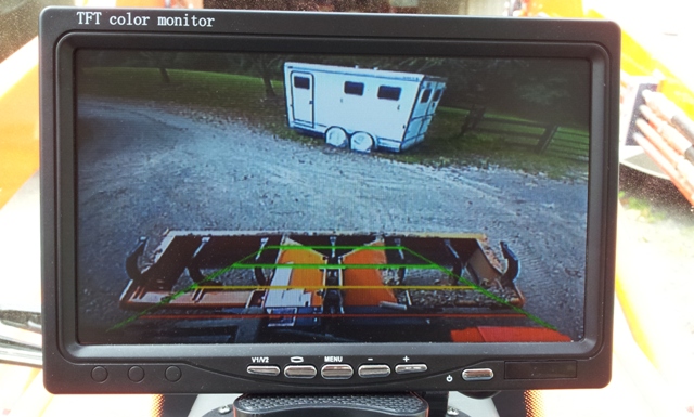

Here is a picture of mine from tonight. The old truck was about 25' away. I need to play with the settings on my monitor more.
I think threepoint gave you some good advice on trying another monitor. Also have you tried it with the engine off? The alternator could be making noise.

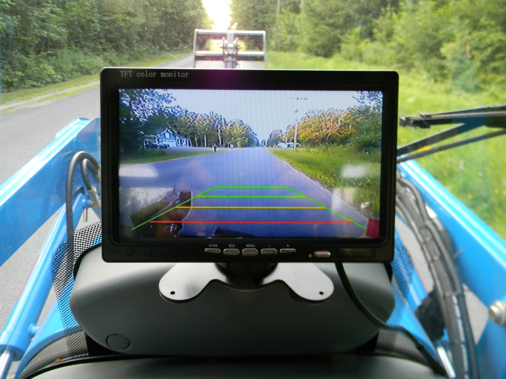

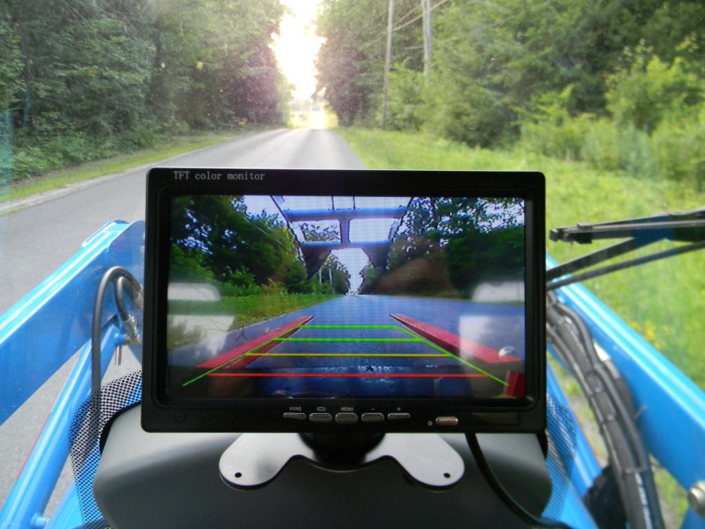

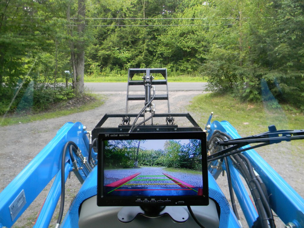

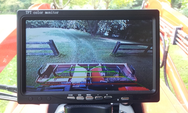

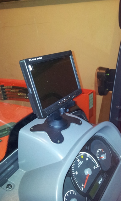

I've added three pics of my installed monitor to give folks an idea of the quality of the images I'm getting. Monitor and camera are the ones Roger linked to at the top of this thread.
The pics were taken with the tractor idling, with a cell-phone camera in bright sunlight (cabbed tractor). The implement under the guide lines is a box blade. The horse trailer in the second pic was about 25-30 feet away. The monitor is mounted to the dash/cowling with four small screws, using the mount that came with the monitor. I sandwiched the included neoprene pad between the dash and mount, but left the protective paper on the dash-side so as not to make it permanent. No idea how long a $28 monitor will last! BTW, vibration has surprisingly not been an issue at all for me, even at full throttle over rough terrain. YMMV.
