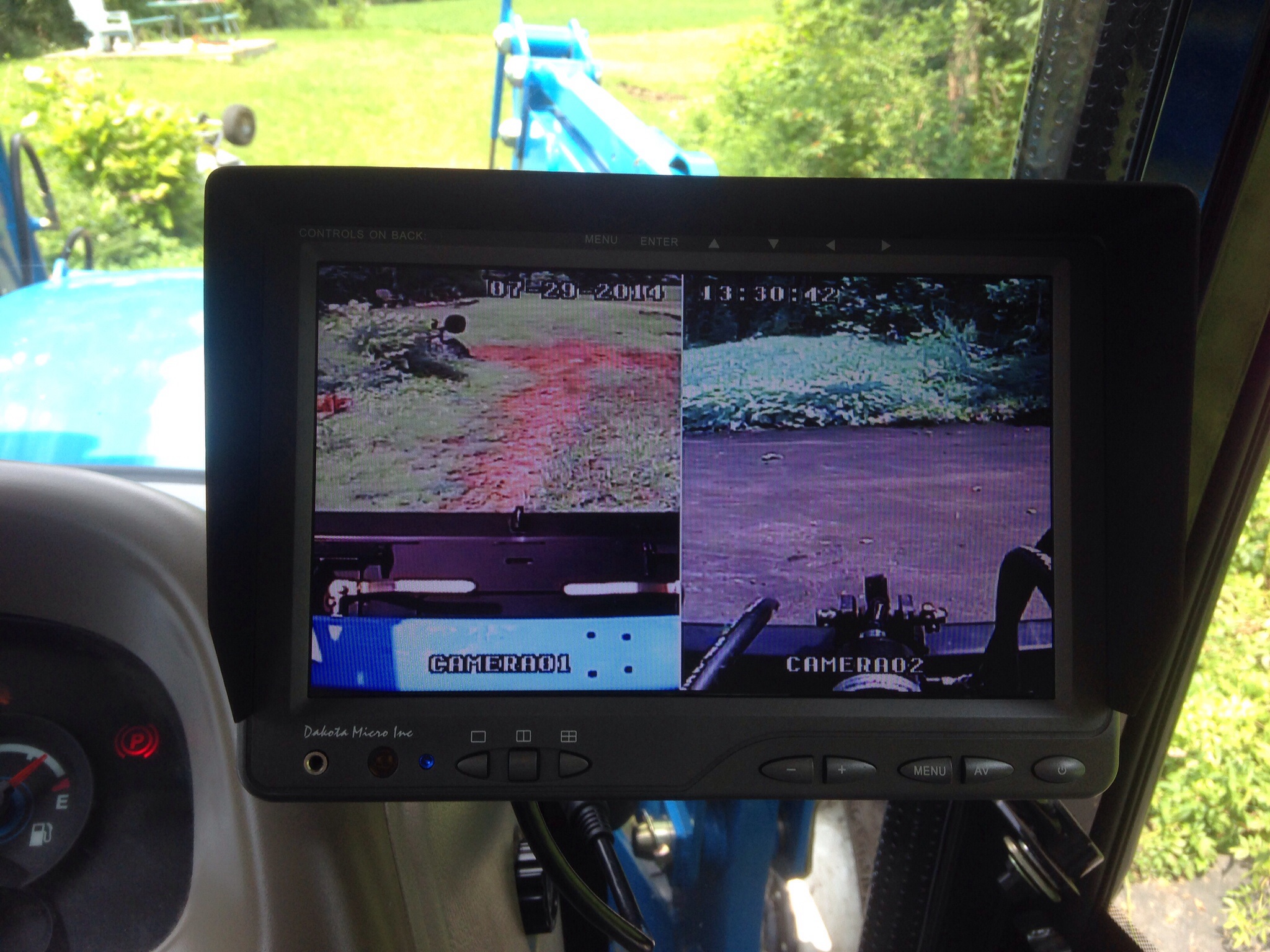

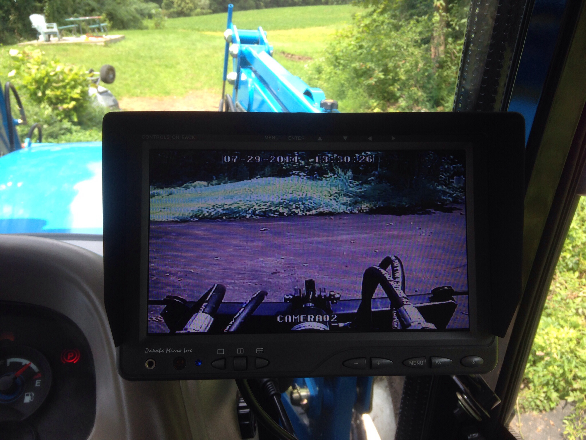

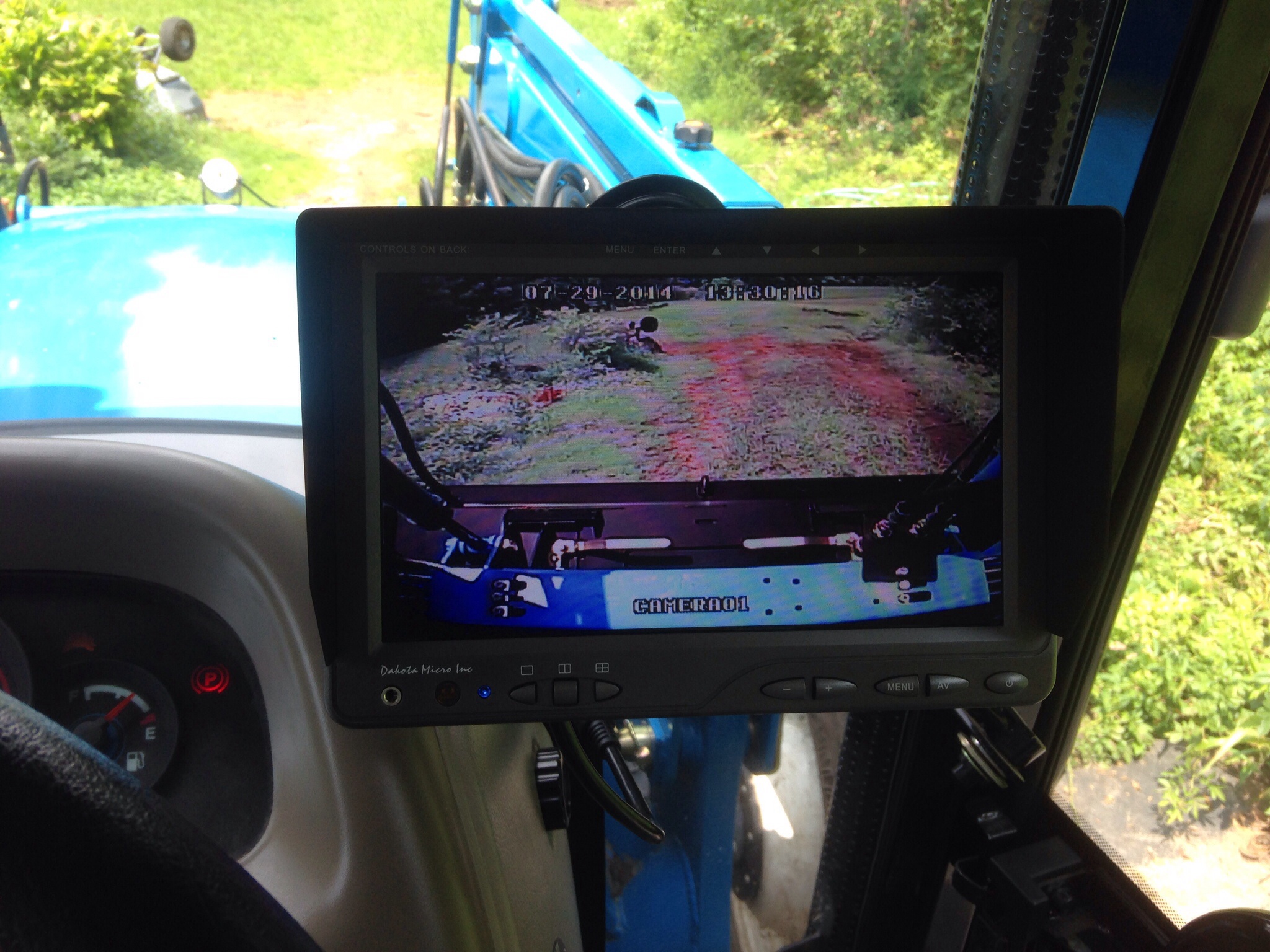

Anyone tried a camera for a home style security system , I was thinking about trying something like this one for up front on the loader due to all aluminum housing and the adjustable mounting base?
Amazon.com : R-Tech Outdoor/Indoor Security CCTV Bullet Camera DC 12V power 520 TVL Day/Night Vision with 24pcs IR LEDs 3.6mm fixed lens, Weather-Resistant and Vandal-Proof : Security Camera Pal N : Electronics
That is not a bad idea. The only problem with it I can see is it is bigger that a back up cam and it would be more susceptible to damage but it is only $15.
/ A backup camera for $50!!!!!!!!!!! #156
I did try a home security cam with the monitor. My monitor and cameras came from different places. I had the monitor installed 2 days before the cams arrived so tried a spare security cam very similar to the one in the link. I was not impressed with it. Don't know why but the little cams that Roger suggested had better resolution. Plus they are smaller and less chance of getting hit.
