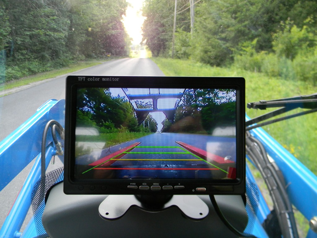

I snapped a pic yesterday of a screen shot from the rear cam.

/ A backup camera for $50!!!!!!!!!!! #178
Yeah I think I will , I'm hoping to get to try a few different mounting options for the front cam over the next few days.
