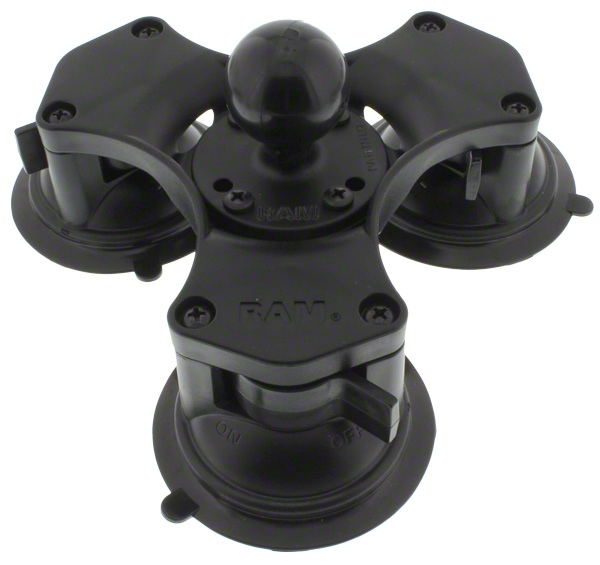

I went with a suction cup mount like Bullet's with a 7 inch monitor and it shakes too much with the tractor in motion. If you hard mount the monitor you shouldn't have a problem.
Last week I ordered up an AgCam with the 9" monitor and two cameras and a 3 suction mount from Ram. The Ram mount came yesterday and is very solid, no monitor shake but the mount alone cost $100.

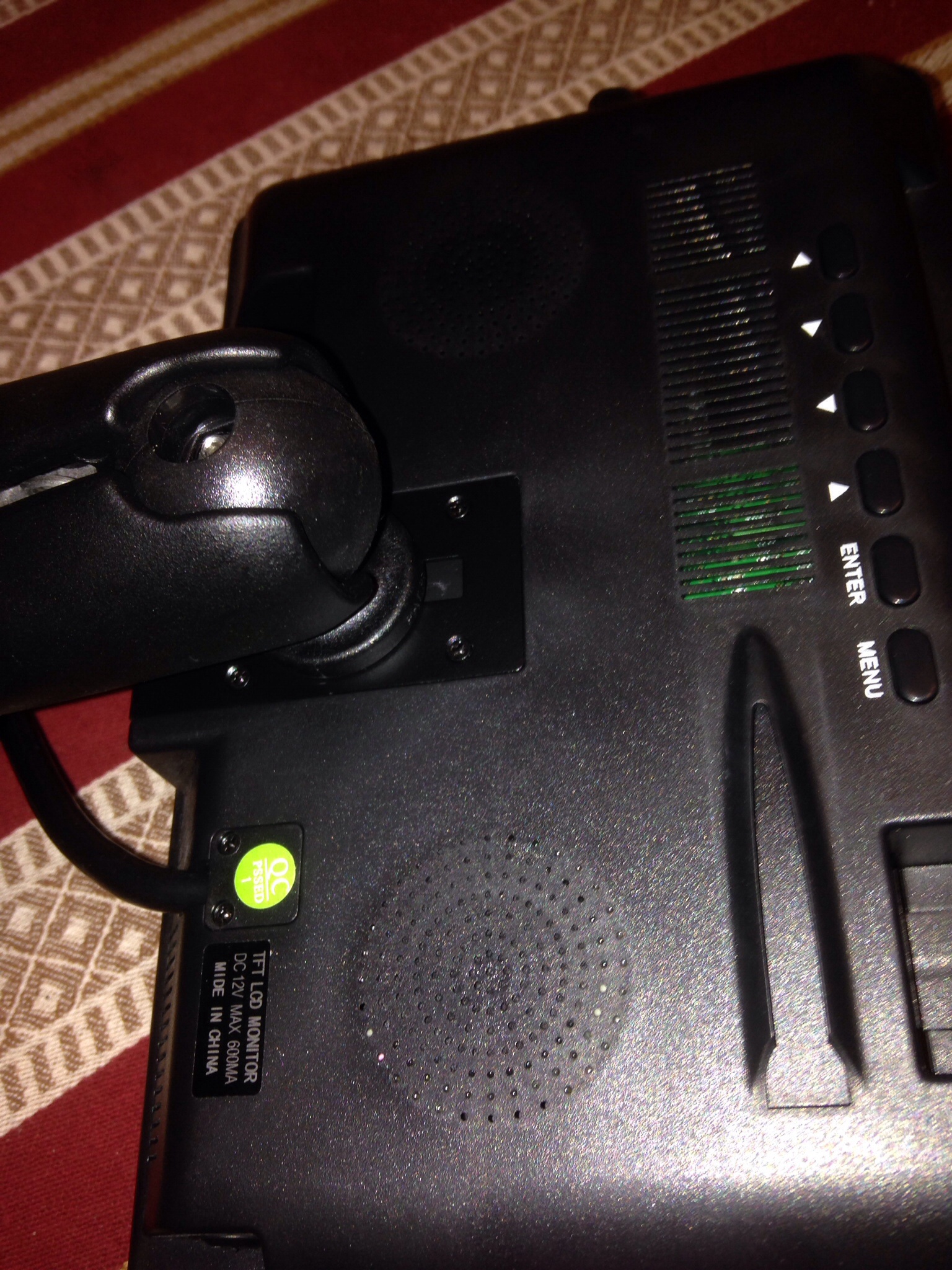

I'd like to pull the trigger on this for my skid steer. For this install I will need a rigid mount to a steel surface. I'd like to use a RAM mount, but how can I adapt the monitor to the RAM ball?
/ A backup camera for $50!!!!!!!!!!! #29
Ram mounts are about the best out there by far.
Ram makes a ball mount with 2 screw holes. Its a universal mount. What Id do is get some good double sided tape (3m trim mount tape) and stick it to the back of the monitor, then mount it wherever you want it.

^^^ Roger has an even better solution
/ A backup camera for $50!!!!!!!!!!! #33
I bought the AgCam Monitor and a Ram mount and there is a metal slot in the rear of the monitor. There is a T-bolt that gives you a couple inches of up and down adjustment to the monitor and it holds the monitor great.

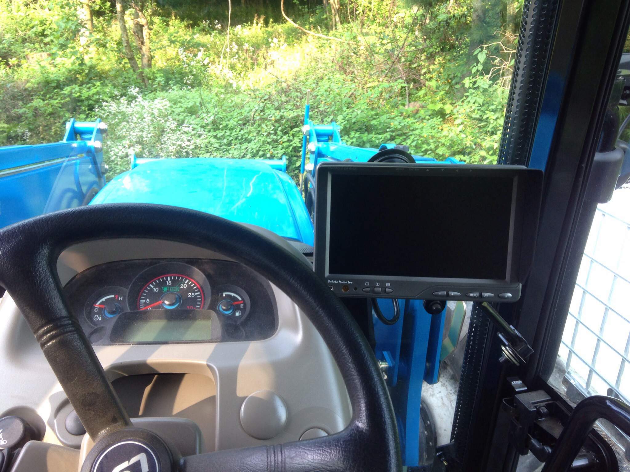

I have been using the tractor to clear and load brush. I have also moved a few trailers and it is nice to be able to watch the trailer on the monitor. I'm really liking the backup camera. So far I have not had any issues with the monitor shaking.
