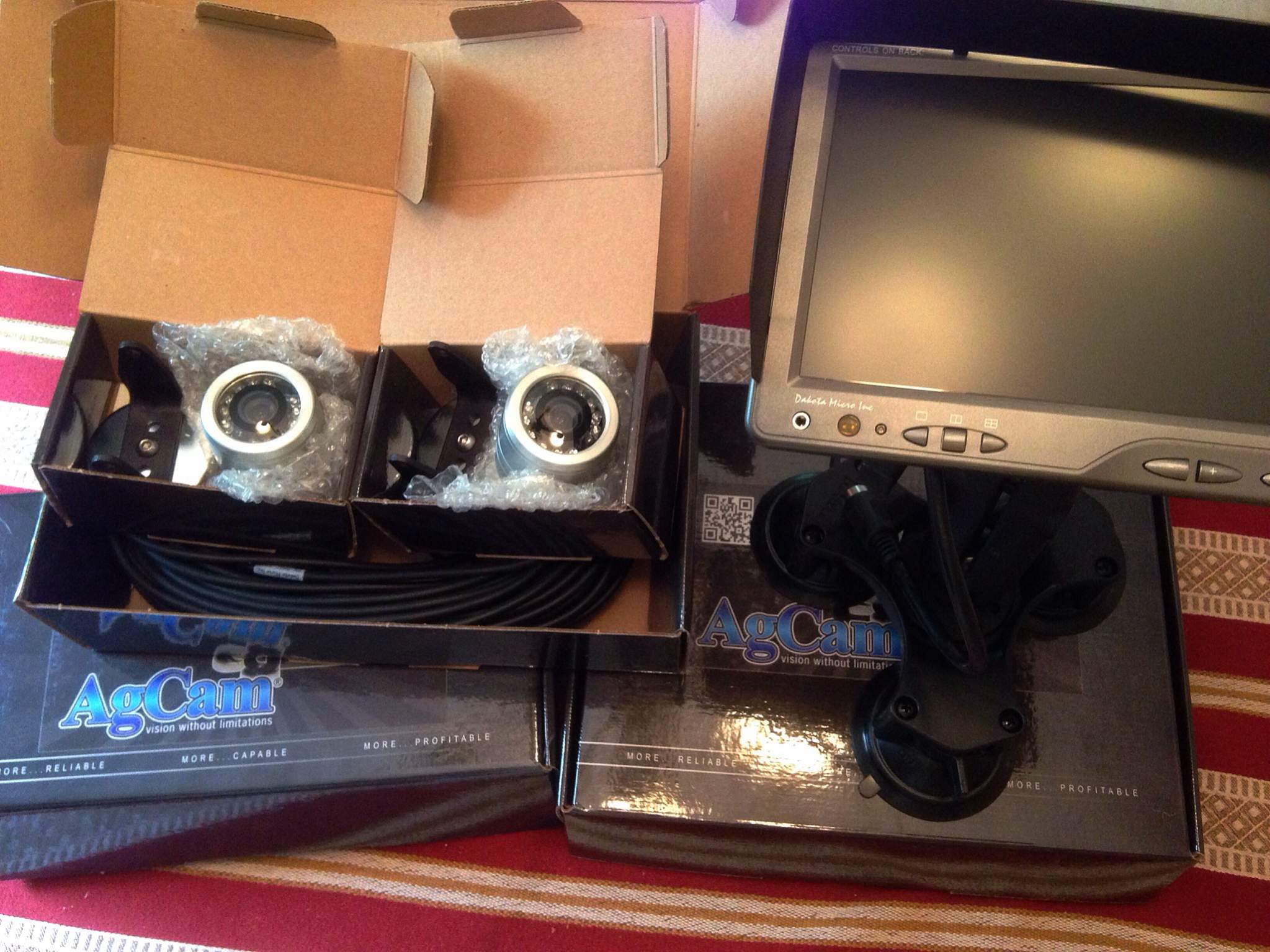

How is that $50 monitor in the sunlight? The one you see in my other post before this one is an Ag Cam 7 inch quad Monitor (meaning 4 cameras at once on the screen) for 500.00 with NO CAMERA I didn't like it and bought a better one. For about the same price. Direct sunlight readable and larger screen.
I have the Ag cam one in the previous picture like new in the box for 200.00 if anyone wants it. Check with Ag cam and see what they sell for. This one I have now has a much better picture.

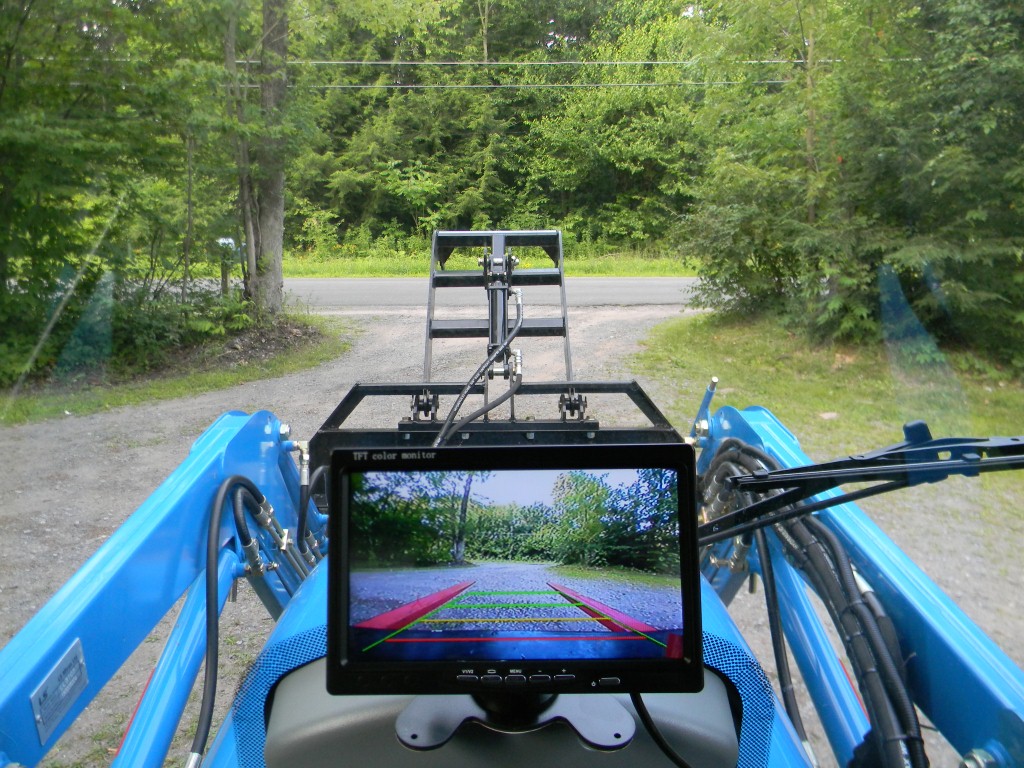

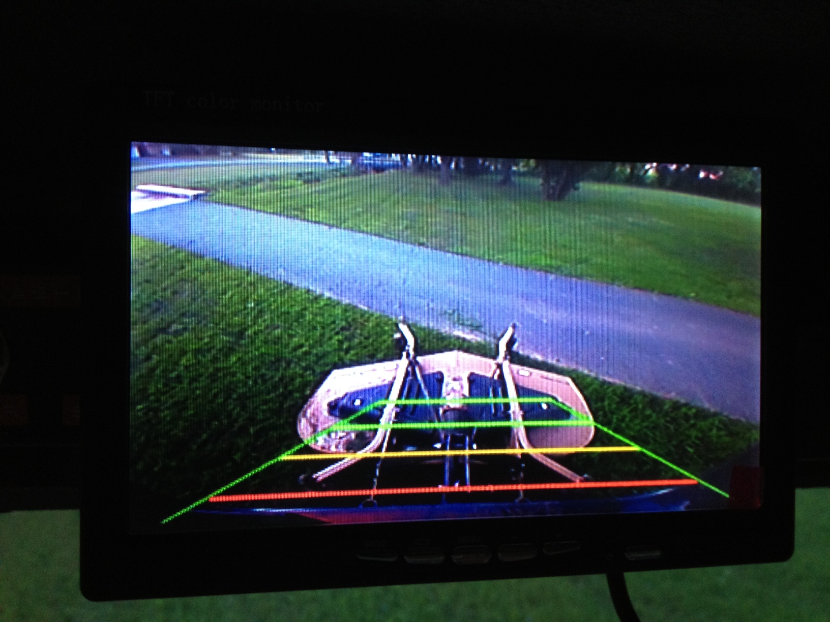

So far I have not had any problems with it in the sunlight.

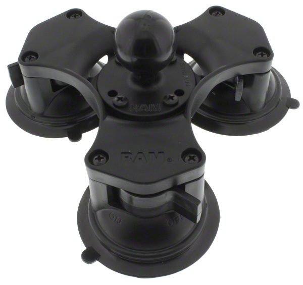

I think Roger spent $50 for the entire set up and his whole point of this thread was how inexpensive it could be done. I just bought an AgCam with two camera's and a 9" monitor for $699, plus another $100 on the Ram monitor mount. I also just ordered another Ram mount for one of the cameras to mount on the brush guard for about $60.
I can't see mounting one of these on an open station tractor, none of the monitors I have seen would work for long in the elements. I have only had mine a week but is anyone having problems with sun light washing out the screen?

Are you sure you bought AgCam 9" with two "AgCam" cameras for 699.00 because that setup goes for 1589.00?

I think 94BILLITT camera set up is the way to go for most people. For 50.00 and not have to permanently mount it, Is a plus.
One can see for very little money if they like and will use a monitor camera setup.
I think he did a very good job not even drilling a hole.
I'm embarrassed to say how much I have spent. My post is to show the contrast of what I had to spend verses what he spent for basically the same outcome.
I'm sure there is a trade off. But if you bought the 50.00 setup and wanted something better what did you loose, a trip to McDonalds for the family?
In the sunlight with all the glass in the cab the Agcam 7 inch was not that good. I even sent it back to Agcam, they sent me a brand new one with all the accessories . But the monitor was the same outcome. Washed out and lack of color compared to what I have now.
That is how I have a new one in the box with unused accessories. If someone wants it this it what it normally sells for.

Thanks for the kind words on my installation.
I was using the tractor some this evening. The sun was very strong. I had the back of the tractor facing the sun and there was not any glare, I even opened the back glass to let more light in and there was still not any glare. I then turned the left side of the tractor to toward the sun there was not any glare so I opened the door and there was not any glare. I do still have the screen protector on the screen. I am not sure if things will change once I take it off.
The picture on my monitor is not super clear. It is definitely not Mercedes quality but I would say it is good enough for a tractor. I need to hook up something else to the monitor and see how the picture is. I'm thinking the camera may be why I picture is not super clear. I can get a pretty good camera for under $100. All I wanted was something that I could glance down at and make sure that nobody or nothing was behind me when I went to back up.

Well Roger, Thanks for posting this info. I got mine installed today. I used 2 cameras (1 front because I can't see the tips of my forks from inside the cab and 1 rear). Here's some pics of mine.

My camera and monitor arrived today. It was only a few days ago that I placed the order. Installation was quick and easy and it works fine. I only began mowing at 8:00 this evening, but there was a good 45 minutes of decent light. When it got dark and I kicked the LED's on the picture had a little washout because of the bright lights. Here's a pic with normal but fading daylight. I already managed to use the camera to back the deck in between the mailbox post and an adjacent utility pole.
/ A backup camera for $50!!!!!!!!!!! #59
Picture looks good chim, very acceptable.
I'm glad you guys are finally seeing the value of a backup camera. Thanks to BUILLTT showing there is another way with this thread. A low cost way, Still hard to believe the 28.00 price of that monitor. If you have a cab you're missing out if you don have a camera.
Are those lines adjustable? I see they taper is there a way to adjust them?
I have an older backup camera not made anymore and not the best quality for this day and time,but one thing I like and why I bought it for my b3030 back in 2008 It's a 2002 camera and I found it again on ebay for my 3240 last year. What I like about it is the ability to adjust the lines to the width of my tires and project the lines out eight feet, blue line 8ft, yellow 6ft, red line 2ft. but you can adjust anyway you want. There is a chart you layout behind the tractor to adjust the lines. Or you can just mark out the distance.
When the line is the width of the tires it gives you a look of where your tires will be between two poles or something. As shown in this video the width of my cut in the snow you can also see it your going off track.
I gave up a little bit of quality on the camera but I really like the use of the lines. The rear camera also has 4 adjustable views, One looks just straight down to your tires as if your hooking up an implement, other, a wide angle without lines and the view you see here with and without the lines.
I made a video this past winter to show the value of using the backup camera versus your mirrors when your in the snow and rain.
Its best to watch in FULL screen. at 1080p
The claw! The claw knows all and chooses who will stay and who will go!
384072d1406333291-backup-camera-50-a-dscn1315-medium-jpg
I could not resist your grapple cam. :)
