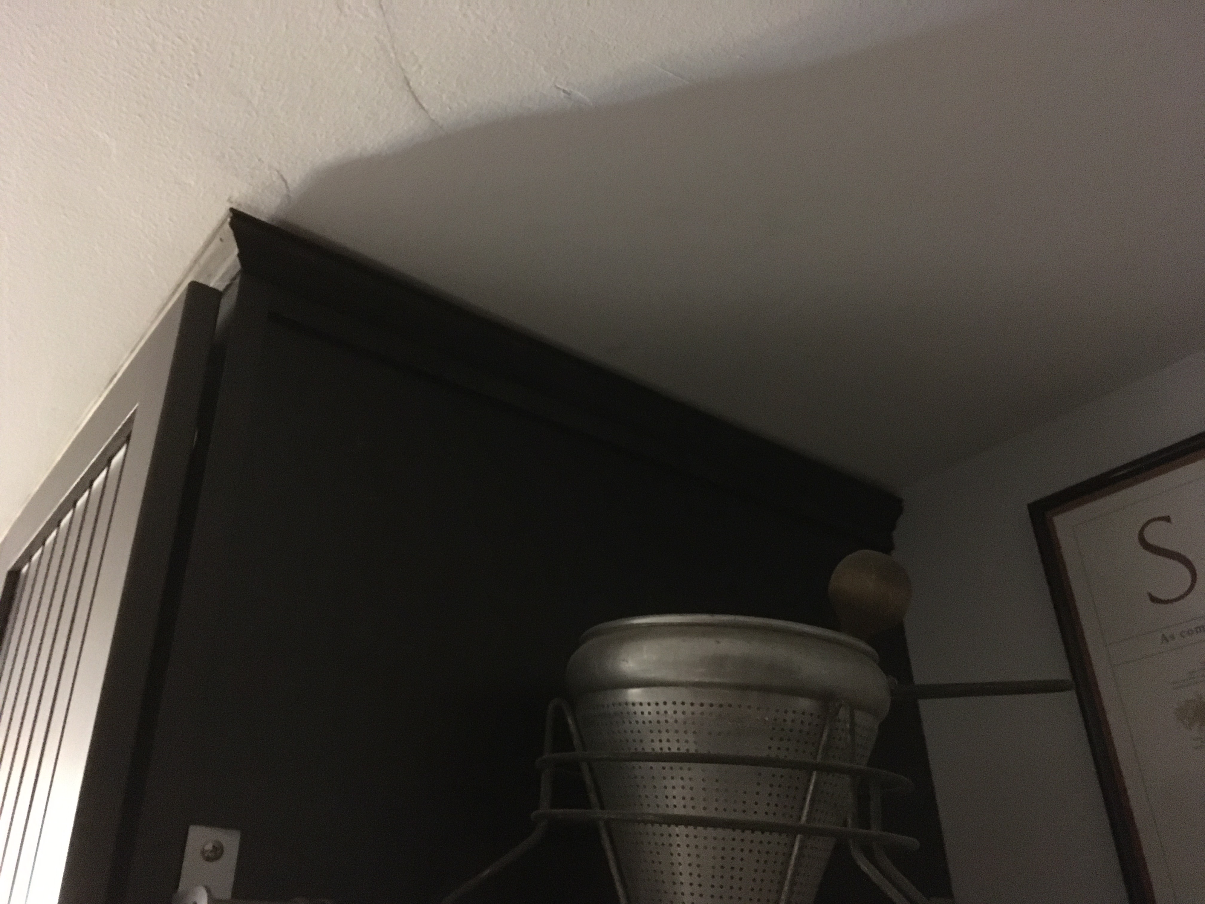

/ 96 Pantry and 8 Ceiling #2
Are you going to put trim or crown up after? That's what I did on my pantry cabinet and oven cabinet. Also, my floors and ceiling were not perfectly level, I ended up finding one spot in the room that gave me an extra inch to tilt them up so I had to trim less. Swung the tap measure from the bottom front corner and trimmed the back.
Sorry about poor lighting but you get the idea.
I wouldn't bother with the hand truck, just more chances to "ding" the cabinet. I would "walk" it over, tilt one side onto the base and push it in.
