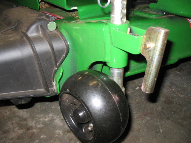

I think the best and easiest thing to do in this case is to cut the front anti-scalp wheels off. Brackets and all. Then order an anti-scalp wheel kit from John deere that bolts onto their GS75 54" walk behind mowers. We purchased this kit years ago for our machine. The wheels are height adjustable, with a wrench. They have grease fittings on them. The wheels are heavy-duty and very rounded. If i remember, we had to drill a couple of holes for them. If anyone is intersted, I will take a pic.

Papaw, Just sent the pics!

Fella's , I could fix this problem in 30 min.
from the pictures that have been posted. the wheel is rideing right under the pin it is suppose to swivel on. and thats not going to work very well at all.
it is going to drag when you turn, instead of swiveling like it should. it needs to be set up like a caster on a grocery cart. the wheel needs to be offset of the swivel point. All that needs to be done. is have the pin cut off the wheel bracket. and slid to one side and reweld it. if there is not enough room. add a 2 inch peace of 1/4 flat band on one side and reweld the pin to it. and it will never dig your yard again. it needs about at least 2 to 3 inches off center. it needs to look like the wheels on the front of a 0 turn mover like a ZTrack. the wheel need to be offset of the piviot point.
I know i use to repair these wheels on tractor mowers for years.
this was just a design mistake. but its a simple fix...:)
/ 62D MMM Creating Divots with Front Wheels #69
I just saw a better picture. it is offset a tad. but no where near enough. it needs more to work right. Three inch offset. and it will never hurt your yard. trust me...;)

When you get it, check to see if the front wheels on the mower are rounded or still have the squared edges. This will be your first clue if anything has changed. JC

I don't have a part number for the wheels. I just kept telling my dealer how unhappy I was with the mower. Finally they did a dtac on my tractor and Deere sent me the wheels. They have bearings just are not drilled for the zerk fitting. I installed zerks on the shaft and that makes the wheel swivel much better. Supposedly Deere has done this for others, but not me. JC

This might not help the situation but my 62 MMM does have offset wheels. Is this the new model or something. I purchased it in January. I dont have the divit problem described in this thread, although I do find it a knuckle busting experience getting front bracket to attach to 2520 tractor. IS there a fix for this problem?
/ 62D MMM Creating Divots with Front Wheels #75
Your mower is just like mine. If your lawn is flat you will not have the divot problem. My lawn is not flat.
