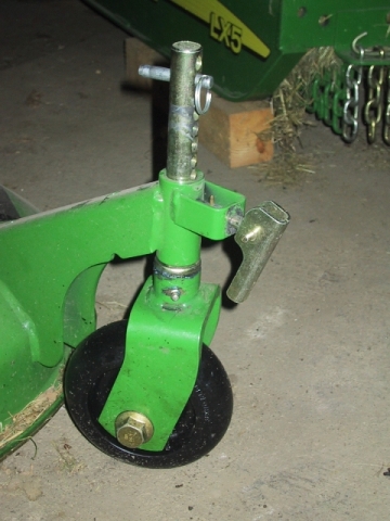

This photo is similar to my deck, but my deck has both front wheels like the one on the RIGHT side of the deck...which has a spring mechanism to realign the front wheels...You might check with JD to see if they can get you something similar...

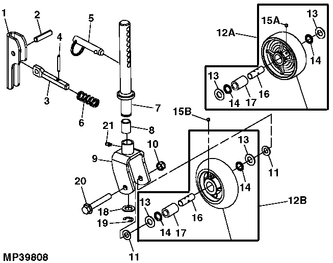

You could refer them to the parts diagram on the JD web site for the 62D mower deck. It shows two different wheel assemblies for the front of the 62D. I would think that would be enough for them to know there was a change. Sorry, I don't know the Dtach number, but I half remember seeing one mentioned somewhere in this thread (or one of the others on this topic).
When I ordered my deck, I specifically mentioned the two different types of wheels and showed the salesman the parts diagram, and it came in with the new wheels on the front.
Since then (December 07), I have heard of others getting new decks with the updated wheels on all four corners. On the other hand, I'm also still seeing 62D's with the old style wheels on all four corners at the dealers.
/ 62D MMM Creating Divots with Front Wheels #112
Here's the parts diagram:

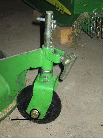

The new ones have rounded shoulders, look like donuts.
I've searched several of the threads pertaining to the 62D wheel issue and can't find anything specific to a Dtach number or other reference number from JD. Unless there is something specific from JD, my dealer doesn't feel like they should switch the wheels out as a warranty issue. If anyone has a reference number on their wheel replacement invoice or knows of another way to convince my dealer that is SHOULD be a warranty issue, please let me know.
Thanks.
