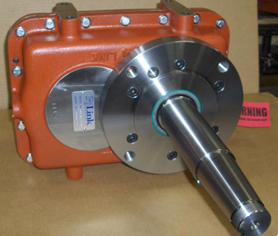

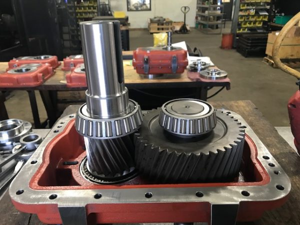

RJ Link in Rockford, IL has been making gear boxes for Ag for over 30+ years. From small machines up to the big boys.
540 gear box sped up to 1,000 from any of these.
Speed Increasers – RJ Link International, Inc.
They can even put the gear box on your implements too.
Agricultural PTO Gearboxes – RJ Link International, Inc.
They can even reverse the direction or keep it the same,

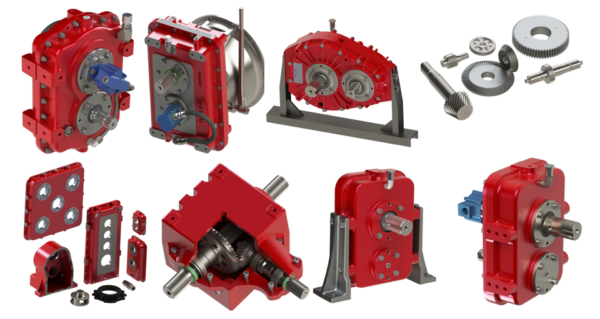

Rj Link International Inc is the go-to solution provider for custom gearboxes. With an innovative team of engineers, sales and support staff, you can look to Rj Link International for complete design to specifications, manufacture to prints or customization of existing proprietary design.
more examples,
PLUS, tell them the Ag color you need and they will match it to your machine !
Speed increase unit example,

The C-pad pump face in the one image is a female spline.
Yes, these can be made for parallel direction output. So no matter what direction the PTO spins, it will run in the same direction at the same speed, reduced, or increased.
Contacting RJ Link would be the best to determine what options are there for you to use.
You are 100% correct on some of the machines out there with the PTO spline output being so high up.
Also, these can mount on the implemets. I once looked at a 8Hp wood chipper with a bad engine. Taking the engine off, using an RJ Link to allow the increase of 540 to 1,008 would then make the chipper work on a tractor.
