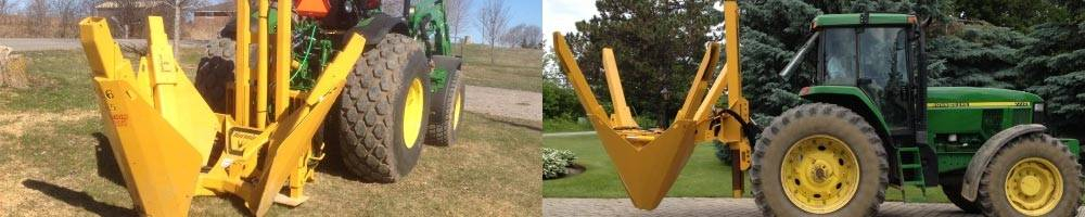

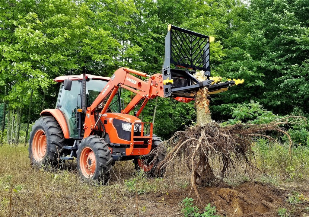

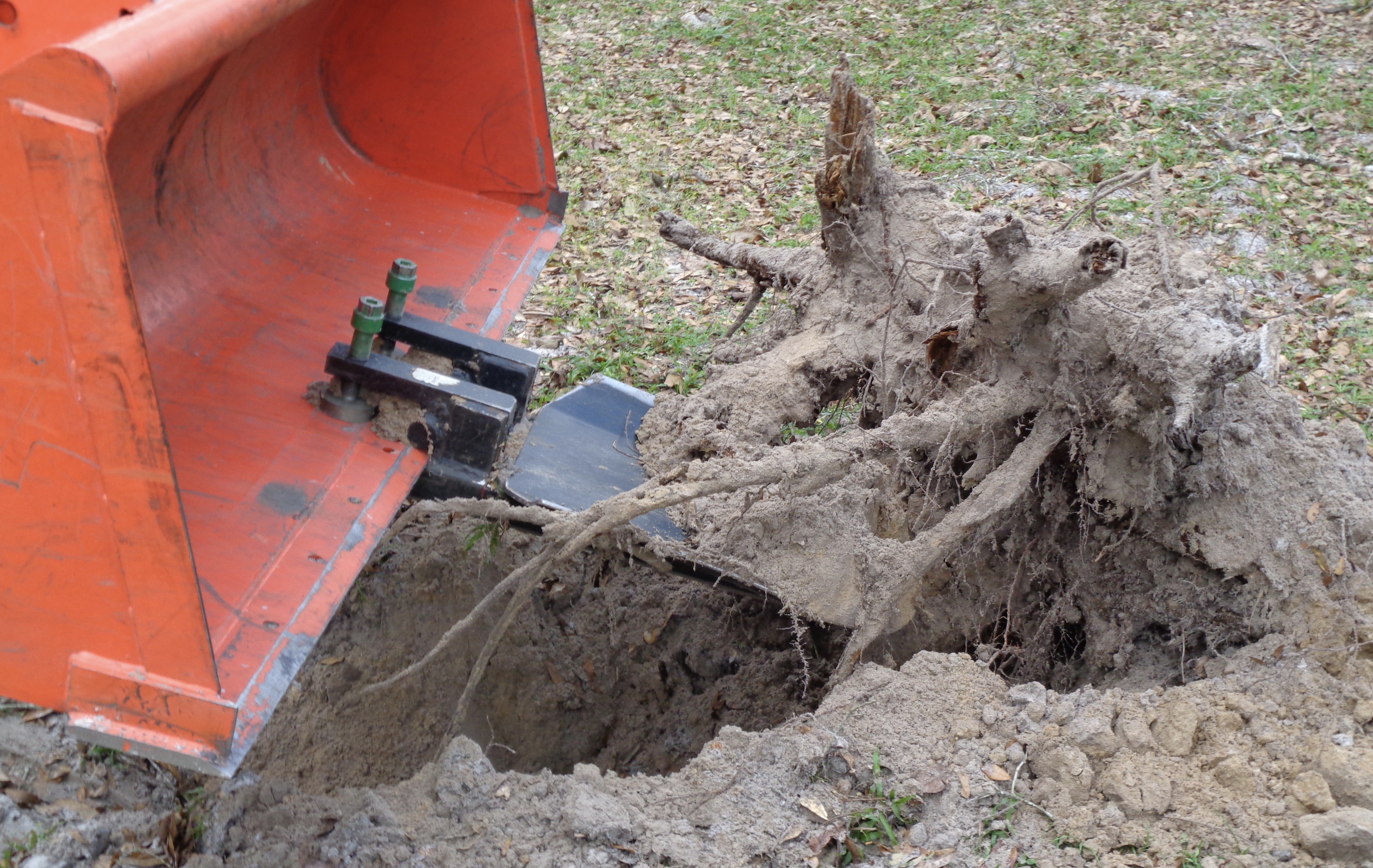

Forestry related equipment - We have 14-15 acres of Loblolly Pines that can be harvested for timber. We need to thin scrub and deadfall between the trees.
I use a 5' heavy duty Rotary Cutter weighing a bit over 1,000 pounds with a Category 4 drive line. $4,000 The scrub and deadfall shreds into mulch. Pointless to handle or transport scrub or deadfall. Chop it.

Post hole digger - not sure if rent or own, but we need to fence at least 1/2 the property and it may be a good option for planting new trees. (we will be planting some fruit/nut trees in one area and will likely start a very small Christmas tree 'farm' in another)
Forestry related equipment Not sure what else we will need (shears/chipper/puller?), we have 14-15 acres of just trees, mostly loblolly pines that can be harvested for timber. We need to thin the trees of scrub and such and remove deadfall and low branches. We MAY decide to harvest pine straw as well. I thought about baling hay in my open areas, but that may be cost prohibitive. Ultimately, we are not trying to turn a profit, just defray the cost of our equipment and give back to the community (the Christmas trees will be a donation thing).
