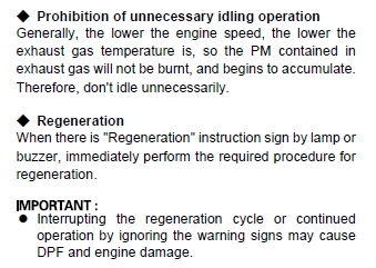

If you have a new tractor you need to read your owner's manual! They have a whole section in there about regeneration...and if you don't follow the instructions, you are asking for problems, expensive problems, in the future.
Here's a couple screen shots from the owner's manual for my 2016 M7060 which will address some of your questions. Since you say you run your tractor at or just above idle a lot, pay attention to what Kubota says about that.
So the next time you see that "sideways shower" symbol, turn up the rpm and let the regen process take place. If you don't, as one of the posters said above, you'll have to call your dealer to do a forced regeneration.
After getting used to my old John Deere diesel where engine rpm didn't make any difference it took me a while to get used to having to run the Kubota at high rpms all the time. But once I got used to it and religiously followed the engine operating instructions in my owner's manual, I've had no problems. Been mowing the past 3 days and yesterday that "sideways shower" regen symbol came on. Seven minutes later it went off and the regen process was done. It's not a problem - nothing you have to do except make sure the rpms are up there - the regen process is completely automatic as long as engine rpms are high enough.

If you let a Tier IV tractor idle all the time it loads up the DPF quickly. No way will it go 25 hours before the regen light comes on. When I first got my Kubota and let it idle a lot the regen light would come on in less than 10 hours. And the regen process does not last half an hour - mine has always taken less than 15 minutes. Most times less than 10. Work the engine hard, so the exhaust system is really hot, and regeneration cycles will be 50 hours or more apart.
You have no control on when and for how long the regeneration process takes place. The tractor will sense when regen is needed, and it will last until the sensor tells the system that the DPF is clean. There is a process outlined in the owner's manual for a "Parked Regeneration" that you can initiate but that's used after something went not according to plan. So if the OP turned his tractor off after the regen light came on, he may have to go through the Parked Regeneration process to clear the DPF. See the manual's warning about interrupting regeneration in my post above.
