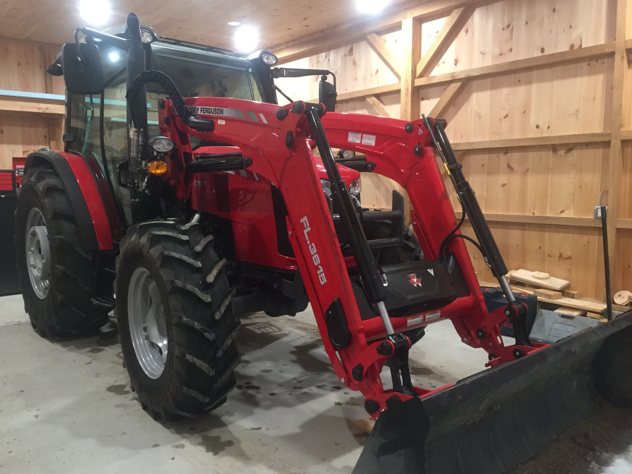

Couple pics of the 4707, because everybody likes pics:
   / 4707 #466
It looks nice and warm inside your barn. How many hours are on it?
