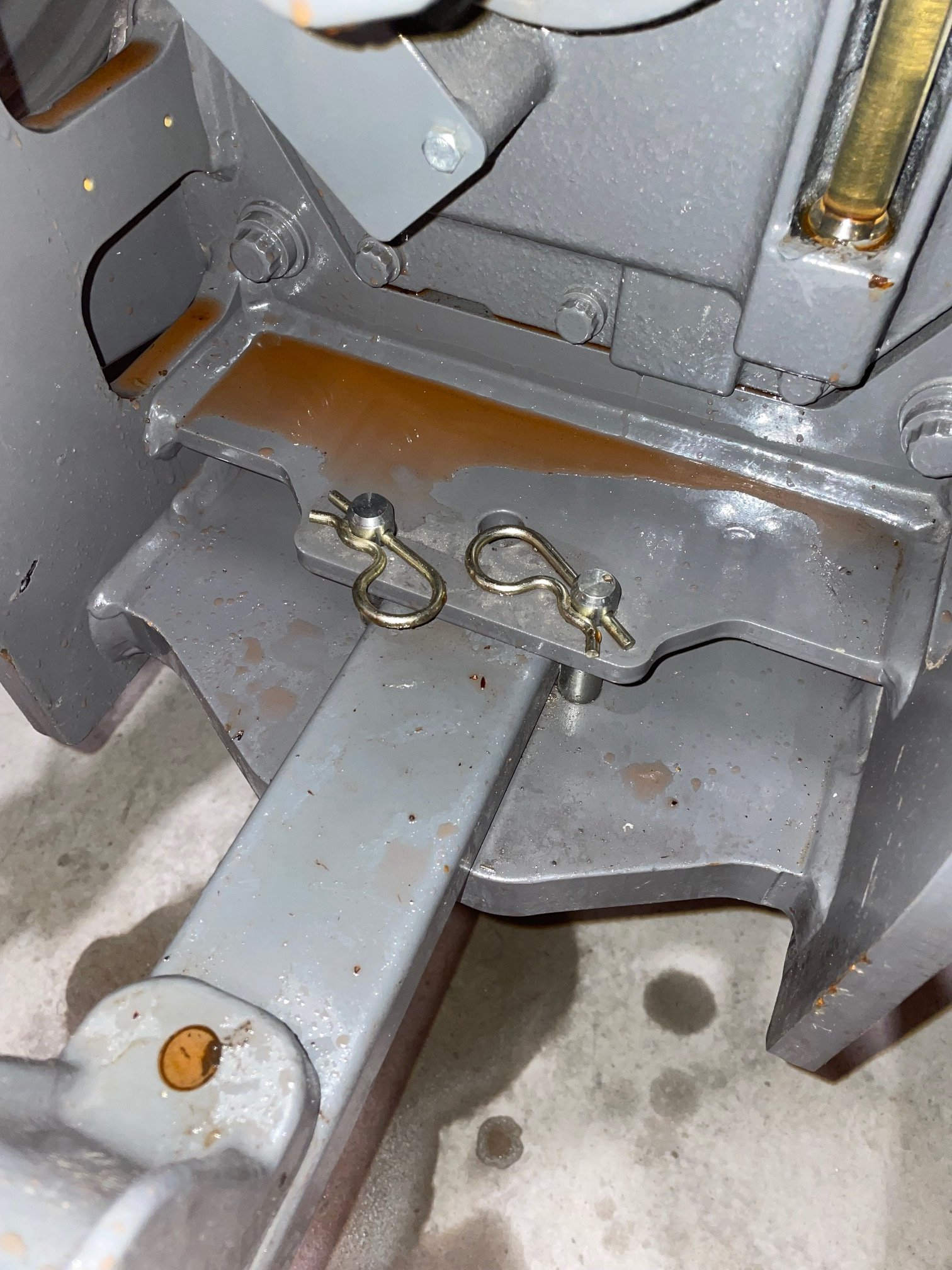

OK, might be another issue popping up. Over the course of the last few weeks, I've noticed a dark spot under the tractor (by the rear end, under the cab). Didn't think much of it because it was very minor and I thought it was water dripping off the machine. Nope. In my preparation for this storm, I noticed most of the back of the tractor was covered in a reddish fluid, like something was leaking and spraying the back of the tractor. The trans-hydraulic fluid isn't red (more of a clear yellow?), so what could it be?

Went out to the garage and looked more closely at everything. It's not fuel, it appears to be coolant. Why would the back of the tractor be sprayed with coolant? Also, the coolant reservoir is quite low, further suggesting it's a coolant leak.

Cab heater line leaking?

That should be easier then finding a fuel leak.
A caution with that color anti freeze be carefull what you mix with it.
If you don't find your leak at a hose connection loosen your fan belt and check the fan for water pump bearing issues.
