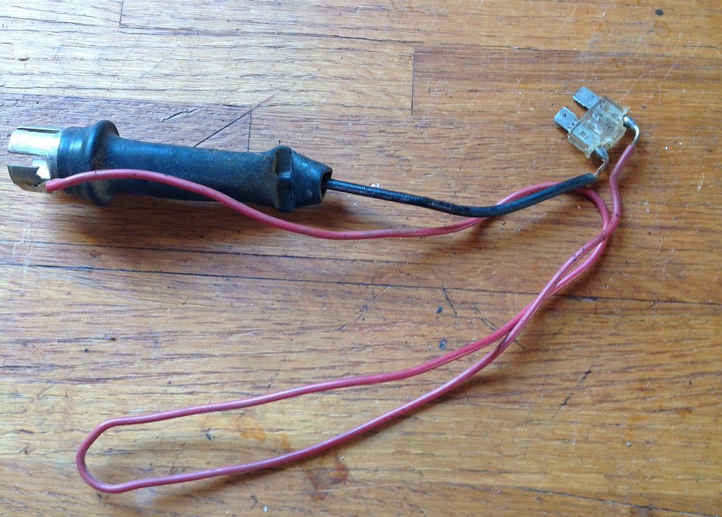

Put a 12v lightbulb in place of the fuse (rig with soldered wires to old fuse is what I do) and it will light up when there is a short. Lets you play with the wires to find the problem, without destroying more fuses.

Works great for me, and once helped me find a short in a wire that was above the headliner in my Chev Citation. New car and several trips to the dealer to no avail led me to chase it down on my own. Plug it in and started moving wires around until "poof" the light went out.. never would have imagined to look for a wire above the headliner that had a very small piece of insulation torn.
It is crude looking, but works.. here is a pic.
Yours is a work of art compared to mine. :). I tried hooking it up and wiggling wires but so far Nada.
