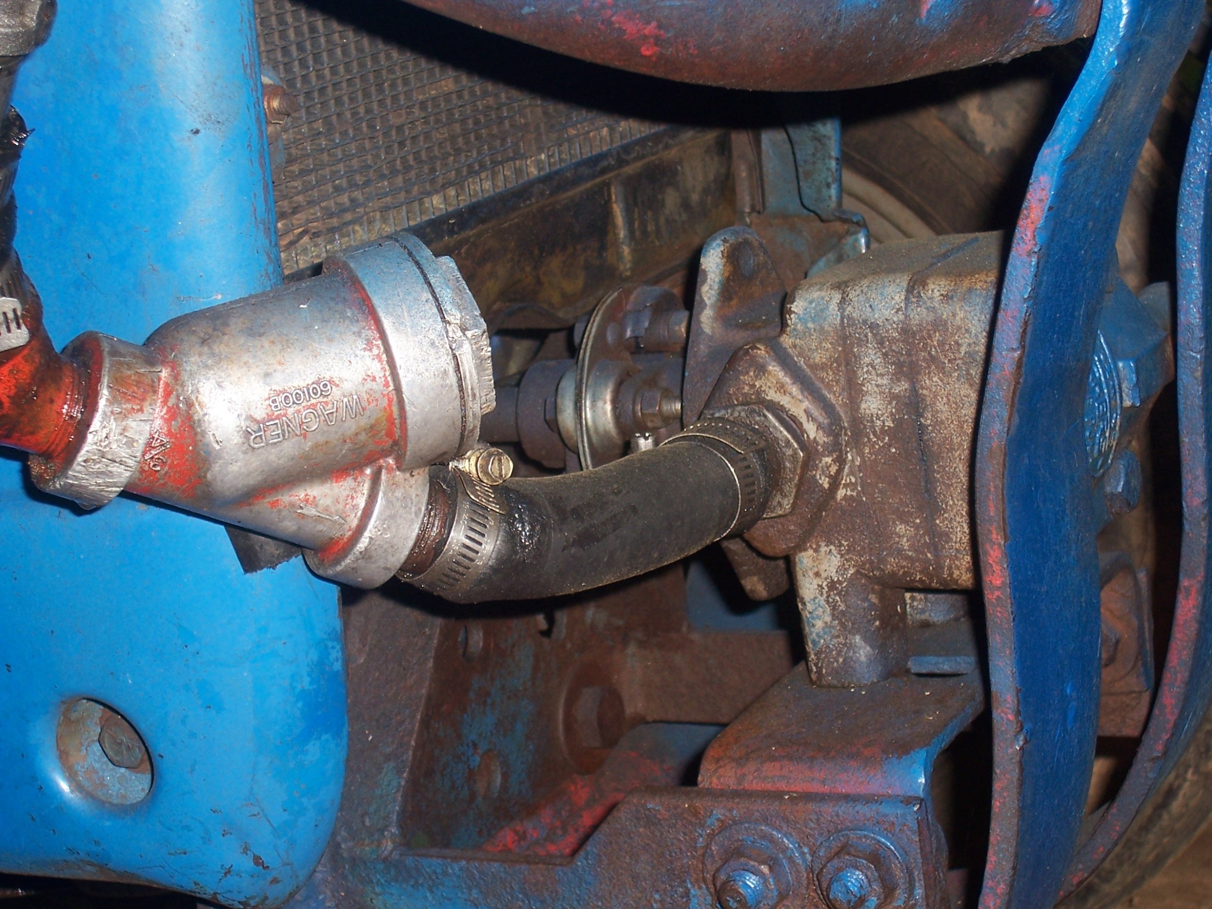

The FEL on my Ford is a basket type filter to catch dirt and Debris. I had a Hose swell at a bend on the inside of it. Done the exact same thing small Squeal and hoses would show movement. I just Serv. it. New fluid. Cleaned the stainer basket and when I started it back up made it worse!
It didn't really squeal much but the hoses did fibrate. Pulled it back down. lucky I found the problem! Looked inside the hoses and seen it about pinched off. Replaced that section and it's been smooth and operating AIS..
The tractor was NTM and just had it split for a clutch replacement. The shop mentioned they thought something didn't sound right with the FEL.. The man knew his Tractors! Local and been in business for decades. Why I Serv. it.
Decades ago NTM. Yanmar and it does has a 3Pt. Valve on it you can close and lock it. I forgot and didn't open it and it Squealed Super loud. Lift handle raising it. After that I use Jack stands on the 3Pt. implements. The Hyd. 3Pt. lock is the round knob just under the seat.
