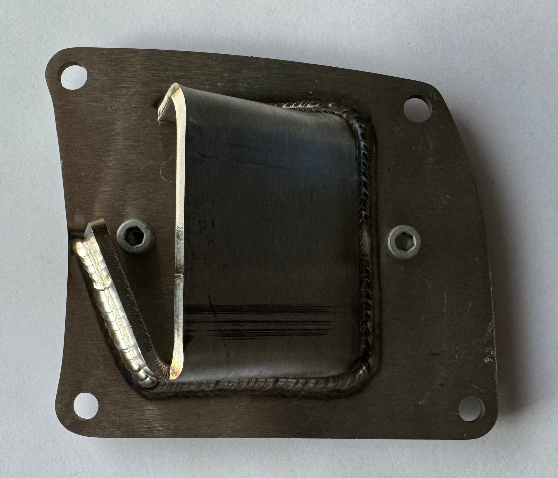

500i and 261 just do muffler mods IMO. The 500i just a cover like a straight shot. But you will need your hearing protection.
They are fing loud but the gains are there even over a muffler mod. By just putting the cover on and it adjust to it.

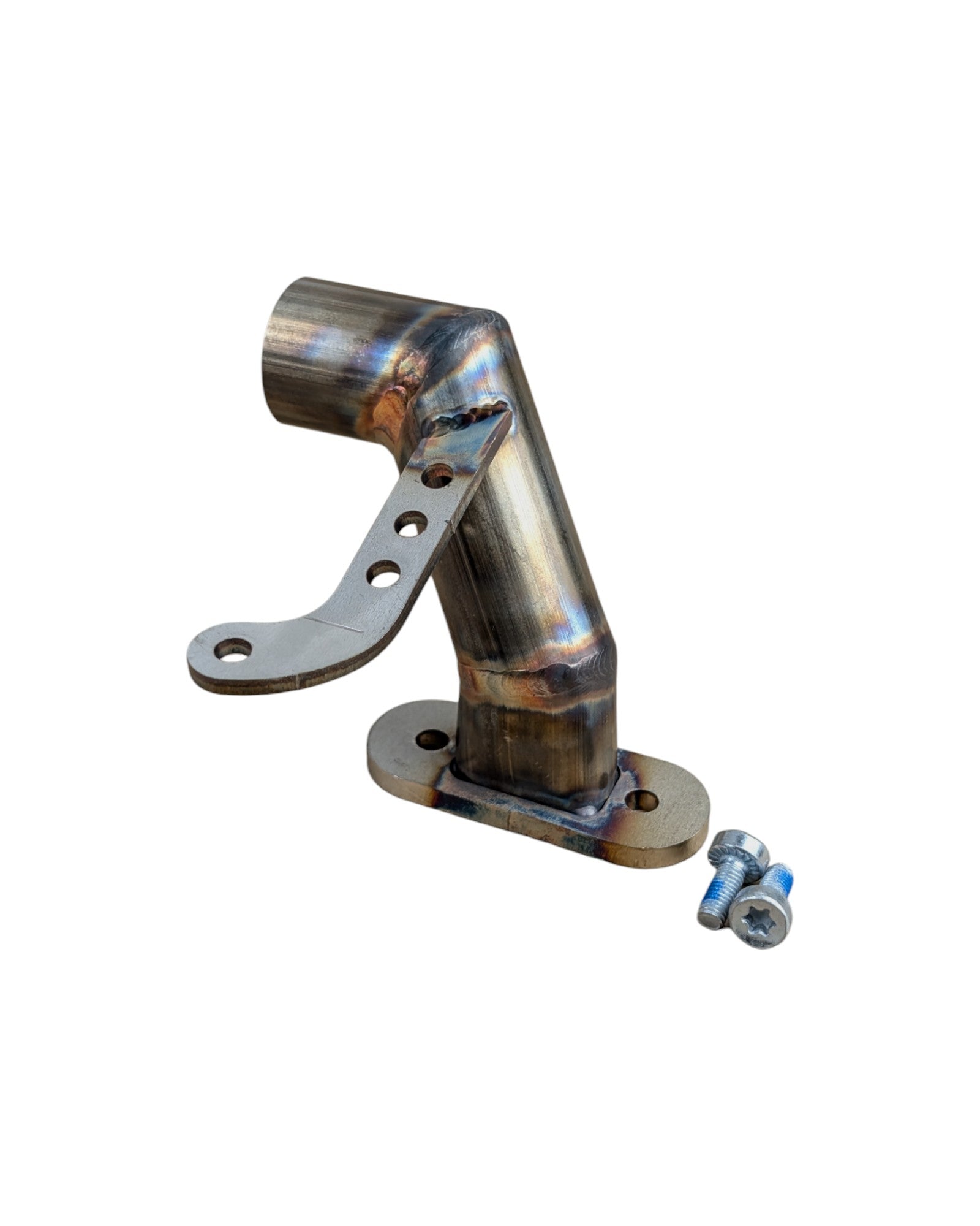

261 you could just gill it, hole with deflector, or tube pipe in oem muffler.
If you have the newest with M3 you could even run a Egan pipe. M1 M2 wont flow enough to keep up with pipe.

The SS is freaking loud. But the gains are there.
I was standing timing guys at Sawfest and all of them running them on their stihl's 400 462 500 etc etc.
They will wake the dead.
