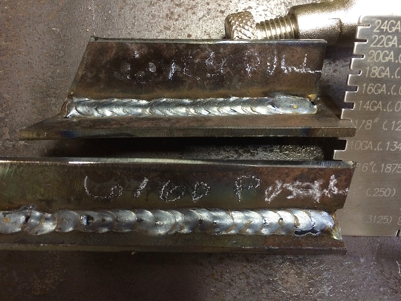

Watertight is no problem, it's a pretty quick pulse, about as quick as you can work that trigger finger. I have never quantified it but guessing from memory it's about 2/3 on, 1/3 off.
Why watertight, does it hold liquid? Or just to exclude water so it doesn't leak rust stains or fill with ice? You can do that with paint if the weld is decent.
This pic is 1" x 1" x .065" (=16ga) pulsed with .030 wire. You can make it a little tighter with .023 wire. I think you'll pick it up pretty fast.

Sodo... thanks for the pulse idea. Played with that tonight and I am happy with the results. Used the 'inside the cover' settings and the pulse seemed much more forgiving than continuous on 16 gauge. Here are a few pics. Even with the pulsing, the second pic seems to suggest that I still got decent penetration. The third pic was pulsing a flat butt weld.

I'm no expert, but it looks to me like your trigger pulseing has allowed a lot of contaminates into your weld. Looking at every overlap, you can easily see little pools of silica. To me this suggest porosity. Pretty beads and penetration dont mean squat if the weld is full of worm holes. I would like to see that weld sliced down the middle with a bandsaw just to see if it is indeed full of hole, and it might not be, but then again it might be also. I think instead of pulsing the trigger, you pick up the travel speed.
/ 120-Volt Mig welder. #172
Silica shows up even without pulsing. But when youse pulse, it shows up at every ripple.

Try to weld through the corners without stopping. A continuous weld bead will help make it water tight and will strengthen the corner. That corner among other things is weakened by the method of the start and stop. If you can't do a continuous weld through the corner; then tie the beads in together and it will work better for you.

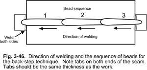

I'm also in favor of continuous beads vs tack-tack-tack.
Although I do use that method on occasion for rusty sheet metal repair and thin auto-body type repair.
Excellent fit-ups will largely eliminate the need for tack-tack method.
But if not, I'd recommend back-stepping short 1" beads or so. That way it ties into the prior bead quite nicely.
(ignore the run-on and run-off tabs in the photo since your are welding tubing)
