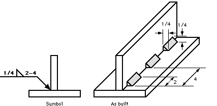

In my experiences a "stitch weld" is like this.
It's a very normal style of welding.
But the "triggering" that's being shown is just overlapping tack welds - as I noted earlier, I only use them for thin rusty stuff or maybe car sheet metal repair. For normal welding I do not use this repeated tacking method.

Stitch welding
What is stitch welding? definition and meaning
That's the def. I grew up with, but I've also seen roll seamers use that term... Steve
Not saying its factual or not. Just stating what it is called by everyone I have worked with. Which are NOT pro welders, rather multi-craft maintenance.
By the diefinition listed "a series of short, equally spaced welds", then that "triggering" or "overlapping of tacks" is indeed a stitch weld.
Short....Check
Equally spaced.....check
:thumbsup:
