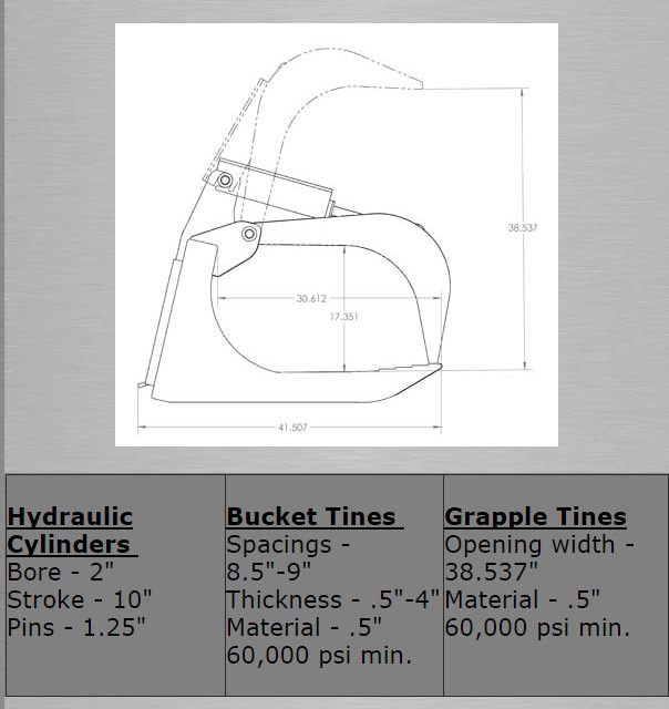

For your stated main use being logs and tops I would stay away from the flat bottomed grapple that you linked to. Look at the dimensions of the above grapple and the logs you are wanting to carry will just flop around in the jaws. I've owned both styles and IMHO you would be better served getting a grapple the will hold your logs firmly.
It's harder to pick up single logs with the flat bottom grapple and harder to place on a trailer etc when they roll around in the jaws. Look at a 60-66" of this style: RBG

I should have mentioned that I previously had a swept bottom single lid made my Millonzi. I usually grab several logs at a time so not too concerned about it rolling around. It also will be used for rocks, which the root rake type aren't the best at. I'm mostly concerned about the weight. I believe my tractor is rated to around 2600lbs at the pins, is a 900lbs grapple gonna make me wish for a lighter unit?

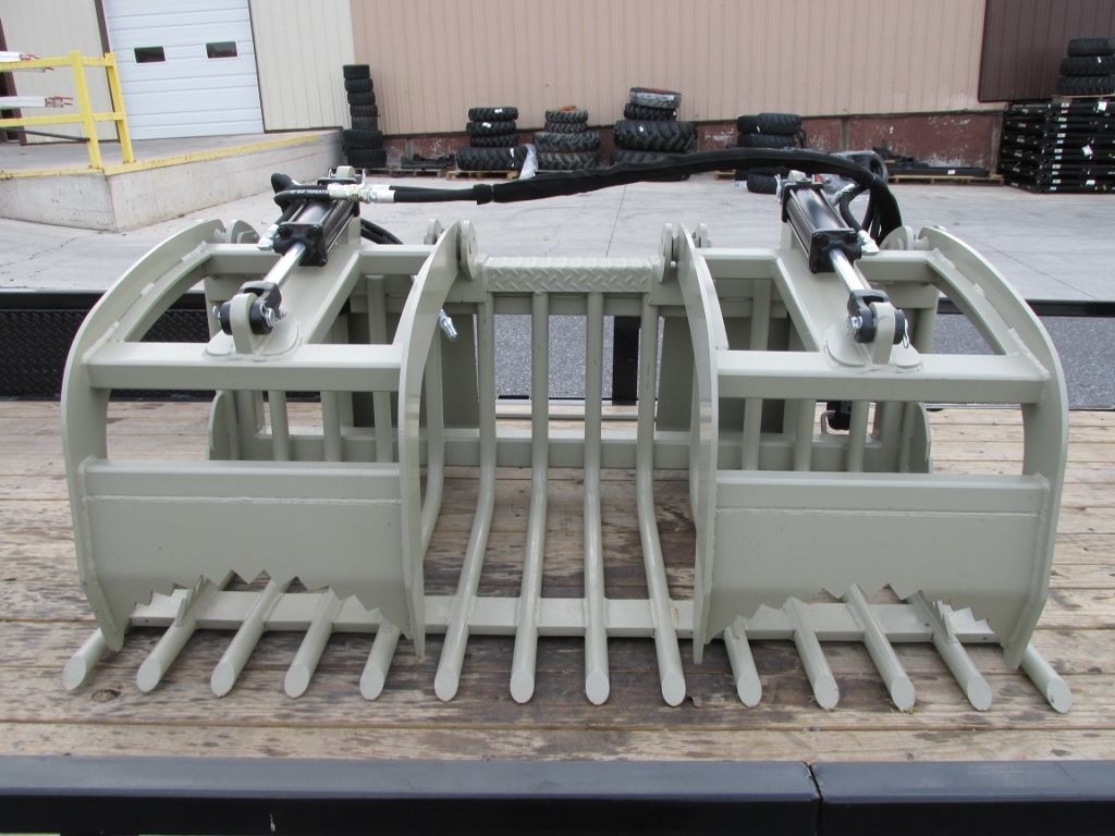

I have to agree with the RBG would be the easiest to use picking up logs. The grapple Faxman shows would be preferred over the Steiner you linked to. Too many tines on the Steiner imo, means it will hold too much dirt. If you need to scoop up small debris you can swap back to your standard bucket. I would think the small debris can be worked back into the soil, you want to get out only the larger pieces to put on a burn pile or haul away.

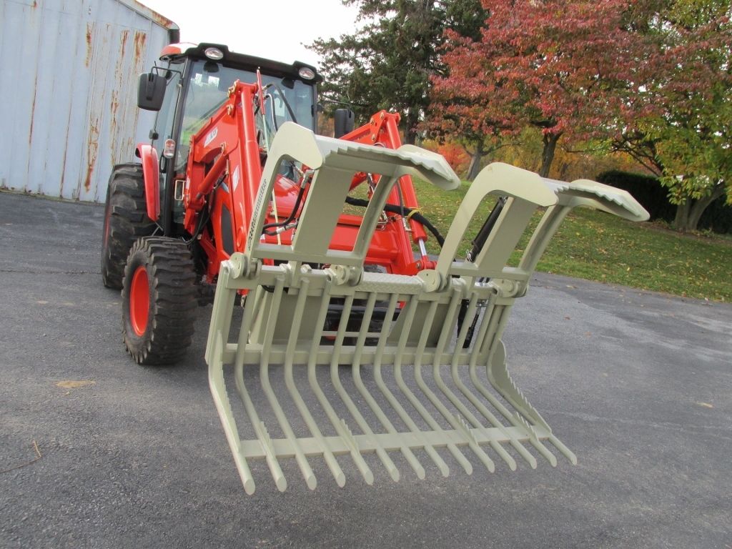

As a 110 owner, what do you think is idea on weight? I actually partial to the tine spacing on the Stiensemmler, as it'll double as a rock bucket but allow the small stuff through. The faver is another favorite as it closes tight and has the flat tines. 72" Faver Skid Steer Brush Root Log Grapple Rake Loader Bucket Attachment Bobcat | eBay

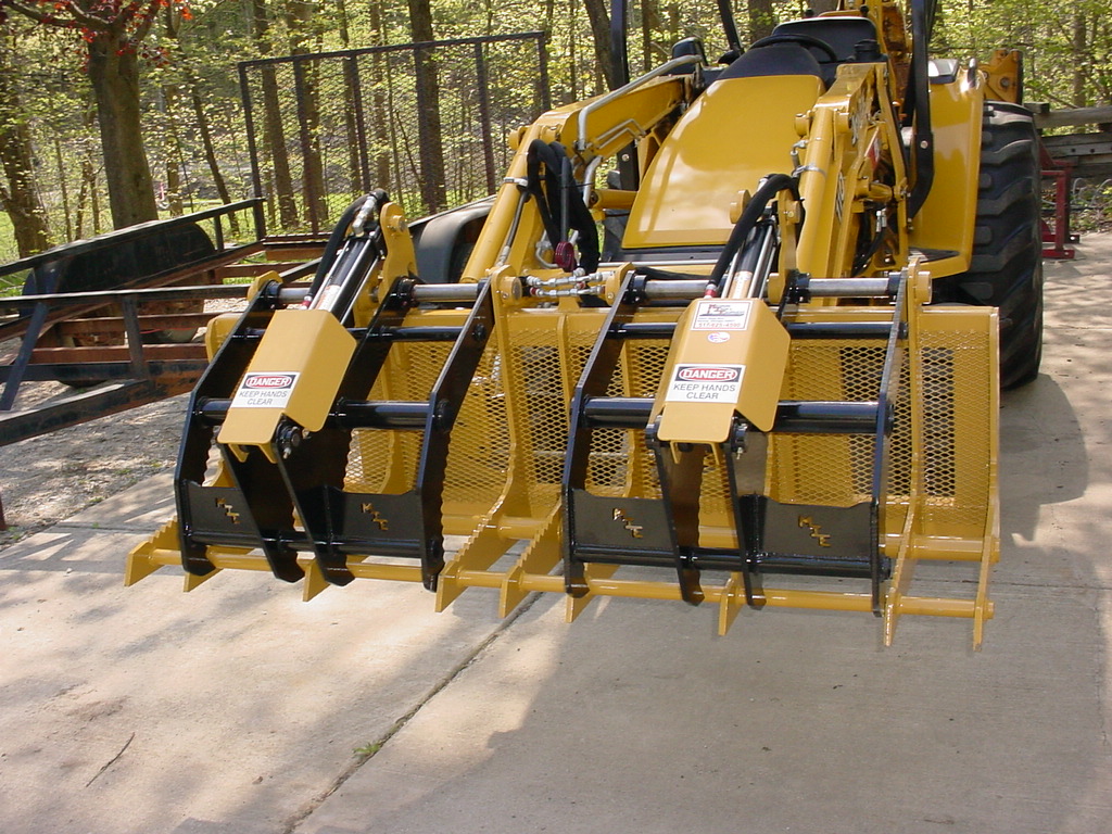

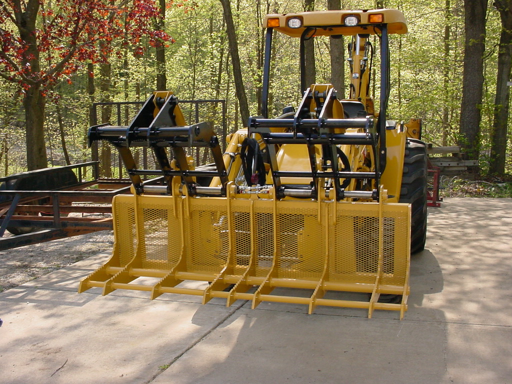

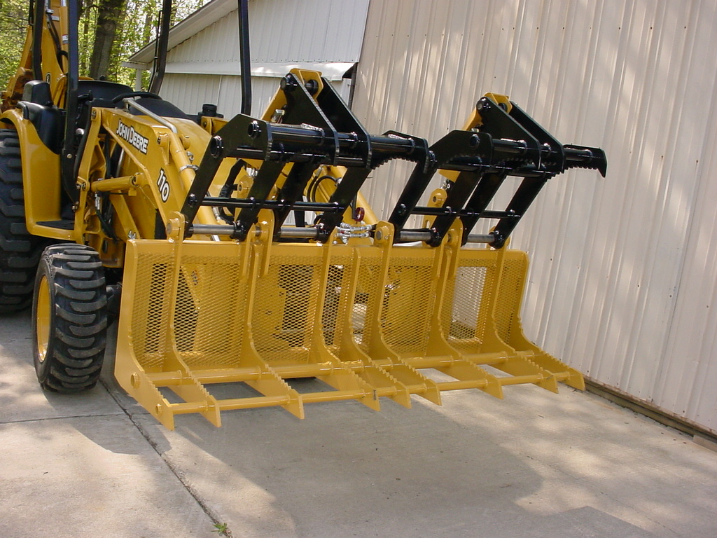

I agree, you don't need a 72'' wide grapple. That's what I have. If I had to do it all over, I would buy the narrowest grapple that will fit. (I should have listen to the guys on TBN ) I bought the grapple from MIE

I have the same one as Doc but 66".

Doc, that's a nice grapple, what's the weight on it? I like the rear screen and it looks to be a good compromise. How do you like it?
As far as the width I agree to an extent but it really depends on what you're doing. If your picking up brush, the larger width is good but for the majority of my uses a narrow unit will work.
