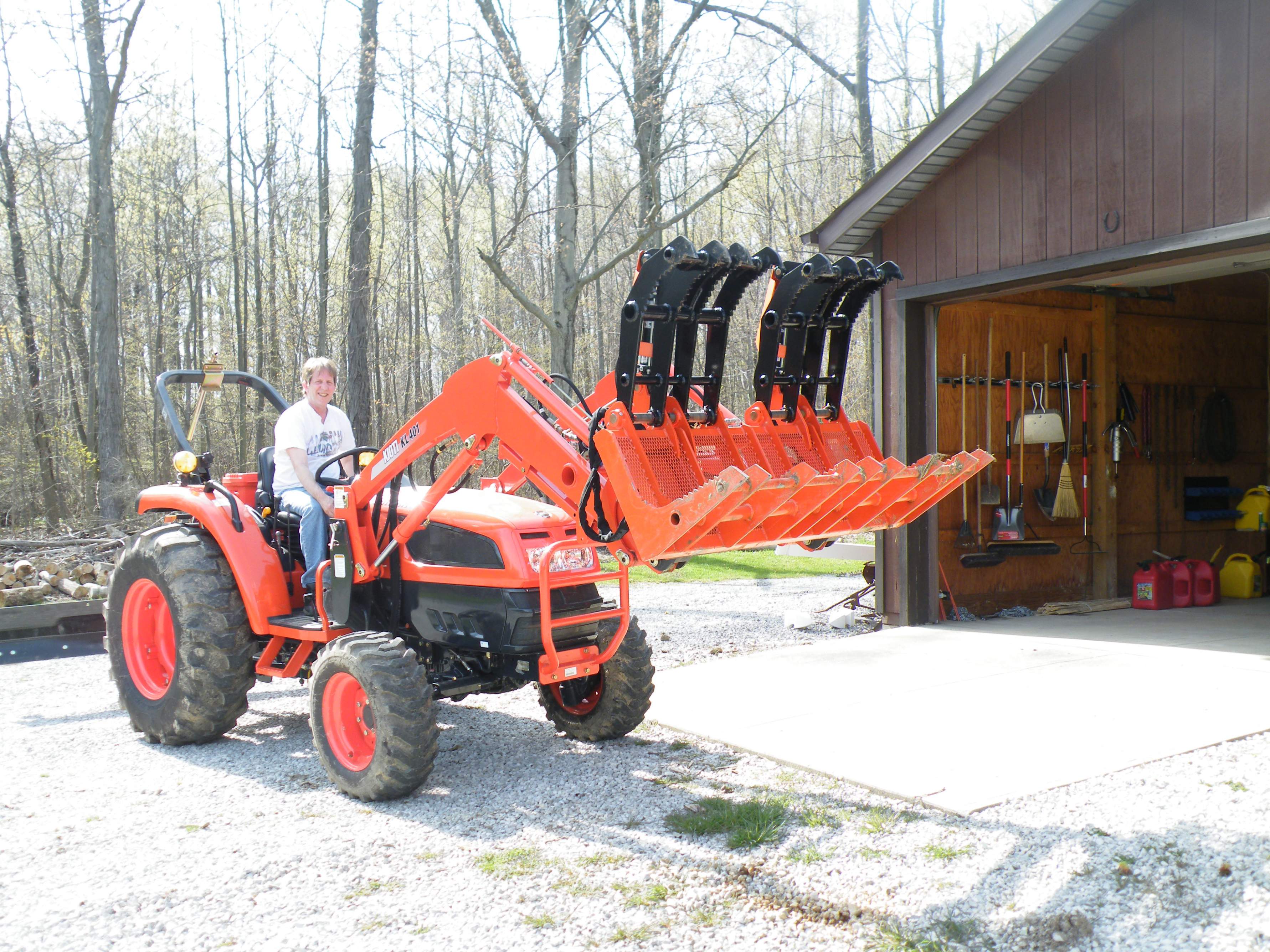

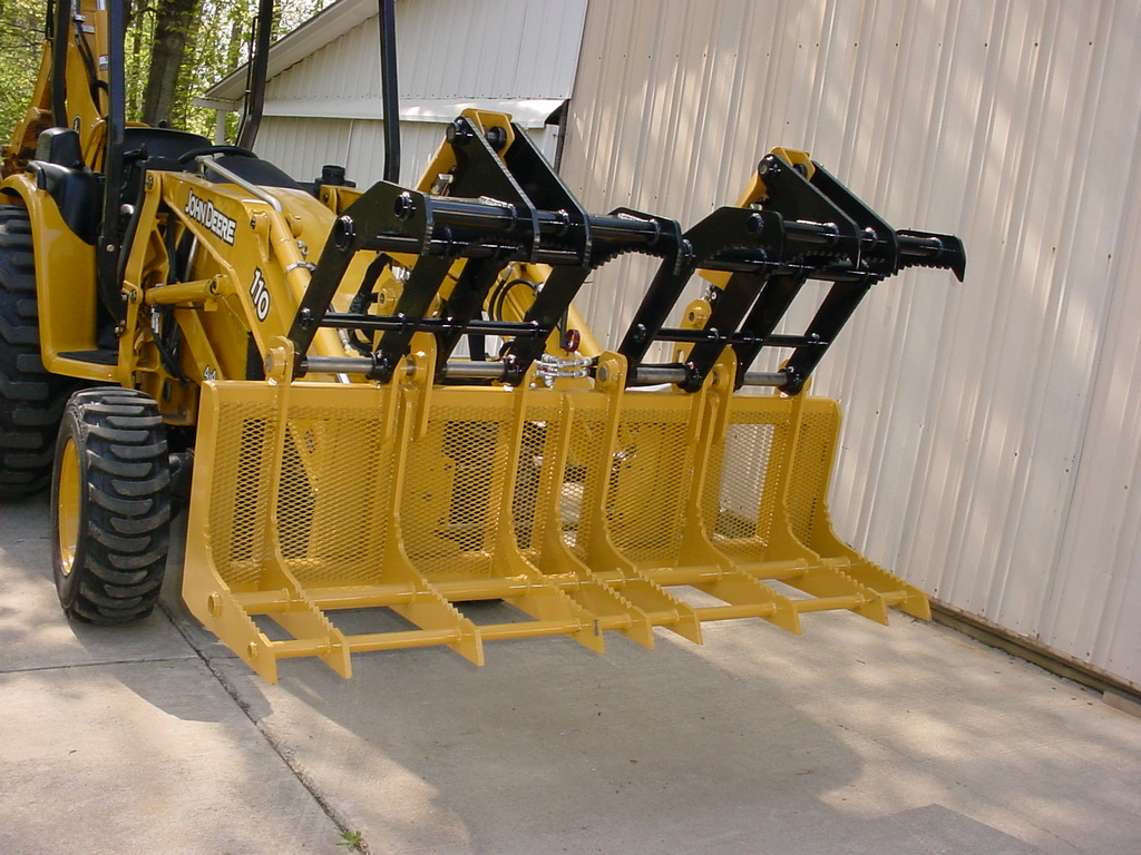

Look into,----
I've had two of them. You won't find a more durable, quality grapple anywhere. They are expensive, for a reason, You won't wear one out. I have a friend that has one on his 110. His and both of mine are 60".
David
Have you ever had or used this style or shape grapple?
My first grapple, Better than no grapple.
My favorite style of grapple, the one I have now.

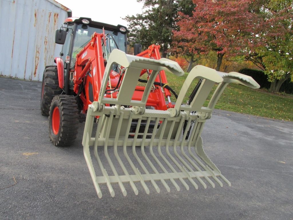

I have the Everything Attachments Wicked root grapple 60 inch double clamp have been abusing it since I got it and have yet to damage it and I am very satisfied.

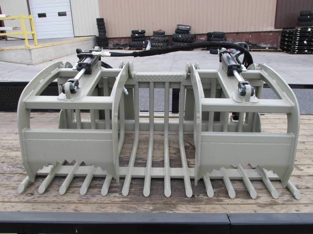

Today I ordered the Notch Manufacturing 58" dual lip root grapple. I've been partial to the design for a while and liked the specs.
I looked real hard at the Faver but the weight was more than I wanted. The Notch is 3/8 high tensile steel and weighs around 500lbs.

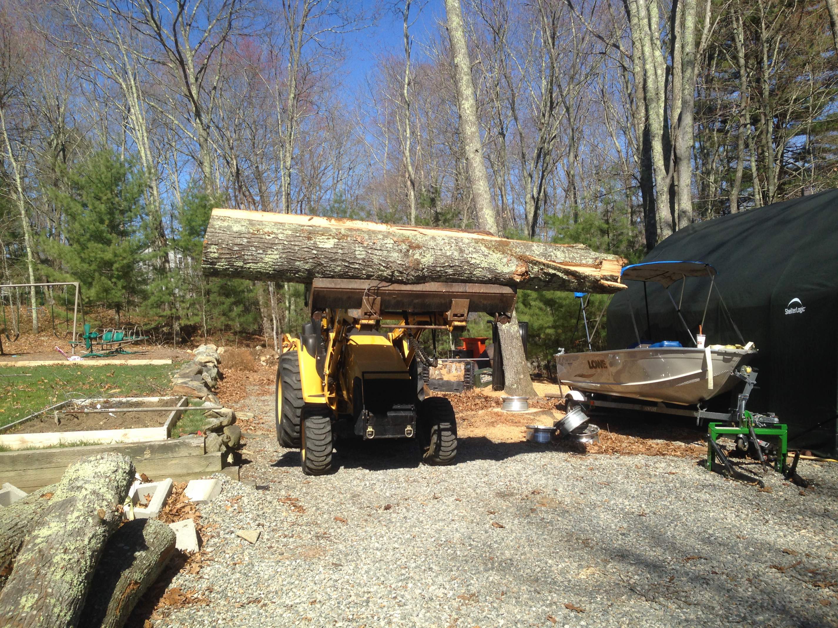

I haven't posted the videos yet, but I've done some silly lifting with the wicked root grapple. It is very good at grabbing logs, but just okay at brush. The crossbar serves to limit skewering brush piles as well as digging into roots. On the other hand, the wicked root grapple seems indestructible as well as light, two redeeming characteristics.

After a 3 week wait the grapple arrived yesterday, I would absolutely recommend Notch Manucturing as a good vendor. Great communication, the shipping company wasn't to gentle with the grapple but it's going to get the paint damaged anyways so I didn't make a huge deal about it.

Interesting grapple design. I've never seen one that looked like it had a toothbar welded on to a grapple before. It should make brush clearing very efficient but I wonder if it will impede digging for roots. On the other hand, mine has a ?2" tube welded between the tines at about the same position and it doesn't stop me from digging though so probably the teeth on yours won't interfer either.
How much does that grapple weight? It looks very delicate because it has so many tines but they are all well tied together so I imagine it is quite strong.

Having had the same Millonzi you have I can say this one is built heavier, It weighs just under 600lbs, and is made of 3/8 hi tensile steel.

The high tensile steel explains the smaller looking tines.
Does the "brush cutter" bar between the tines affect digging at all? If it doesn't then it would be great for ripping out vine roots etc.

I haven't really gotten to use it as it only arrived yesterday, the front bar seems to act like s blade to brush. So I imagine vine roots will be sheared as well.

So I've had the grapple for a little while now and it's fantastic. The notched flat bar does have a shearing affect on vegetation and it's also a handy rock bucket. The paint has worn off on the high contact area but that's the nature of the beast. I've moved at least 80 yards of large stones with the grapple and it's been flawless. For logs and brush it's fantastic and I haven't seen anything negative about the dual lids. The one item I will be adding is the hydraulic hose spring as that's the only complaint I have with it. Notch it worth a look if you're in need of a HD grapple!
