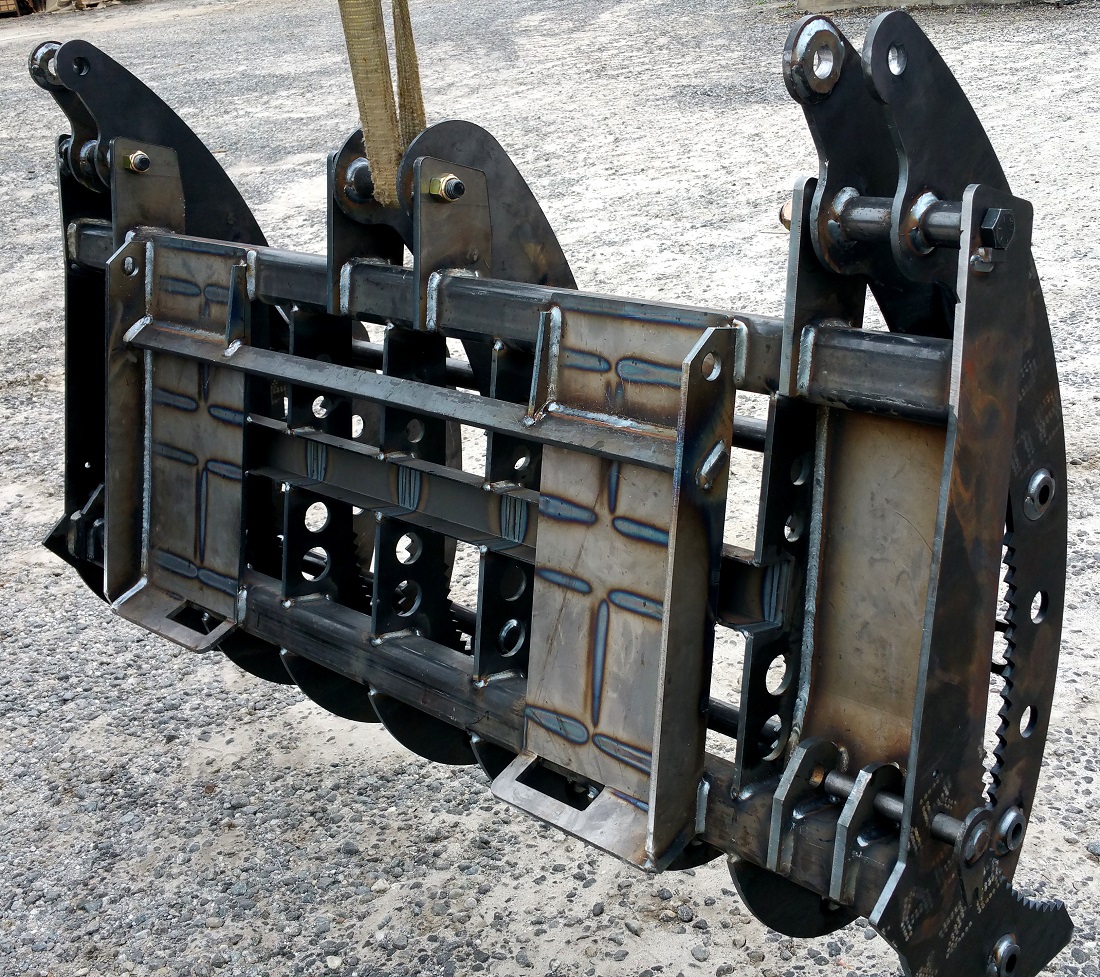

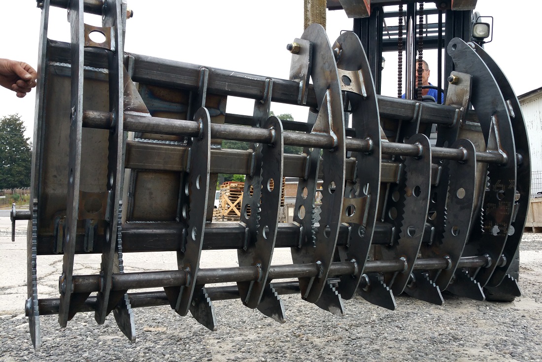

I'll update this with more progression, but here are the first pics taken of it.
A maneuverable sweet spot of 66 inches wide and it will be in the 600 pound range. Because of the materials used and Signature Wicked design features, this one will most likely be rated for up to 100HP tractors. :eek:
I hope you guys will comment and follow our latest Wicked Journey!

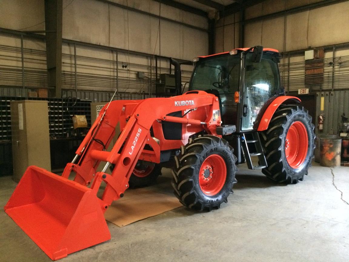

/ Utility Tractor Grapple Dream
Nice thoughts guys, but we better make our M6-141 earn its keep! :laughing:
With Ted at the wheel, I'm pretty sure it'll rule out any doubts about strength.

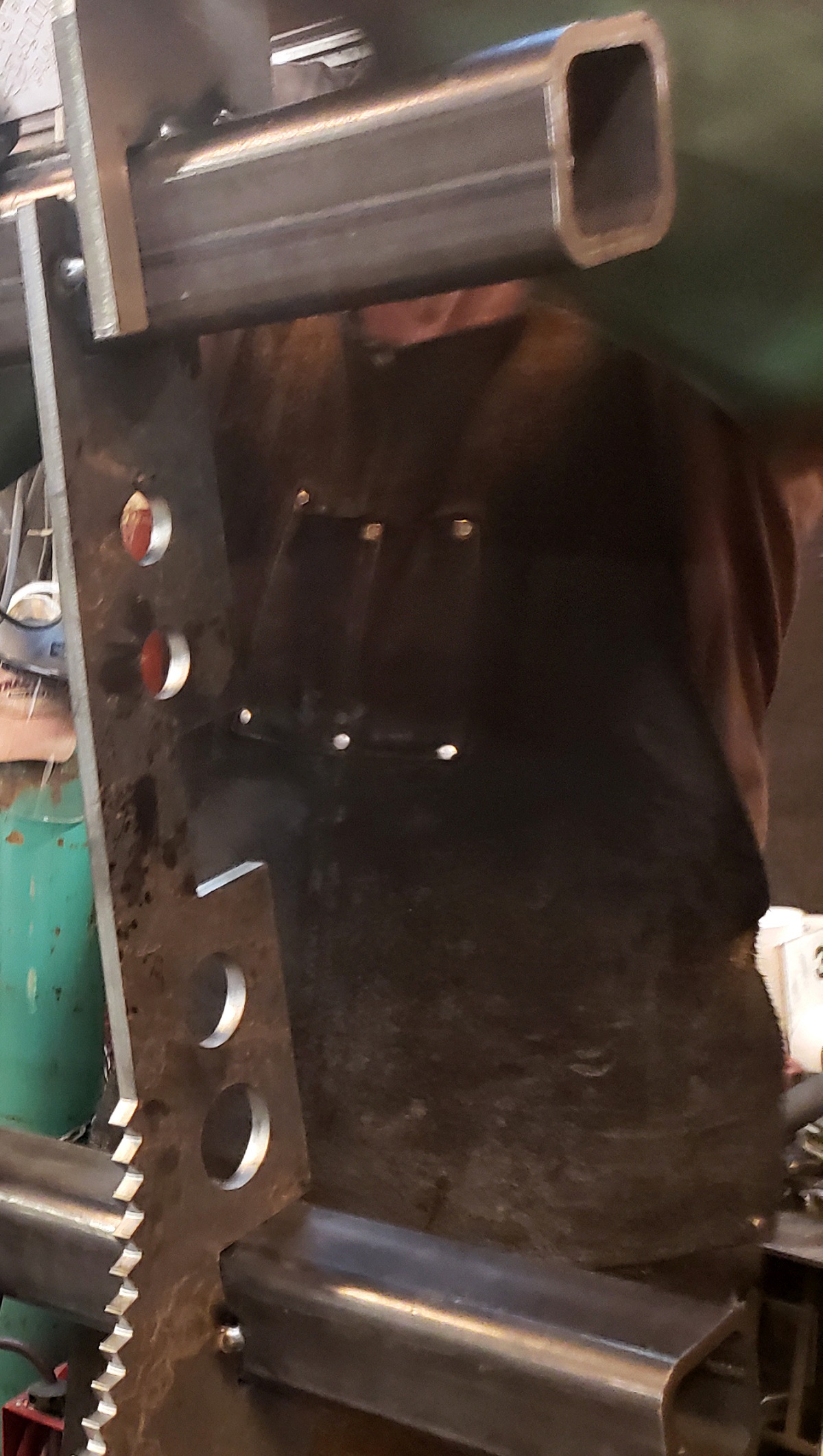

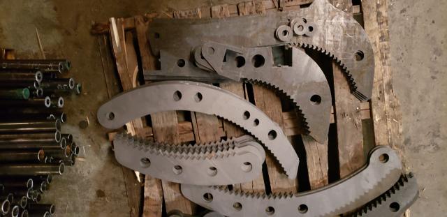

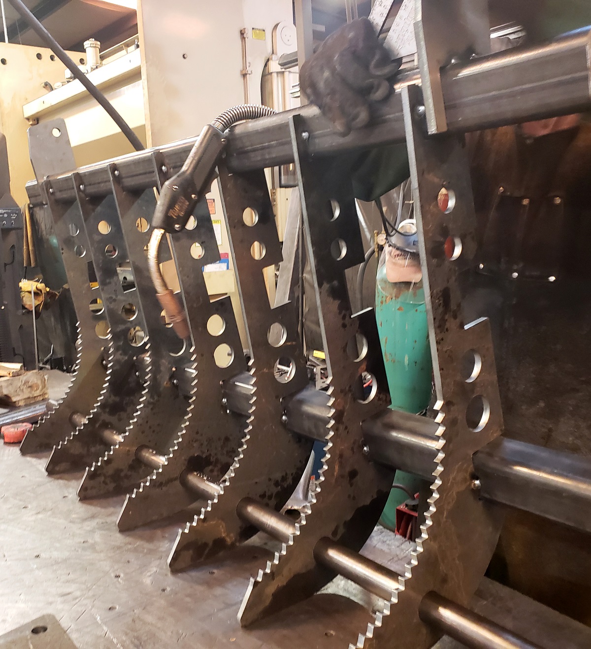

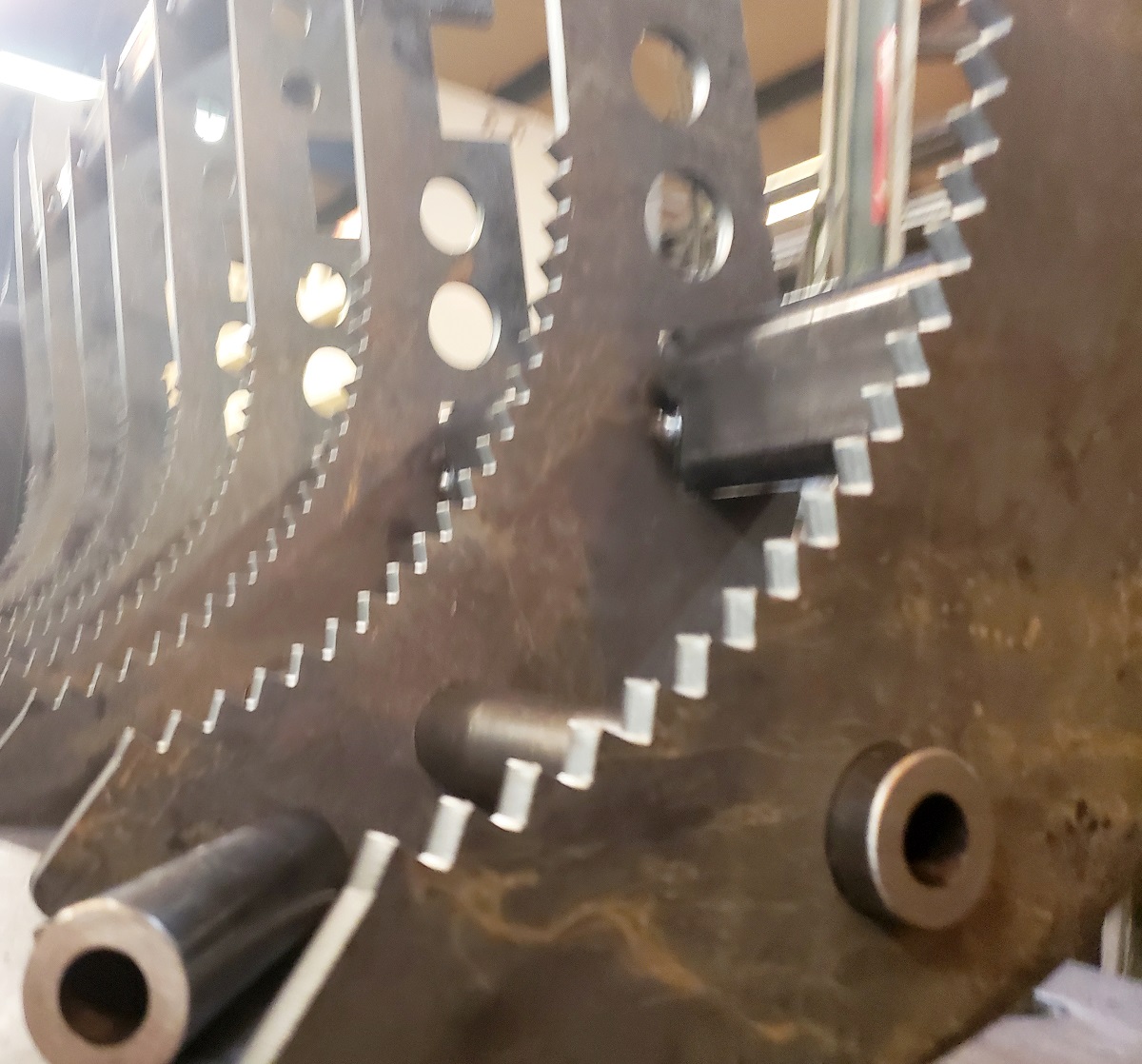

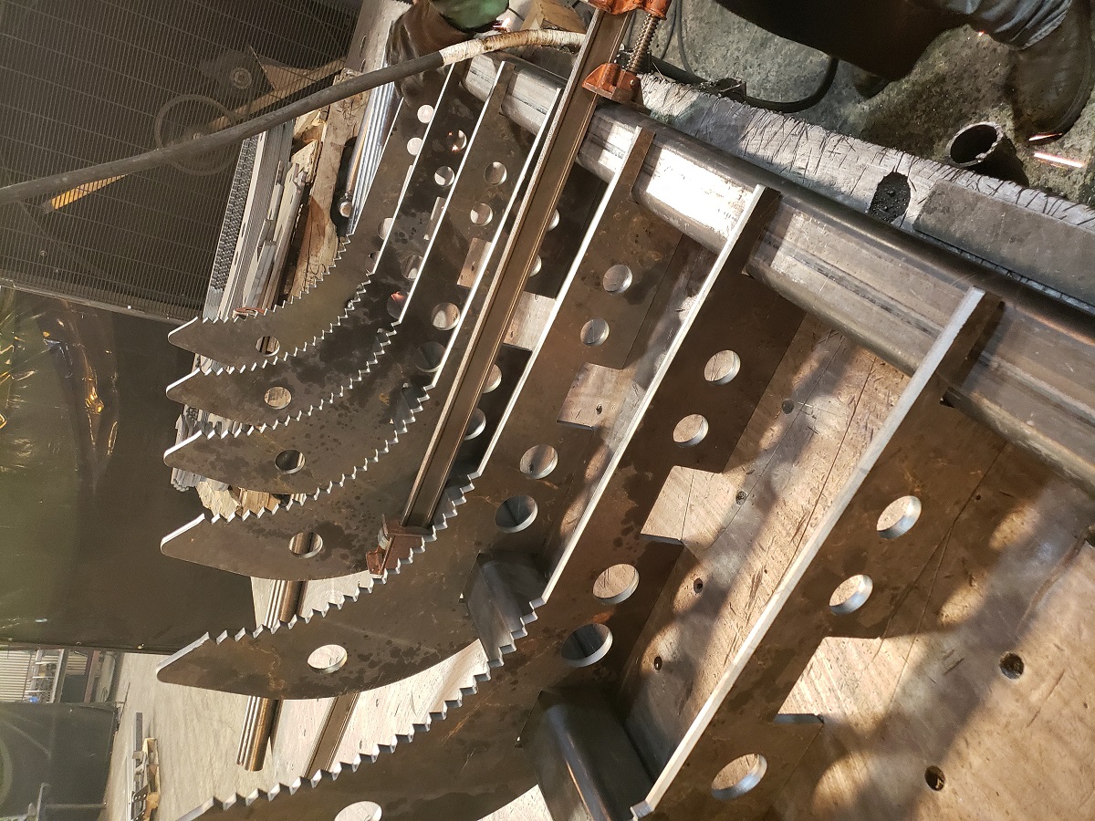

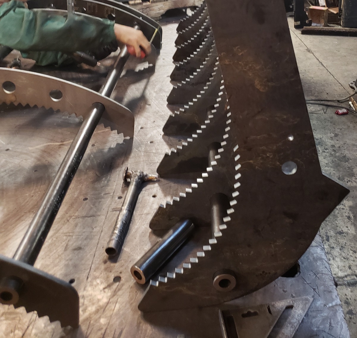

Wicked Tough right here, guys!
Check out how serious these materials are.
Travis
The round DOM tubing is 1 7/8" OD Schedule 120, which has a wall thickness of almost 1/2".
Square tubing is 3x3 with 3/8" wall thickness. This is the thickest 3x3 tubing you can get.

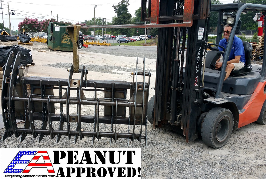

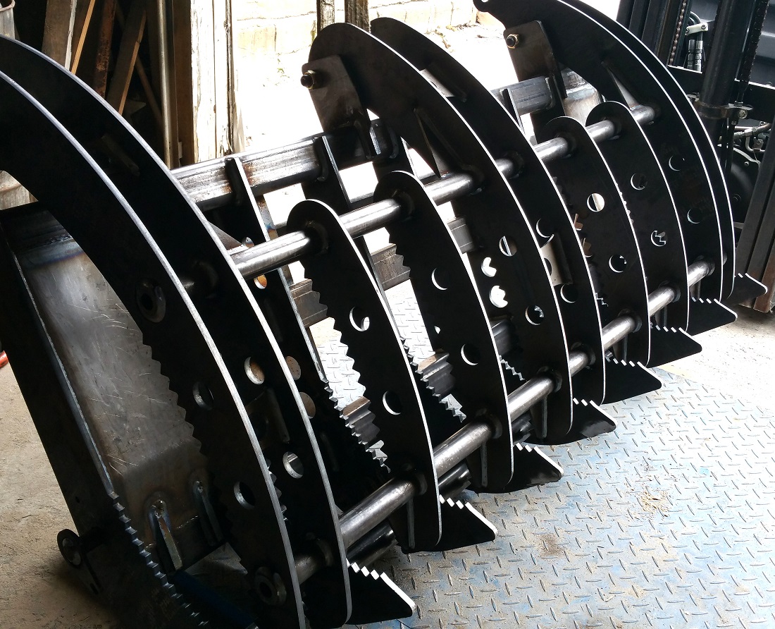

This new 66" beast went together perfectly and it quickly earned the Peanut Stamp of Approval.
Travis

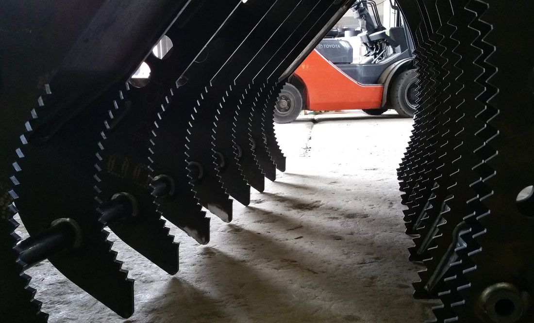

I've always been curious about the teeth on the tines. Are they necessary for holding? Do they allow material to fall out when opened?
/ Utility Tractor Grapple Dream #8
i made a grapple and put some serrations on the teeth when i cut them out with the plasma cutter. I think it helps hold some stuff.
#9
The Wicked teeth greatly enhance it's ability to grip and rip! We've received tons of positive feedback from customers who really appreciate the added ability to hold onto otherwise hard to contain objects because of our Wicked tines.
We'll be using/testing this new grapple on our M6-141 and you'll see how easy it is to unload brush/debris.

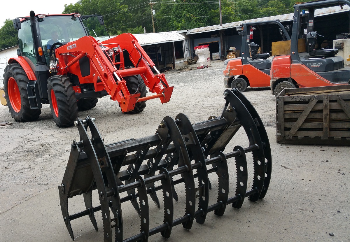

Check out this exciting scene, guys!!
Travis

This new Wicked 66 has been performing Awesome out in the field. Premium materials such as AR 450 steel tine construction with laser serrations along with incredibly strong DOM tubing leaves this grapple alone at the top.
We mention the primo DOM tubing, but who actually knows what it is? Here's an explanation:
DOM, or Drawn Over Mandrel, tubing is made from a cold-drawn electrical resistance welded tube that is drawn through a die and over a mandrel to create dimensional accuracy, dependable weld integrity and an excellent surface finish(which we manually scuff so the paint will hang on). DOM has high tensile and yield strength, so It is generally chosen over welded tube where high pressure or large workloads are needed such as the manufacturing of race cars and motorcycle frames. Add Wicked Grapple rakes to the list!!
