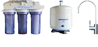

We have a couple water coolers and my wife thinks they need filtered water so I have been buying and hauling home 5 gallon bottles of filtered water. Today I tried 2 places to get the filtered water and the machines were not working. GRRR. Anyway, I am sick of buying water when our water is perfectly good. It tastes great and smells great. I have it tested regularly and it always tests great. It may be a little too hard for the water coolers though. So I am looking for some type of under sink water filter recs. Something that is easy to service and install. Thanks for reading and for any recommendations.

If the water tastes great and smells great, what are you trying to filter out?
Water cooler as in cools and heats water from two little taps? Almost nobody that I know cleans and sterilizes the 5 gallon water dispensers, which is pretty crazy in my book.
If you want to go the RO route, Watts or APEC are the main makers of quality units, and they can be plumbed so that the water isn't exposed to dirt, dust, and bugs.

The hardness. I guess. Clogs stuff up. So I need to filter out the calcium. I guess.

That would be more like a water softener than a filter. If it were me, I would run the softened water into an RO system. Running raw water into deionizers is pricey expensive to operate. You can price them out easily on the web. E.g.
If you have had the water tested recently, you should have the results that might help you settle on what, and how much, you would need to remove.
How hard is the water? Lime scale in the shower? Laundry challenges? Issues with toilets? There's hard water, and then there's hard water. Some is much harder than others.
If there isn't much mineral, the cheap and low hassle option might be to just clean and acid wash the water coolers regularly with a cleaning agent that they can tolerate, or have someone deliver water for you. I know that's not exactly what you were asking for, but to truly remove calcium is more than a filter.

Also note that no filter will remove dissolved solids. Get a tester and try it. I thought my under-sink filter for my drinking water outlet was cool. Thought the water tasted better. :rolleyes: Turns out after getting a digital tester, the TDS (total dissolved solids) and pH were the same as the regular sink outlet. The filter wasn't doing anything to improve the water. :cry:
/ Under cabinet water filter recs please #15
Just to clarify things a bit, RO filters do remove/lower total dissolved solids (TDS) by having a reject water stream with the extra TDS in it and a purified (permeate) stream with the clean(er) purified water, but for any sort of membrane life, they need to be supplied with softened water.
Water softeners have resins inside that exchange sodium ions for magnesium or calcium. Some resin mixtures can even remove some of the sulfate in the feed water. That means that while the TDS stays the same, there aren't insoluble hard water deposits on fixtures or clothing.
After water softening, an RO filter (membrane) then takes the sodium, and many other ions 90+% out of the water. Our RO takes out 98.7% of all the dissolved solids, but that is very much a YMMV number as the overall efficiency has a lot to do with what exactly the ions and counter ions are in the feed water, the feed pressure difference, the membrane quality and age.
I used to make ultrapure water for work. There are lots of ways to skin the cat, but lots of variables. Drinking water is pretty easy. Kidney dialysis water is harder. Other forms of pure water can be fantastically hard, like clean water for making semiconductors.
But back to @etpm's question: I think it is a question of cost and hassle. Buying soft bottle water is low capital, high hassle, adding a water softener and RO is a capital investment, and maintenance commitment (buying salt, changing filters and membranes) and will not fit under a sink, but might be plumbed to give you soft water throughout the house for improved laundry and ease of cleaning, as well as feed and RO unit for low TDS water.

So after reading about removing hardness from water I learned (again!) that a filter isn't going to remove dissolved calcium. I could use a water softener but that is not a viable option for myself and my wife. We don't want to trade sodium for calcium. The upshot is that I need a reverse osmosis device. They have really come down in price and up in flow since I last looked at RO filters 20 or so years ago. It looks like I may buy one. If I do I will report back here with the results. My wife really likes the water cooler we have because the water bottle is stored under the water dispenser and the unit delivers hot, refrigerated, and room temperature water. So we are gonna be keeping it and refilling the 5 gallon water bottles. So either I have to go the the store to refill the 5 gallon jugs or I get one of the RO units and fill 'em at home. Since I also want to install a carbonator because I like soda water an RO unit might just be the very best solution.

I have some perhaps welcome news. An RO absolutely does require a water softener to swap the calcium with sodium for the RO to work. Otherwise, as the RO concentrates the incoming water as it makes "purer" permeate water, the calcium gets concentrated on the inlet side and will almost certainly precipitate, clogging the RO membrane that cost on the order of $80-120/each.
Unless you and your wife continue to drink tap water, rather than RO water after you install a softener and an RO system, you won't be getting much of any sodium. (Probably on the order in 15ppm max, or about 15mg/liter, 30ppm TDS)
I would suggest buying an RO tank that is at least 10 gallons to make the filling of your water coolers easy, as the RO tank holds about half to two thirds of the rated capacity under normal conditions.

The units I have been looking at have some sort of flushing business going on that is automatic. Apparently this is to prevent exactly the situation you describe. I know the theory of RO water purification and how the stuff that doesn't make it through the RO membrane gets concentrated and must be removed for the RO process to continue. This is one unit I am looking at: https://ecovivafilters.com/products/wp-ro-600g
It has a 600 gallon per day capacity which is way more than we would ever use and a 2.5:1 filtered water to waste water ratio. So for every 2.5 gallons of filtered water it produces it flushes 1 gallon down the drain. I can live with that. We don't drink that much water.
