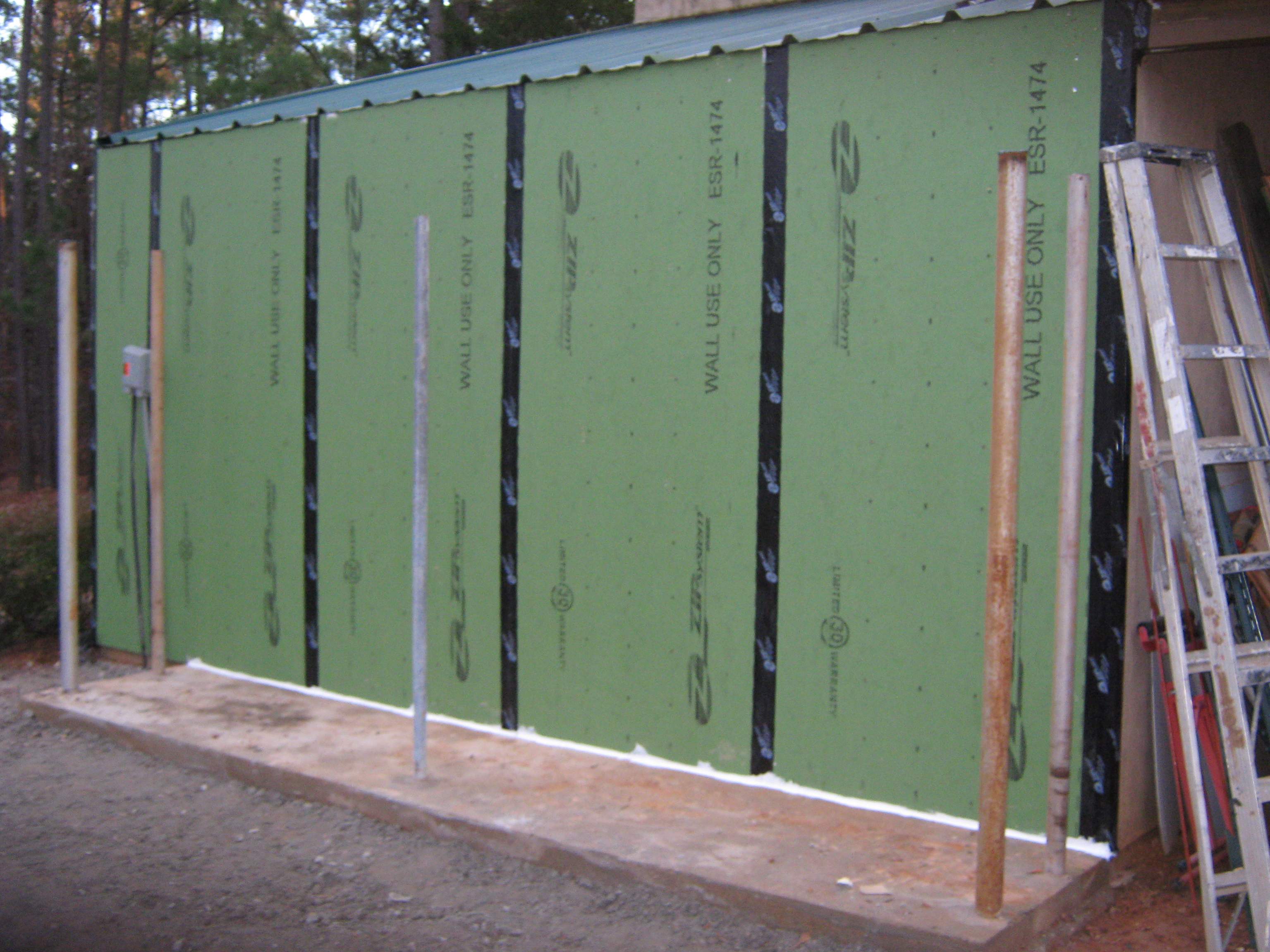

I've been thinking about trying Zip System Sheathing on my house. I'm going to be adding on to my house and redoing my exterior siding with Hardi Lap Siding.
I want to do the siding one wall at a time because I don't want to get too into it and not be able to finish in a timely manner. Work is crazy and time to work on my place is getting harder and harder to find.
I've seen some commercial buildings using Zip System, but haven't seen it in any houses. That just means I havent seen it and that it's not used around here. I don't have any experince with it. Does anybody have anything good or bad to say about it? At $15 for a 4x9 sheet, it's quite a bit more then OSB and house wrap. That's not even including the special tape that is required.

I just put hardiplank on my house and although harder to work with than vinyl it looks great and I think it is worth it.
I don't have any experience with their zip panels - but Huber's advantech subfloor is well worth its premium price. It is likely that the exterior panels are well engineered too.
I have seen some residential builders use it - I usually see it on townhouse buildings that take a lot of time to get fully dried in.
If you are going to have the sheathing exposed to the weather for any extended periods, as you do small sections at a time, you may see the benefits of its water resistance. You really don't want any swelling of seams of your sheathing under hardiplank siding because it is fastened tightly unlike vinyl and will show any irregularities in your framing.
You may be able to do some research and see if you can use tape other than the proprietary brand - although all housewrap and flashing tapes are expensive anyway.

I have used it good product very dense sharper edges and a little harder to
cut than osb.Holds nails well very good if you leave exposed along time.
We don't use it much cost is the only reason. Roofs and walls get covered
quickly around here.

From what the website says, the wall product is 7/16" just like OSB. It's the green color. The red color is the roof product and is called 5/8" for a true half inch thickness. It's also tonge and groove so with enough strength that you don't use H clips. I'm wanting it for my walls and will probably order some next week.

I've looked on the website about how to attach it, but all they say is to nail it every six inches on the edge and twelve inches in the middle. They don't say what size nails to use, which isn't a big deal, but what I'm really wondering is how do you seal the nail heads? or do you?
I'm assuming that the water barrier on the panels will seal a nail that goes through it just like tar paper and house wrap does. But the nail head is still exposed, and if any moisture gets behind the siding, will it rust or lead to failure?

Eddie- if you are concerned about exposed nail heads, why cant you use the same tape that zip system use to cover seams with over nail heads? I don't see anything wrong with that. If anything, it just a extra few rolls of tape on the project.

The February 2011 edition of JLC, The Journal of Light Construction has an article on using the Zip System Sheathing.
There is quite a bit of information in the article on using the material. Things that stood out to me.
- Roof material is some what skid resistant.
- The material on the exterior side of the sheet eats up blades.
- Depending on the inspector/code you do not have to use a house wrap.
- Because house warp is not needed, and the walls can be finished before standing up, using the wall sheathing is cheaper and faster than using OSB and house wrap.
- The builder is not sure that using the Zip Roof sheathing is cost effective in his area but it could be in other locals.
- Since the system keeps out water, the builder was not spending time and money running heaters and dehumidifiers to dry out the house.
- The tape was a big expense.
- Roof panels are 1/2 and 5/8 of an inch thick.
- Wall panels are 7/16 and 1/2 inch thick.
- The panels have a self spacer along the long edges.

I'm GC'ing a house for my in-laws now and we used the entire zip system on the walls and also roof. Also used Huber (mfg. of zip) Advantech floor sheeting. The stuff just flat out rocks. No need for house wrap or roof felt. Superior weather resistance, impregnated material, etc... Highly recommend it. They also had a rebate program and i got back $1,800 using the stuff. Overall cost was almost a wash using traditional methods. I'll post up some pics of it.

Another good feature of the ZIP sheathing is that if you tape it, you go a long way towards sealing up your walls, an important factor in building an energy-efficient home. Using the numbers in the JLC article, it will cost me about $450 more to use it on the walls of the small house I'm going to build. Figuring the house will cost at least $100K, that's not much money.

I went with the Zip System and really liked how it simplified being able to do one wall of my house at a time. I'm already weather tite, but I'm redoing my siding one wall at a time. The Zip System worked great.
