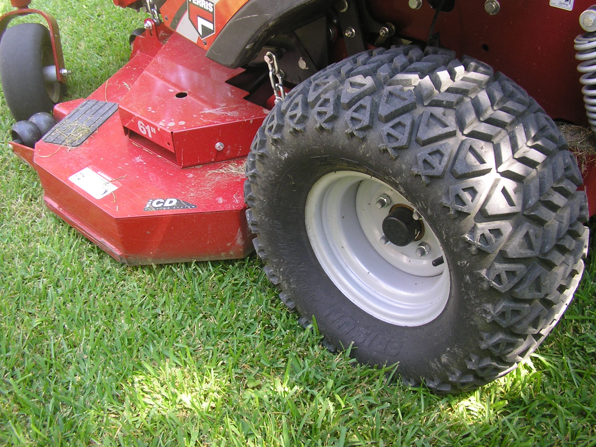

/ Zero Turn traction issues #72
Sorry for the confusion. I was referring to the "Dimple Knobby" tires (I posted a couple of pages back) as "studs". The tire pressure of 5 psig is rated to 50 mph....I read somewhere. On my mowing speed, I figure if the tire will supoort "15 psig max to seat bead" when installing, they have proven themselves to tolerate what I listed at 10 psig and a few mph.
On bonnet, rephrase "canopy". Has nothing to do with traction, just helps to determine which mower I will be using on a hot, sunny day. Real comfortable on the ZT for sure.
The tires shown are a pair of Golf Cart tires that looked like they would have good traction but didn't...also shown are the OEM 10" wheels that I later replaced with 8" to get a larger balloon area with the studs I mentioned. They are now among their friends in my pile of "oops" tires that didn't cut it.

Ah, I see!
Thanks. Also good to know those particular tires don't work that great, as they are ones I was impressed by the look of. I think I first saw them on the Ventrac/Steiner machines, but of course those are 4WD.
#74
Oh, and where did you get the 8" wheels from? That seems like a good idea too, for a larger contact patch. I aired down my stock 20x10-10s but it made little to no noticeable difference.
