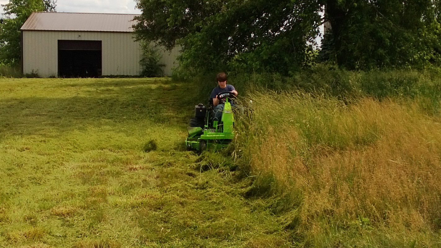

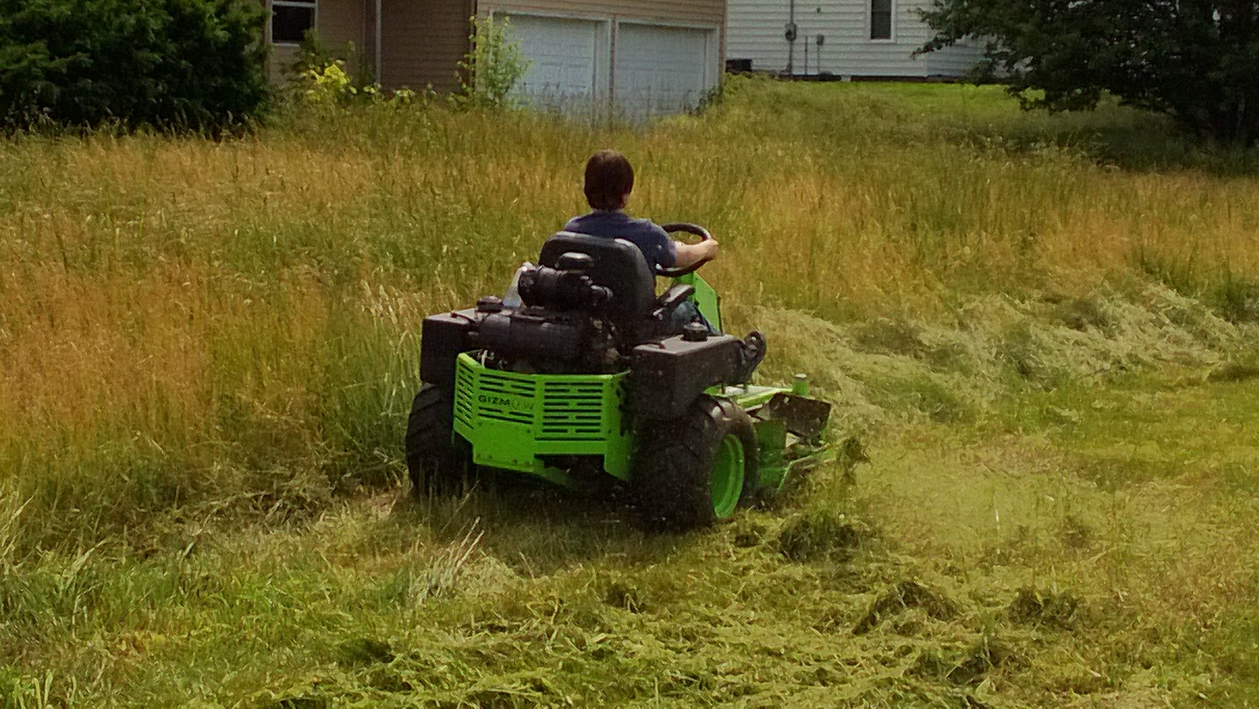

You can mow a lot with a good zero turn, but would you want to? I used the one shown in my field (not shown. This is a very bad 'lawn') a few times and it about beat my kidneys death, even with an air ride seat.
   / Can a Zero Turn mow high weeds in a bumpy pasture? #30
And he is only taking a half cut. So what, 30”? Some mowers are made for high capacity cutting, ZTRs are not.
