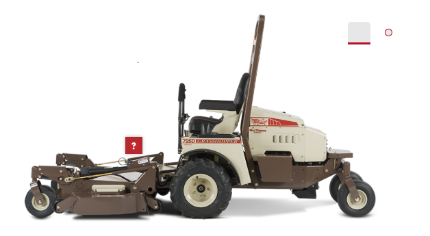

I had a Gravely front mount zero turn in the past that did a good job on slopes (Grasshopper example below). It did much better on slopes than a traditional mid-mount like that Ferris. It felt more planted than my 1025R on the slopes and had decent traction with the bar tires. Unless I actually got almost IN the pond I was usually ok. It probably would not do as good as a 4x4 tractor with ag tires though. You can get them with from I think a 48" deck up to a 72". It will save you lots of time. I would absolutely have another one if the opportunity presents itself.
