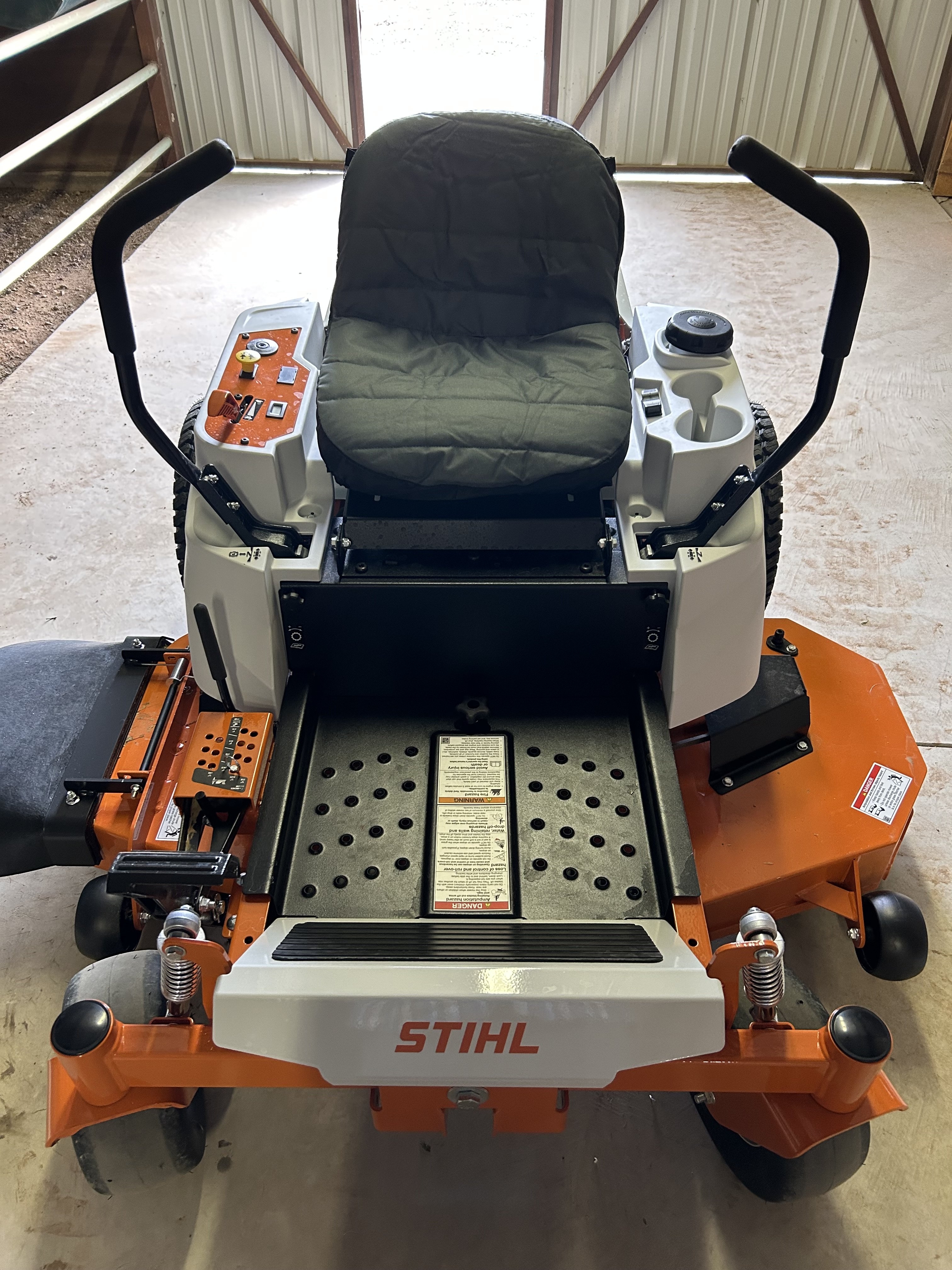

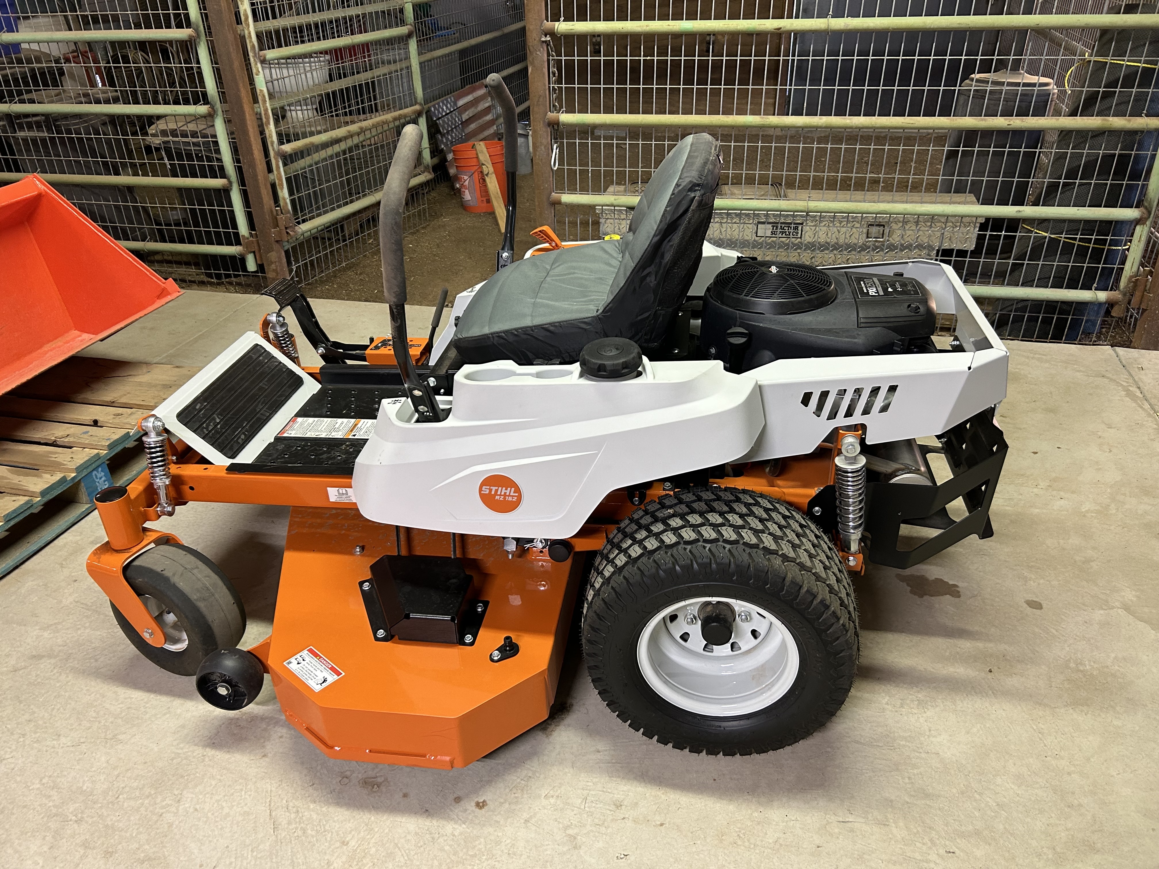

Photos showing the suspension.
Thank you and good suggestion. I will look into the Stihl mowers.
The coil springs on that model are much smaller than the top of the line Ferris, but I presume that is just because it is a different model.

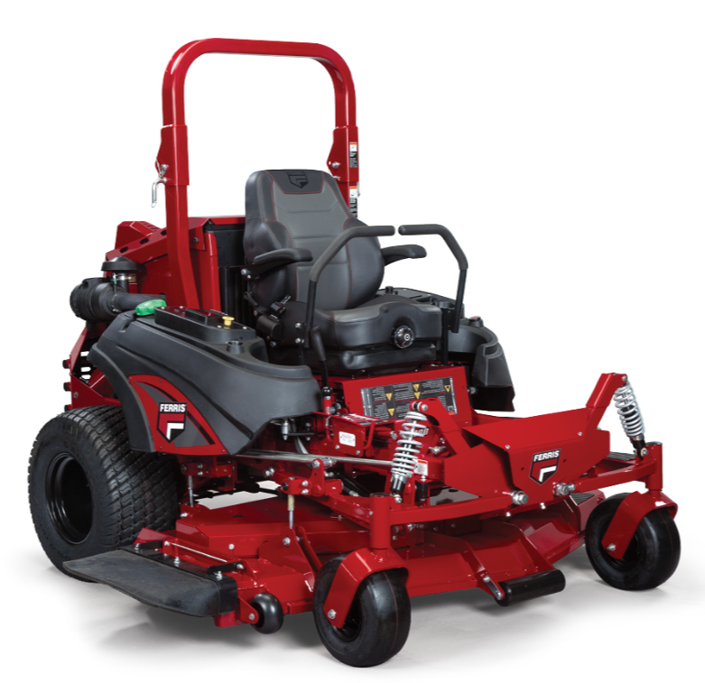

Here is a comparison pix of the top of the line Ferris ....
   / What machine, or equipment, can mow an uneven grassy pasture the fastest? Zero Turn? #68
I am wondering if a Zero Turn, such as a Ferris with suspension, would be a better faster smoother more comfortable mower for my pastures?
All I see in promotional videos are using these for lawns, not pastures. But if a speedy ZTR could perform well, I might be more comfortable (suspension) plus get more done by mowing faster.
My equipment right now is either an 8 foot rotary cutter or a Ventrac with tough cut. Using the rotary cutter means mowing at about 3mph due to terrain. Sometimes bumpy enough where I don't even try to go faster han about 3mph using a tractor. The Ventrac can average about 5mph, handles bumps a little better, but with a smaller deck and width of cut it is only a little faster than my tractor. And I still bounce around a lot.
I see advertisements for mowing at 12mph in a ZTR. Is it realistic to think a ZTR could mow a grassy pasture that varies between smooth and bumpy? If I could even do, say 8mph, that would be huge.
Here is a Ferris ZTR with suspension -- and a CAT 48hp diesel LOL. Only $40,000 and it is yours!!
