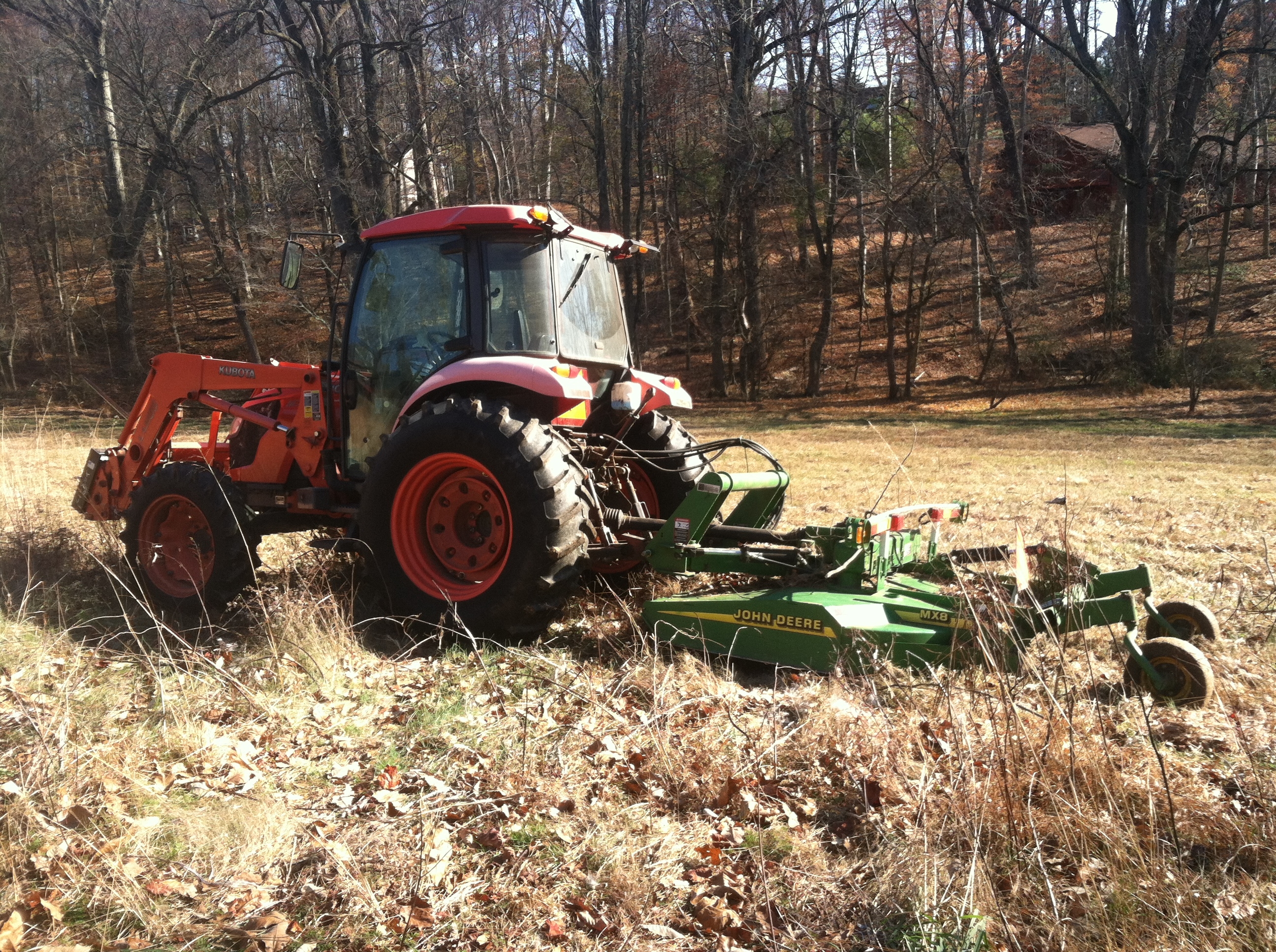

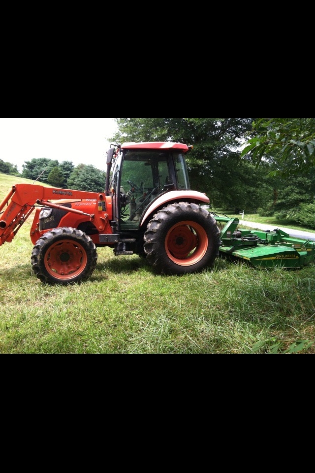

I had the perfect 8’ bush hog. A John Deere MX-8 with hydraulic side shift.
Bought mine lightly used and literally built my field mowing business with it.
Excellent A+ mower. Mowed way beyond it’s capabilities. I highly suggest you seek one out if you are in need of a mower that size. I simply outgrew mine.

That is/was a nice setup!

Yes it was. I started my business with the M-7040 and that MX-8 side shift twin spindle mower. Super nice mower. Could reach sideways about 30” each way to get under trees.
Deere makes the nicest rotary cutters, IMO.
Made a lot of money with that little set-up. Probably should have just kept it, but the urge to grow bigger was too much to overcome.
