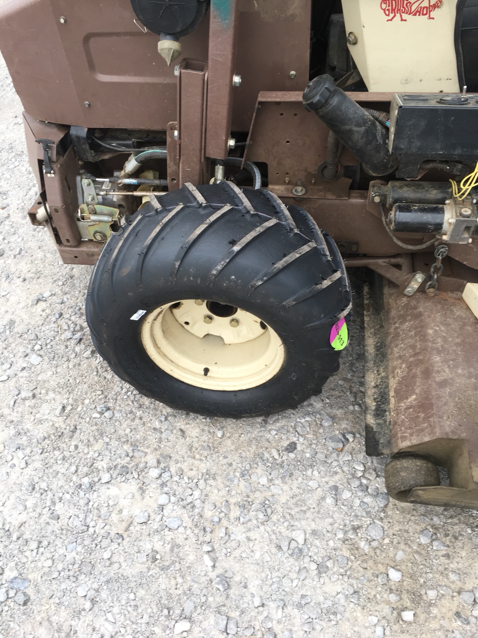

Check out this thread. I put WT300 bar tires on my ZT and the difference in control,on hills is amazing
https://www.tractorbynet.com/forums...385191-running-tractor-tires-zero-turn-3.html

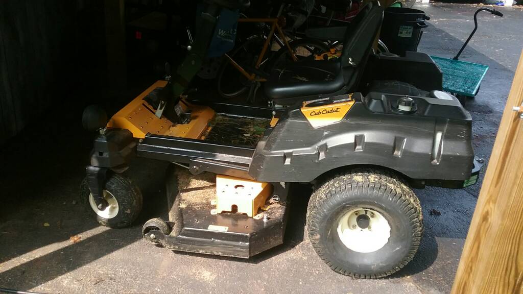

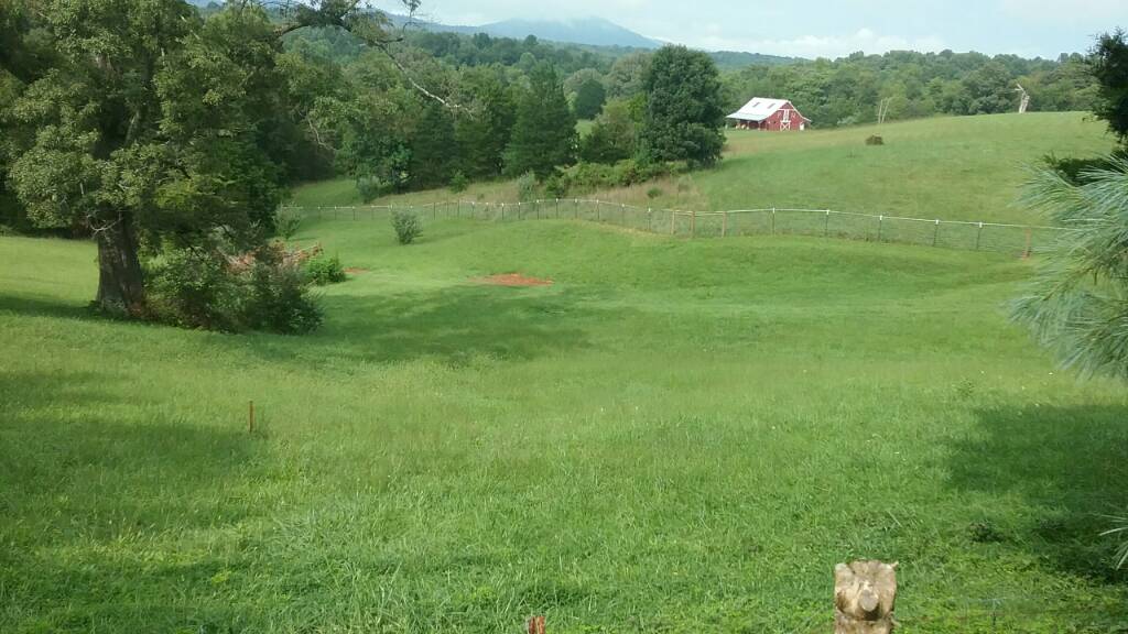

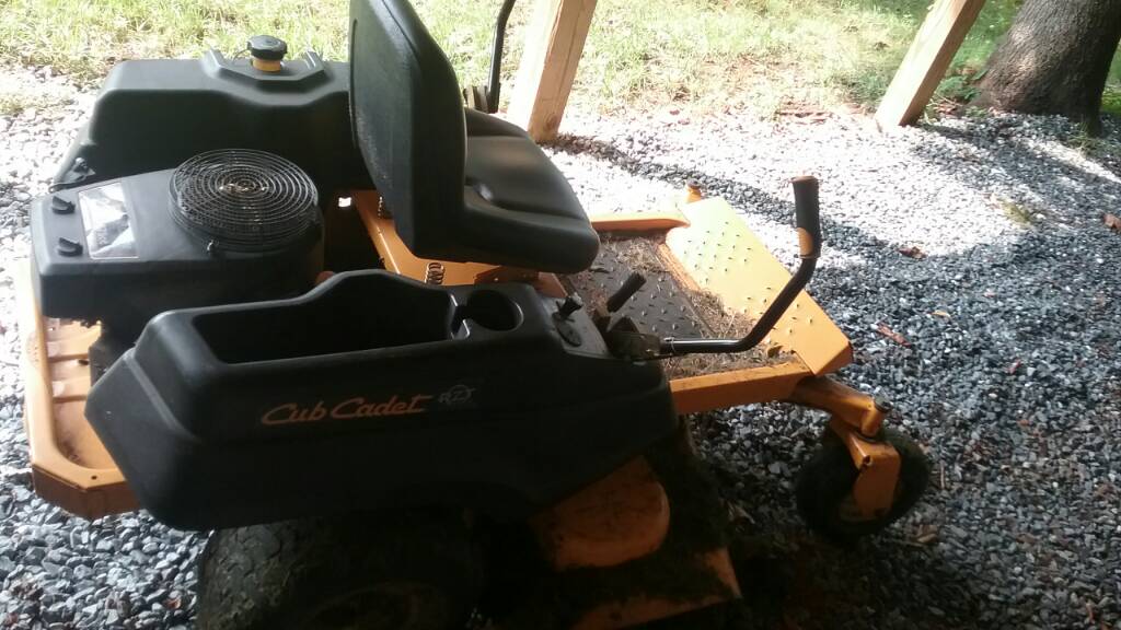

I have two Cub Cadet zero turns, older RZT50 and a Z-Force. The RZT the front wheels are just casters like on a grocery cart. The Z-Force the wheels steer. I use the RZT on really hilly dangerous areas. Picture you see I made a pass days ago along fence line. I go slow, wheels are straight. I lean way over. If it happens to turn going downhill I simply circle around going the other way. On really steep hilly areas I cut straight downhill, just like I do on other pastures when I bush hog. That to me is common sense safety. You won't flip a mower or tractor by going straight down hill. I turn at level bottom, circle around making another pass down. 20180819_160231.jpeg20180819_160203.jpeg20180819_160344.jpeg

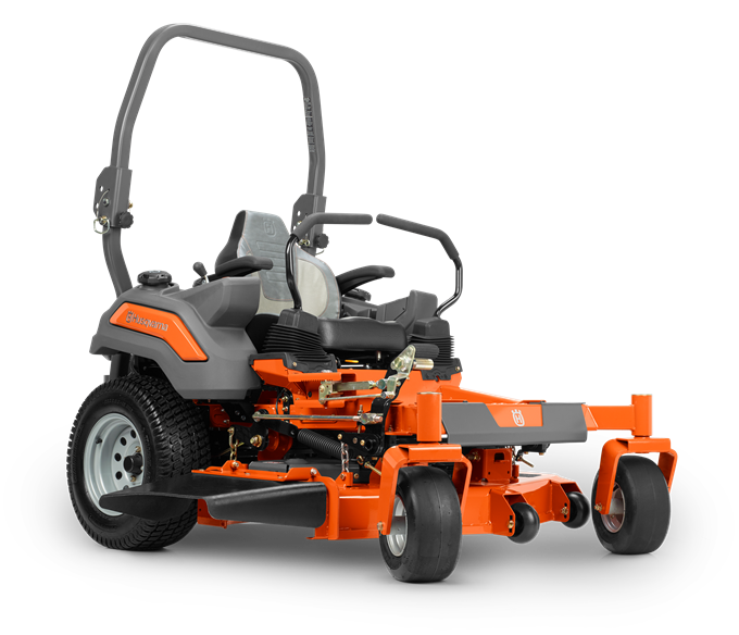

Mine is the Husqvarna Z554 Professional Model.
Did fine on the slopes yesterday, even though the grass was a little wet. Maybe this model is a little heavier duty?
The Husqvarna Z500 series zero turn mower represents the latest design focused on productivity, durability and cut quality. Providing extreme comfort, high ground speeds and superior traction adds up to exceptional mowing efficiency. Industrial strength throughout the entire design assures of a long & durable service life in commercial mowing applications. Careful design consideration provides unprecedented ease in serviceability.
Motor/engine manufacturer
Kohler
Motor/engine model
ECV740
Power output
25 hp
Cutting width
54 in

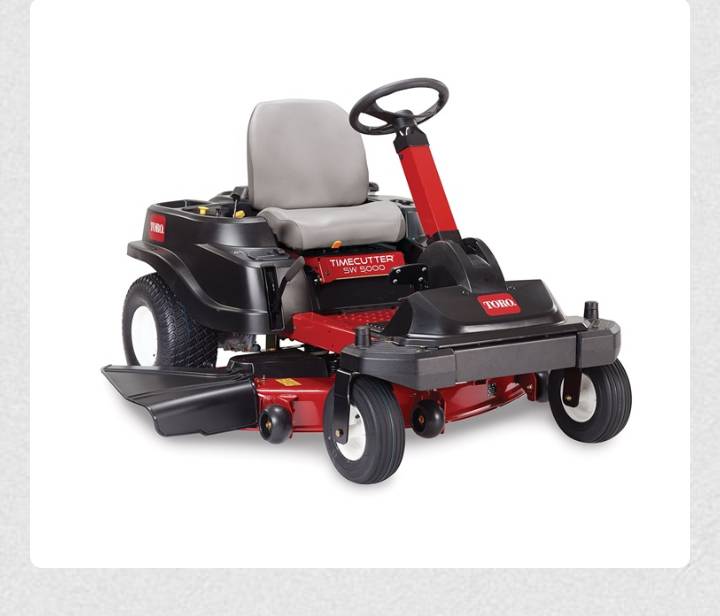

I just bought one of these last spring. Sticks to my hills great. Zero turn with a steering wheel, with a very low center of gravity. I was skeptical at first, but now I love it. I call it my "Forrest Gump zero turn ".20180416_200555.jpeg
