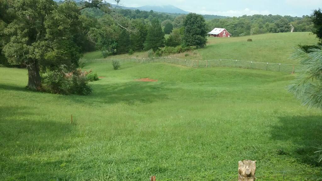

DNW64, when you say "steep", how steep is it? Get a 4 foot level and a tape measure and check a few spots. If you have 12 inches of rise over that 4 foot level, your slope is 25%. I'm wondering if mostly you need more seat time to get comfortable mowing sideways or if your lawn really is that steep. My first cuts were up and down hill until I got comfortable.

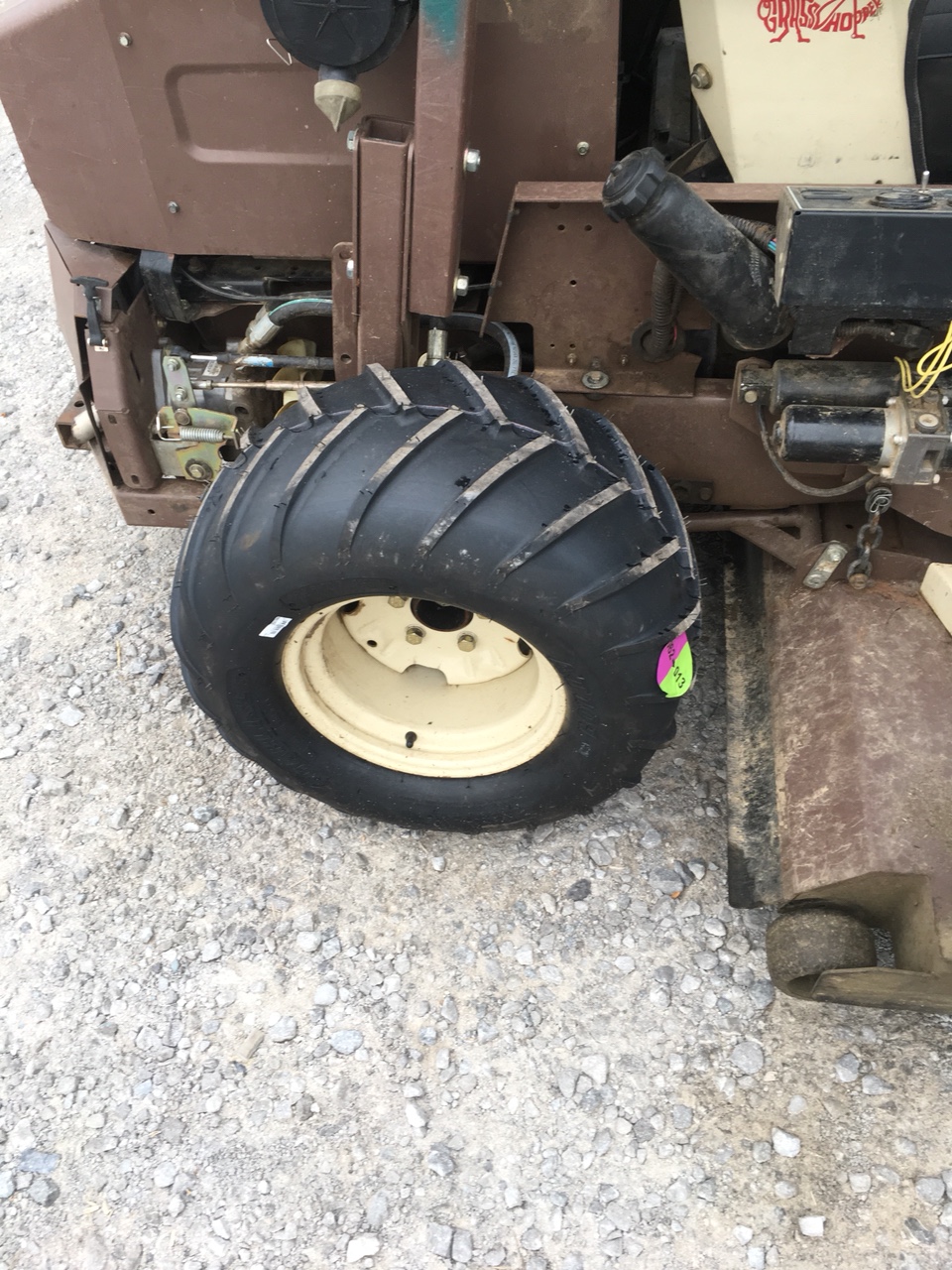

I haven't read the whole thread, but I suggest trying some bar tires (sometimes called chevron tires), such as the Carlisle AT-101 or the Kenda or OTR tires with that tread pattern. The traction improvement with that tread is truly amazing.

I have the IS700Z and had the same problem. Fix costs you about a hundred bucks. Go to ebay:
2PK 22x11-8 22 11-8 22x11.-8 Golf Go Kart ATV Tire 4PLY P322 Dimple Knobby | eBay
This tire is on an 8" wheel (from ebay too) rather than the original because I wanted a soft ride since I mow my pasture with mine and heavy clay soil cracks open and makes for a rough ride. The large balloon area run at 10 psig does make a difference.
Point here is the tread design. I have pond banks running 30 degrees and couldn't mow with turfs. So I started with bar lugs and then golf cart traction tires, then other stud designs of ATV tires and currently running these and I like them. If you are careful how you turn around ZT style, you can mow your lawn without tearing it up yet hang on with a hill.

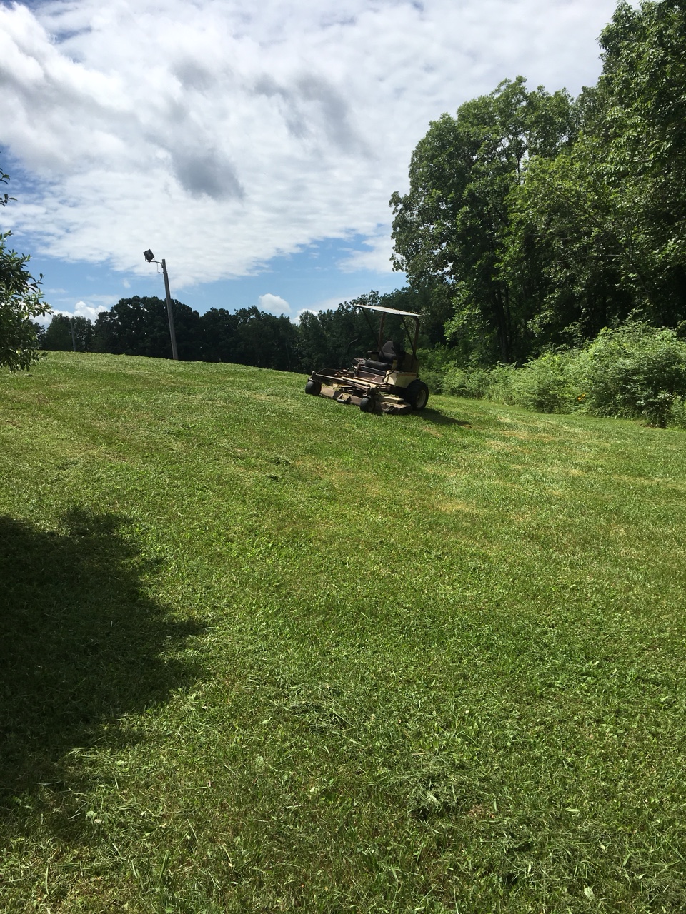

I mow everything I can across it. Its much better than up down. ZTRs don稚 drive down hills very good. Bar tires help a bunch. This hill is 17 degrees and it痴 about the limit of what I can drive straight down when wet without losing control, but it痴 no problem sideways. View attachment 567343View attachment 567344
Same tires on our toro now almost unstoppable

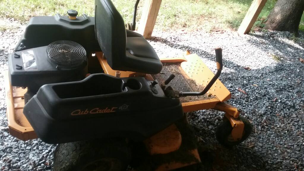

Sure is.
I got tired of the turf tires on my Z sliding off our hill every time.
Replaced the turfs with AT 101 bar tire and the difference is huge.
Same hills that always gave me problems with the turfs are no problem at all now.

Sure is.
Those are the same tires I have and if you can’t mow it with those then it doesn’t need mowed. I can push mud with the deck.

Well I started out with them because they work on my tractors in getting traction. Mowing my 30 degree pond banks weren't the same as plowing a field and I slid down the banks more than I wanted. So after several hundred dollars in different tire types I settled on these and besides a nice soft ride, hold better than anything else I have tried:
2PK 22x11-8 22 11-8 22x11.��-8 Golf Go Kart ATV Tire 4PLY P322 Dimple Knobby | eBay
I have them on 2 ZTs, one weighing around 1k# and the other 1300 plus my 250#. They are spec'd for 360# at 5 psig but I run them at 10 and they support the load nicely, have sufficient lateral stability on slopes plus I get the softer ride. One ZT came with 10" and the other 12" diameter wheels. I bought new 8" wheels for these tires allowing me to maximize the balloon area (over OEM installations) which reduces the shock when driving over the cracks that are common in my Houston Black Clay soil.
The other nice thing is the shoulders are rounded, and the ground contact points are many so in mowing turf, I don't have to worry about tearing it up if I don't go nuts with quick ZTs.

Finally had a chance to measure it.
The steepest part on my regular mowed lawn is 42% slope. There are many sections at 30-35%. There is one area in my pasture, which I have been mowing with my tractor rather than the ZT (since my BIL wheelied the ZT going UP it...), is 52%.

Just to make sure we are talking about the same thing here: You do mean percent grade, not degrees, right? The numbers mentioned in your post convert as follows
30% = 17˚ (degrees)
35% = 19˚
42% = 23˚
52% = 27-28˚
I run those slopes on my Craftsman Garden Tractor regularly. I did have to put chains on the rear tires to do the steeper end of that range reliably. I've been debating getting a zero turn. Are slopes in excess of 40% (22˚) really that much of an issue on a zero turn?

I didn't calculate degrees. In my book 100% Percent is where 1 Rise = 1 Run. So, sounds about right.
Slopes in excess of 30% are definitely an issue for my Ferris S400. I can't speak reliably about others, although my son concurred that the first day he worked for a professional lawn care company driving some kind of professional grade ZT (X-Mark most likely) he ran into a barn because he couldn't stop going down a hill. That is the biggest traction issue for me - stopping/slowing going down hill. I really don't understand why - I can't imagine there is a "lawn tractor" alive that has more rear:front weight bias than a ZT, but I've never seen any posts about them having trouble going downhill...
