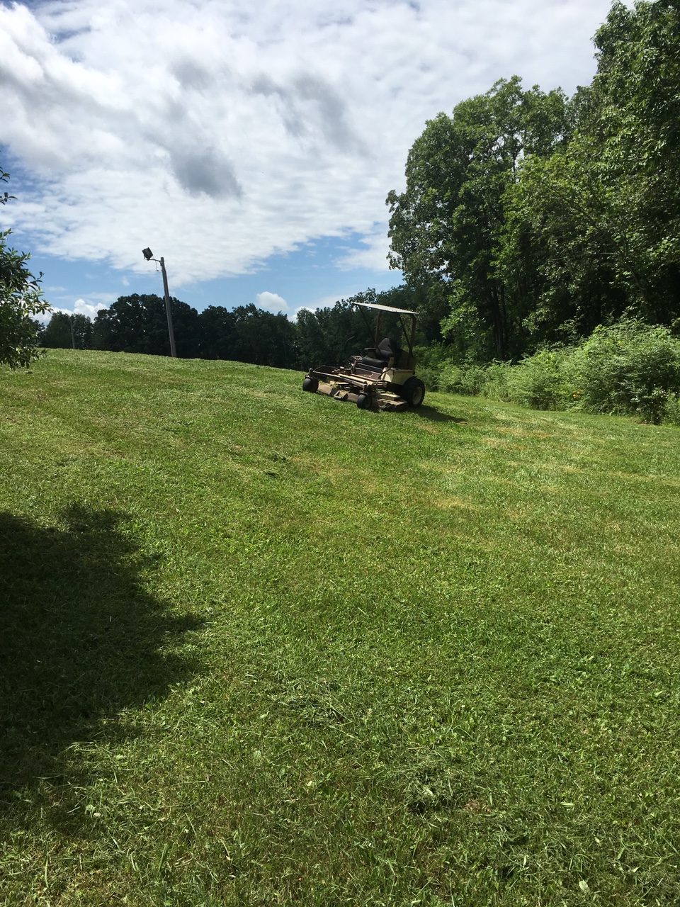

I mow everything I can across it. Its much better than up down. ZTRs don’t drive down hills very good. Bar tires help a bunch. This hill is 17 degrees and it’s about the limit of what I can drive straight down when wet without losing control, but it’s no problem sideways. IMG_4349.JPGIMG_4309.JPG

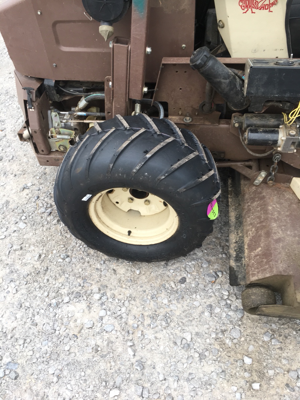

I mow everything I can across it. Its much better than up down. ZTRs don稚 drive down hills very good. Bar tires help a bunch. This hill is 17 degrees and it痴 about the limit of what I can drive straight down when wet without losing control, but it痴 no problem sideways. View attachment 567343View attachment 567344
please correct me....you will get more rear wheel traction if you reverse the tread pattern on the wheels. swap the rear wheels....
foam filled tires work wonders too
On Directional tires, I would assume, yes. The Kubota on the TedBrakes site has "reverse" mounted bar/R4 type tires. Make perfect sense to me.
What ?????
/ Zero Turn traction issues #19
What ?????
It started with the tires I have on my Grasshopper which are directional tread. They go forward better in the direction I have them which is what I wanted to do. But they would stop better if they were turned around.IMG_4309.JPG
