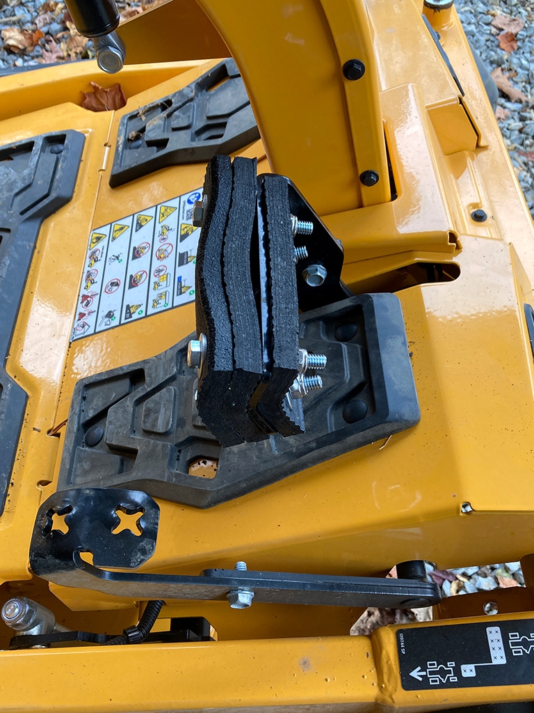

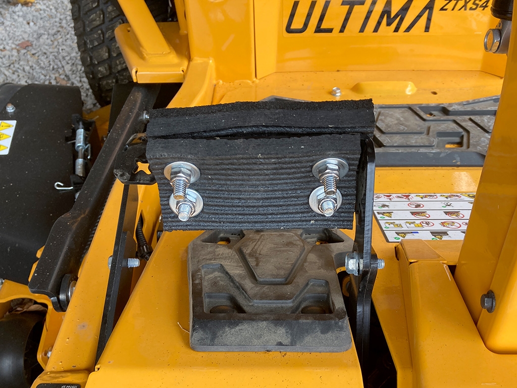

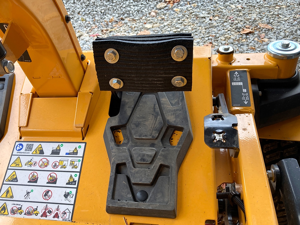

I'm impressed this thread is still going! Spent some time today working on a gas pedal modification for the girlfriend and figured I'd share some photos.
This only adds about an inch to it, but if she's wearing her big boots it will be fine. I cut up some scrap stall mat from Tractor Supply I had laying around and drilled some holes in it. Two layers on the front (to get 1" on top of the pedal) and 1 layer behind just to avoid having the washers/nuts directly against the pedal. 5/16" x 2 1/2" bolts with washers and nylock nuts.
Execution could be a bit better, but overall I'm happy with how it turned out. Maybe not the most elegant, but not totally ghetto either :). I had thought about counter-sinking the washers on the top side (so the bolt heads don't stick out so much), but I think this works fine and the bolt heads actually give it a bit more reach.

Nice mod. It's good that folks can still banter back and forth about which product is the best for them and no one gets their panties in a wad over it.

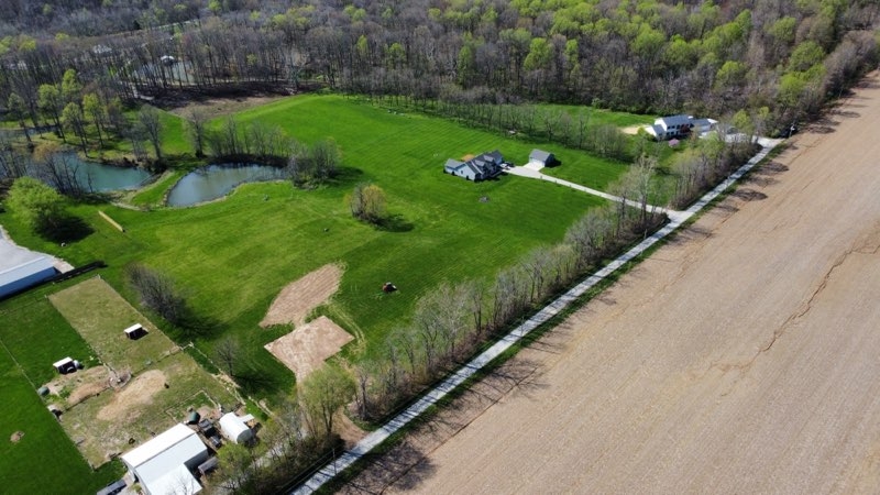

I’m looking at a stand on unit, and the Bad Boy Revolt has some great reviews by landscapers. Thinking about doing some lawncare on the side… I’ve perfected it over the past couple decades.
/ Lawn Tractor vs Zero Turn #174
That's some pretty grass you have there!
2 acres weed free…. The rest is “pasture grass” but still well maintained. Mowing is easy, lawn applications take some knowledge, still easier than the day job.
