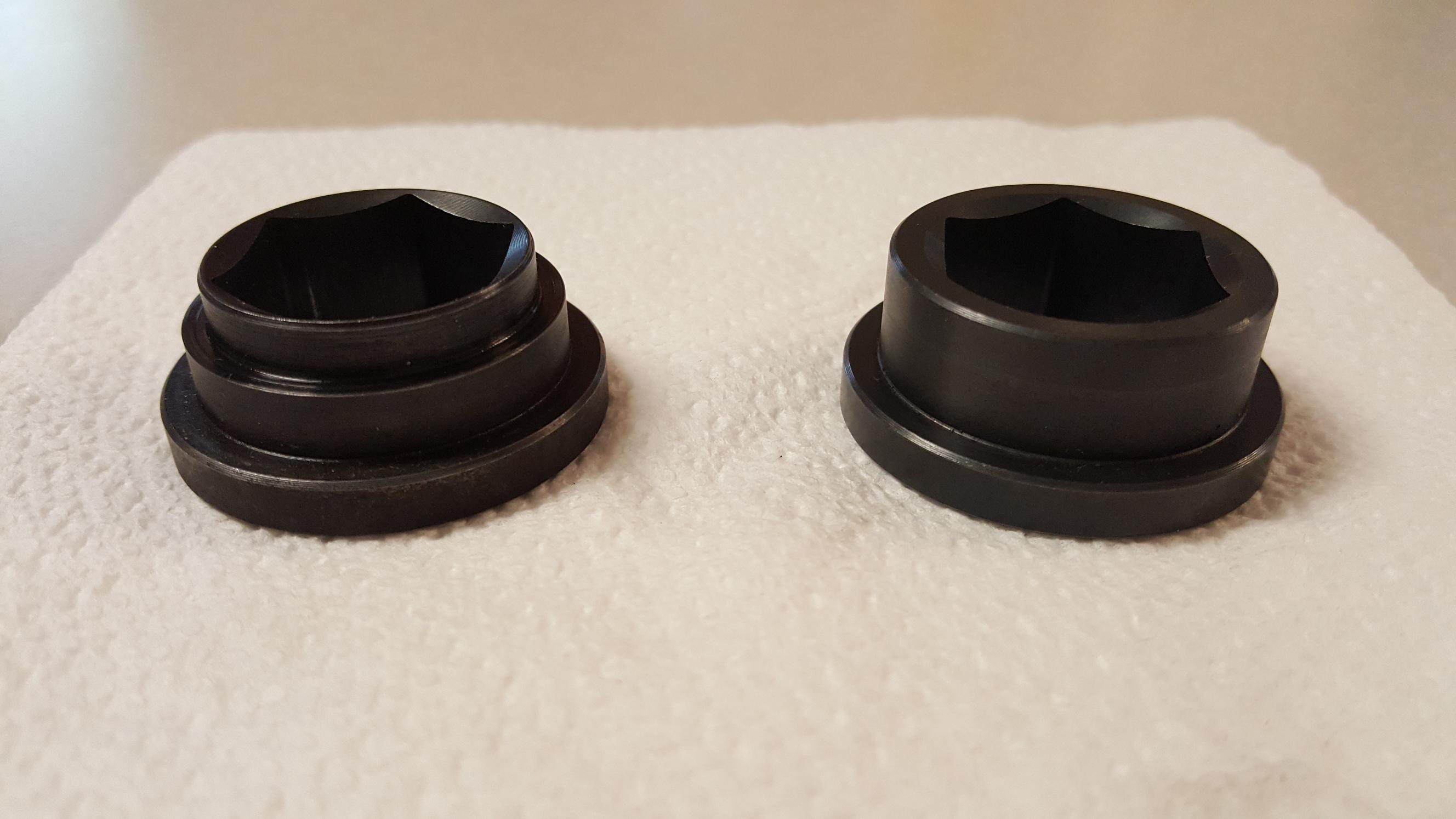

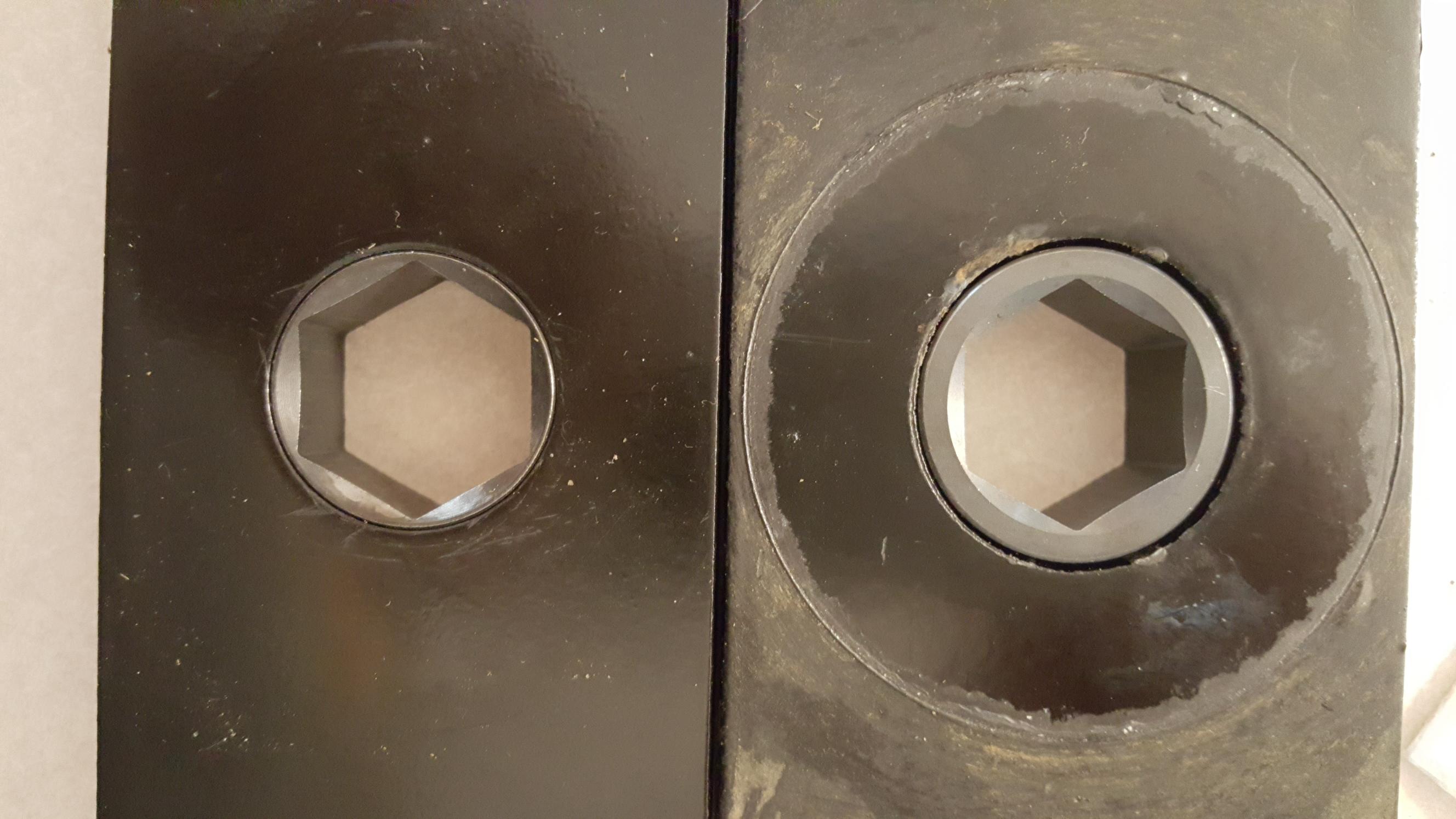

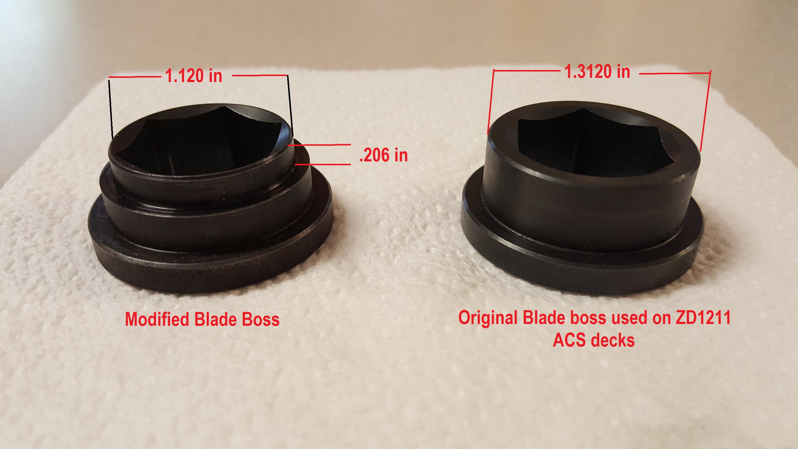

I’m going to do this same blade holder boss mod to my ACS 72 SD to run the same blades as my RD 72”.
I think the older SD Pro Decks accepted 1-1/8 center hole blades
/ Zd1211 blades #63
Read post #57

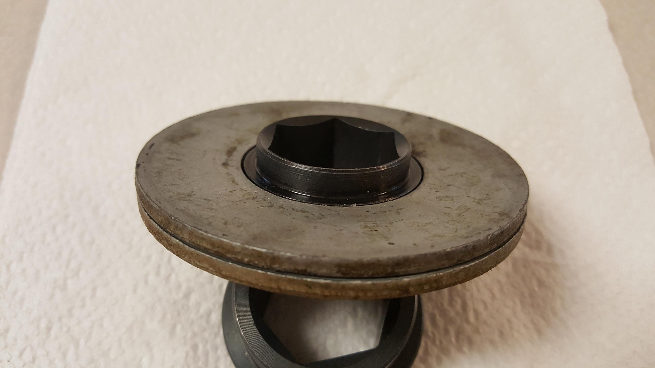

You guys that’s did the Blade Boss mod : used the same stock 1-5/16” ID cupped washers ?
/ Zd1211 blades
#66
Yea same washers. Your not machining down that far, so washers still fit down where it wasn’t machined down to 1 1/8”
/ Zd1211 blades #67

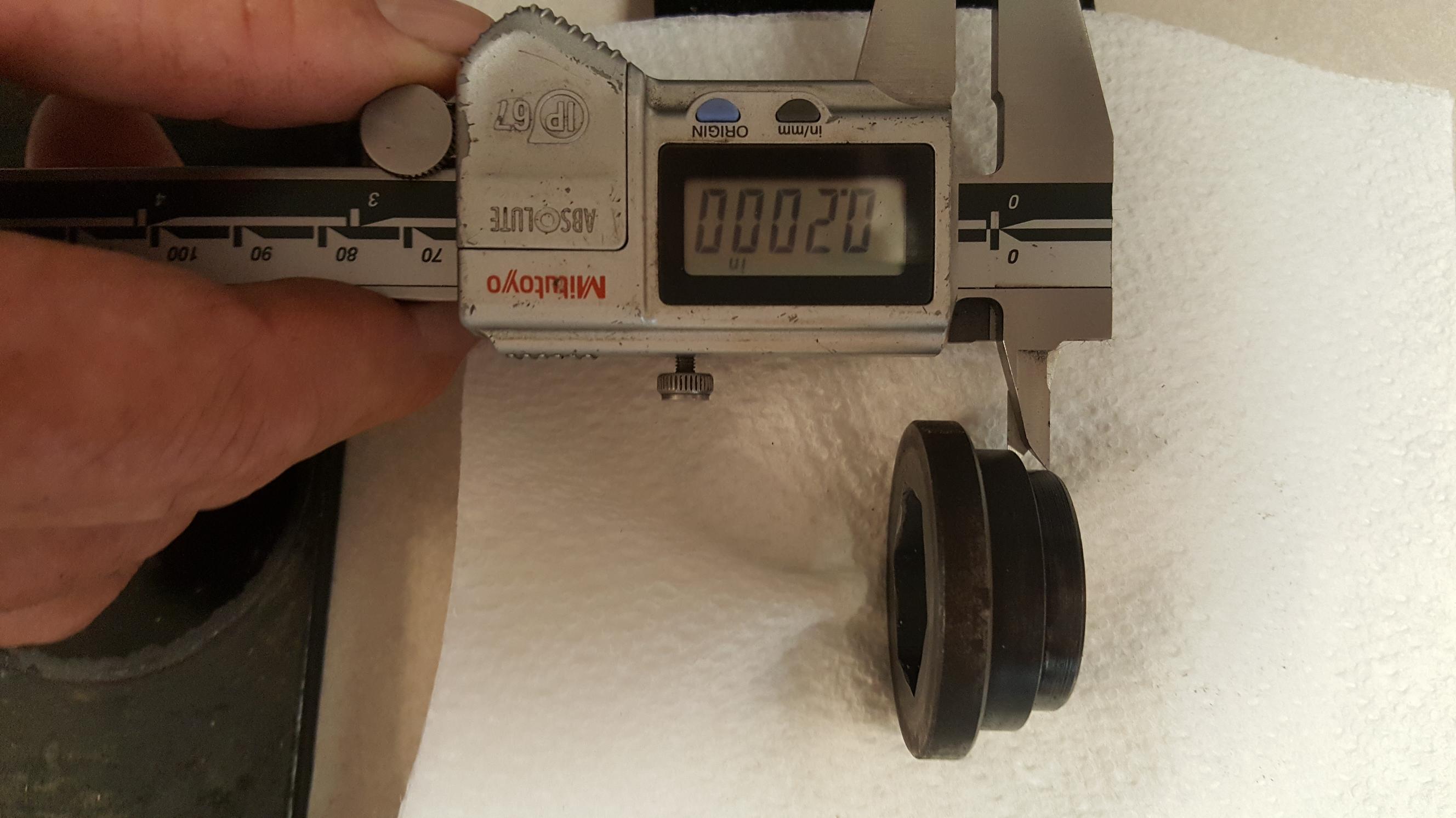

Ok. I answered my own question when I assembled it.
I bought extra washers, blade bolt & boss to keep on hand.
My machine shop is turning 4 bosses down to 1-1/8” Monday so I’ll have a spare.
I like keeping spare parts on-hand at all times.

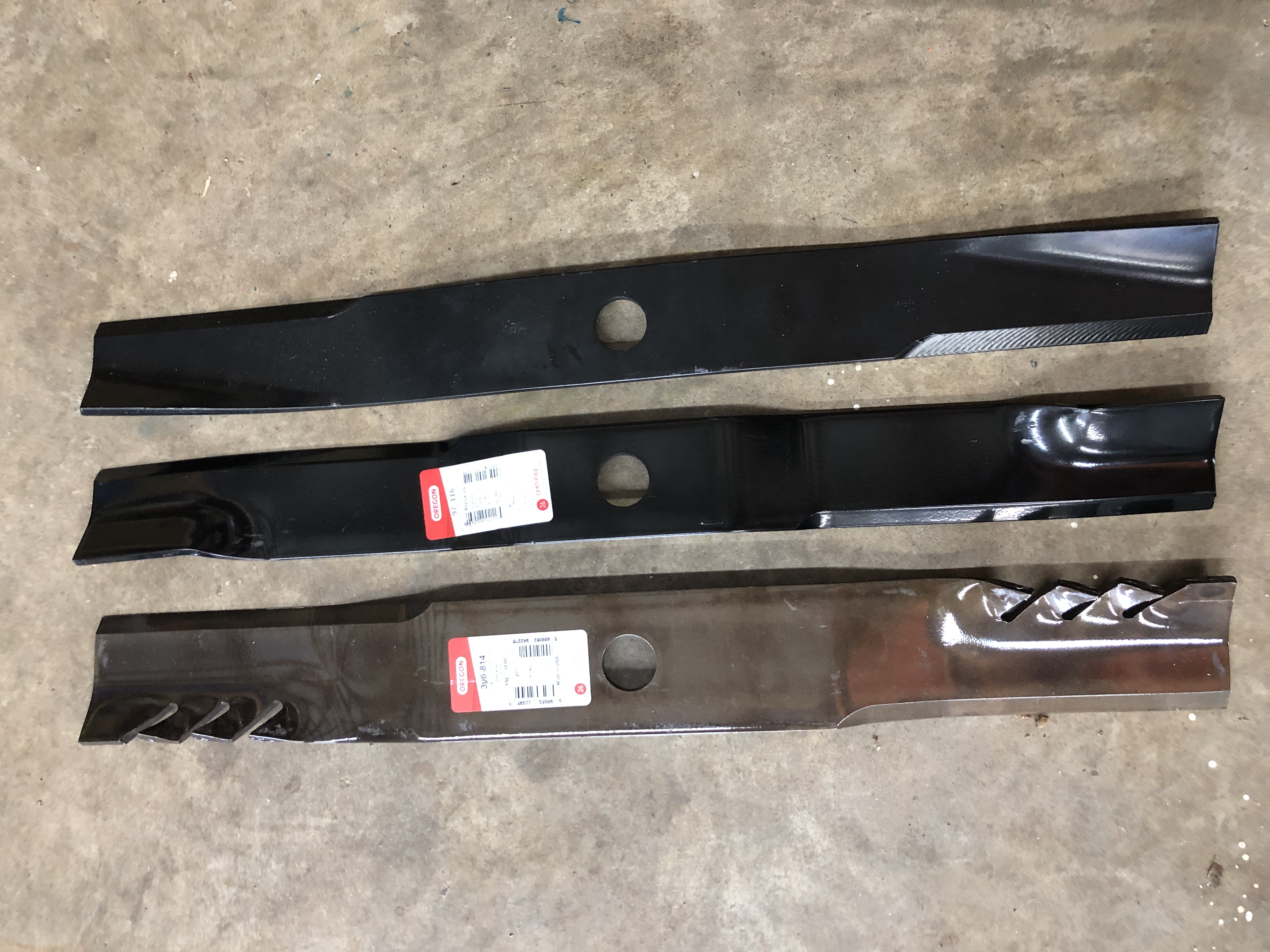

[SUP][/SUP] 1C85229E-A2EA-42C5-A67A-0D8BAEF49045.jpeg
Left 396-814 Oregon G6 Gator Mulching 3” Wide Blade
Center Oregon 92-116 Hi-Lift 2.5” Wide Blade
Right Kubota Stock Cheesy Thin OEM Stock 2.5” Wide Blade
All for 72 RD Deck OR for SD Deck with gonnasellit blade boss mod = 1-1/8 center hole
The Oregon blades are 1/4” (.250) Thick = Heavy Duty
/ Zd1211 blades
#70
[SUP][/SUP]View attachment 658217
The 92-116 mow nice but flex a lot where the flat meets raised portion of blade. Lay it on ground and step on it lightly and see how much it bends
My previous post I was saying I bent a set of stock 1 1/8” blades but I looked again and they were these 92-116 1/4” thick Oregon’s For all i know I could have bought them bent (from amazon) and not noticed until I tried to check deck level.Let me know how you make out with yours. On a flat surface the cutting edge is off over 1/8” from one side to another with MAYBE 4 hours on them in flat nice grass
As I write this I’m thinking I got a defective set or they were ran over or crushed in warehouse
/ Zd1211 blades #71
I’d think it would take a serious hit on the mower to bend or warp a 1/4” thick blade.
My stock Kubota blades brand new will not lay flat on the table or bench best I remember.
Both these Oregon blade cutting edges are strait & flat

I’m doing my 250 hr service tomorrow and putting on the machined hub for the 1.125 blades.
I’ll give a report tomorrow night.
/ Zd1211 blades #73
I’m doing my 250 hr service tomorrow and putting on the machined hub for the 1.125 blades ...
I bought 4 new (1 for spare) K5955-34380 spindle boss blade holders & had machined down for my 72” SD to accept the Oregon G6 Gator Blades like I’m running on my 72” RD Deck.
These Blades are Awesome.
Thanks Again to gonnasellit for his R&D work :thumbsup:

I’ve put about 10hrs on my 1211 since I put the machined hubs and Oregon Gator G6 blades on. It definitely made a + difference in the cut quality, it also
Is leaving a definitely noticeable stripe.
