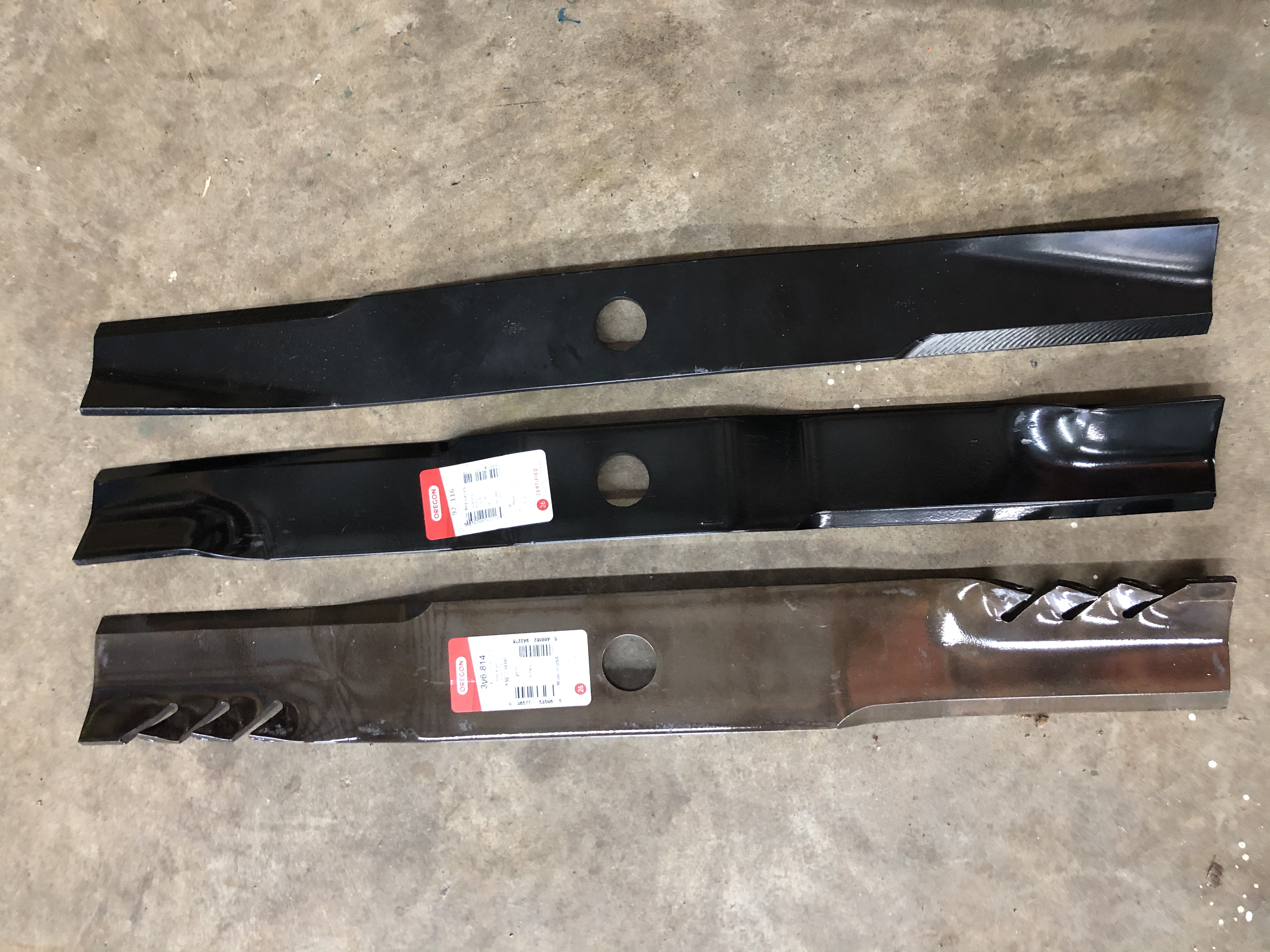

I liked the G6 Gator blades other than the mentioned blow out from under front side of deck mowing at 3.5”
They cut clippings finer but doesn’t seem to blow the clippings out SD Deck as well as the high lift winged blades imo

I have been running G6 on a 72" SD for 2 years. I like them but in the fall when it is dry the front blow out can be annoying. I have machined a number of sets of the holders for these blades for other owners.
I quit running G6 Gator mulching blades with machined down blade holders on my 72 SD deck because of the blowout from under the front side of deck.
I’ve ran stock blades again this season but just ordered some Oregon 92-116 old style Pro Deck blades because of the higher wing lifts to see if they would sling clippings out any better.
I hate to loose 1/2” of blade width with them compared to the 3” width stock OEM ACS blades

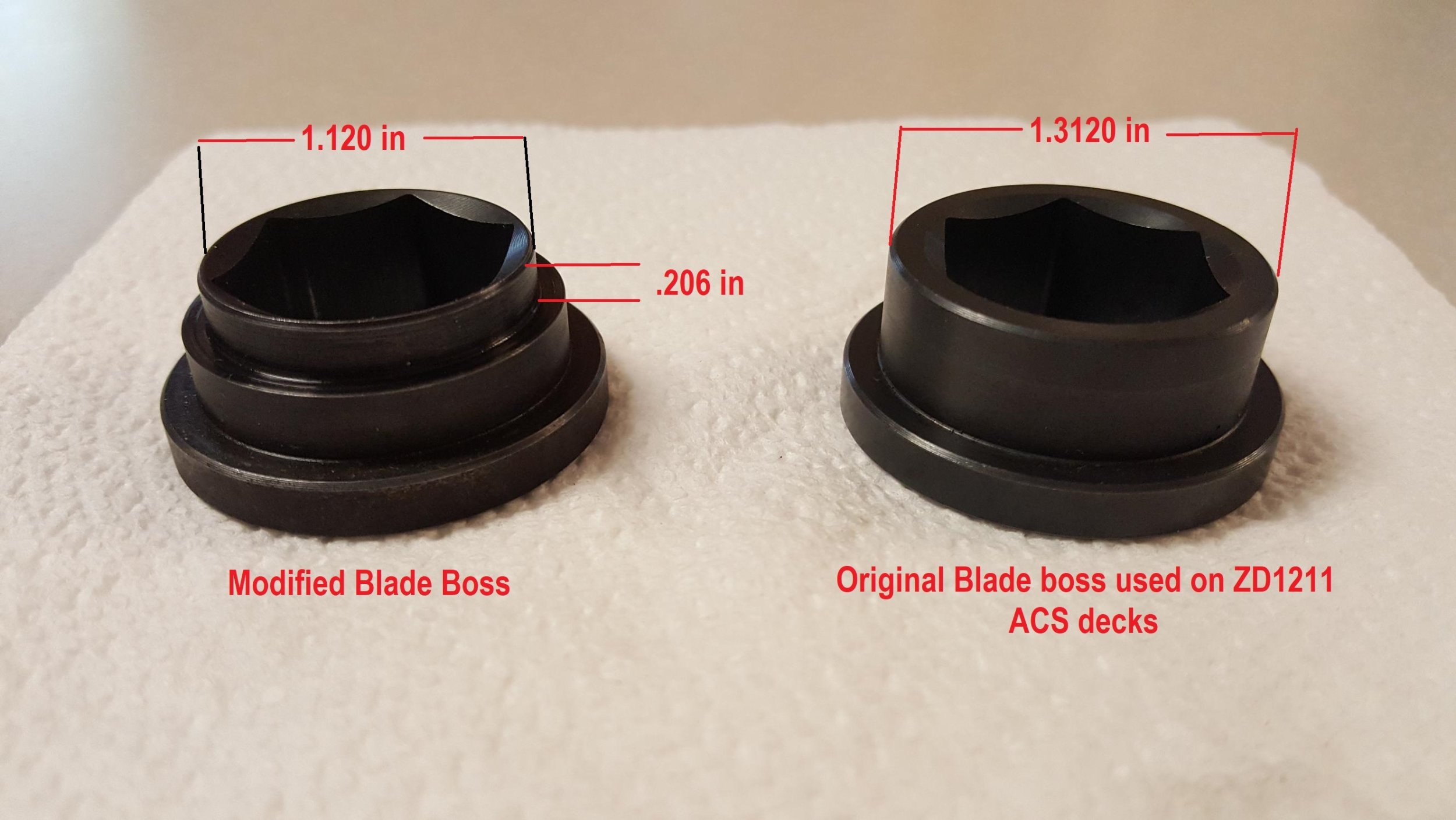

I got the Pro Deck 2.5” wide Oregon hi lift # 92-116 blades on my 72” side discharge ACS deck with my machined down blade holders as member @gonnasellit informed us all on : to accept the old style blades with 1-1/8” CH.
they blow clippings out the side chute deck with more force than the stock 3” wide OEM blades.
The cut quality is about the same.
they seem to create a little more dust & rob a little power in thick heavy grass compared to the stock 3” width OEM Kubota ACS blades
I’ve mowed with them 4hrs so far & hadn’t noticed blowout from under the front of the deck like the G6 Gator blades did.
I’ll mow more hours tomorrow ....

One more pic to clarify:
5 year (hard to believe) followup, your bushing mod has been working perfectly for the past 1500 hours or so. Thanks for taking the time to post the detailed info!

I’ve used @gonnasellit bushing spec mod for several years flawless too on my ZD1511 72 SD.
The old pro deck blades with more lift on wings really distributes HEAVY Clippings way better than the wider flatter stock ACS blades
Thank You Sir
