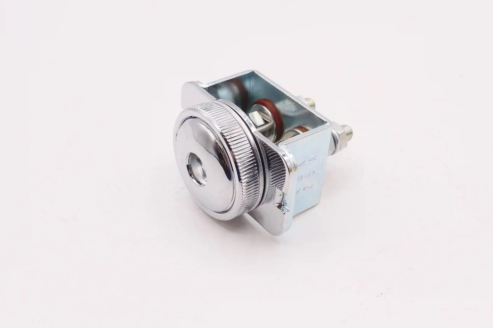

Do you happen to know if the glow plug indicator receives current independent of the glow plugs? I haven't looked at the circuitry yet, but it would certainly be a promising feeling if the glow plugs only received current through the indicator. My indicator does not glow at all.

The "glow" coil on the B7200 is in circuit with the heaters.

It took a couple minutes to get it started this evening. Once again, without ether, but man it took a while. The battery is good and it seemed to crank fine. It had a periodic puff of white/light gray smoke, but most puffs were black. Prior to starting, I held the key in the glow plug position for at least 30 seconds -- the glow plug indicator didn't illuminate (I assume the wire loop in the peephole is supposed to glow, but nothing).

I swapped out the glow plugs earlier today and it fired right up. The glow plug indicator lamp still doesn't work, but I haven't had a chance to get into the dash wiring yet.
