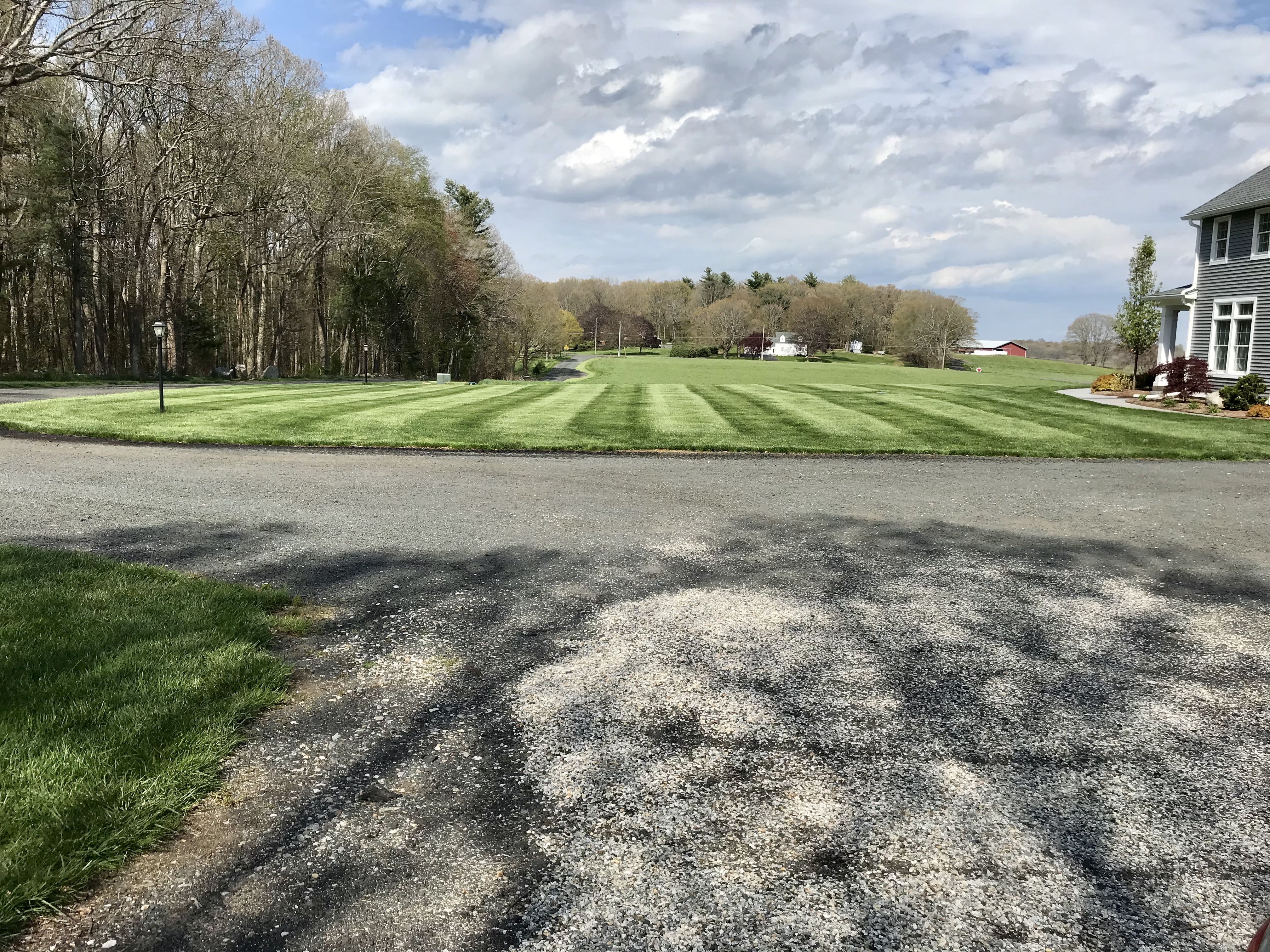

Stock blades and a rubber flap behind deck for striping kit. I do have the modified blade bosses and Oregon g6 waiting to go on

VERY NICE Job AND pic.
Is that a chicken, turkey or hog house in the background ?
It’s actually a cow barn. We raise a bunch of beef cows and bale hay .... after my regular 40 hour job. So my zd mows some nice grass then some not so nice grass around the farm. By the time I get to it all it’s about a foot tall and takes twice as long to mow as it should, hence why I really wanted the 1511 model

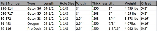

Hopefully I'll get this right.
The ideal depth of cut is .206 instead of the .200 shown in the pic. The diameter of the turned down section should be about 1.120".
