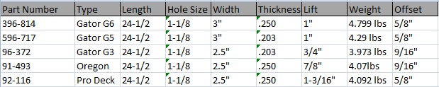

The cost savings on blades should pay for the parts in a short period of time. I just ordered 12 blades (top of the line, Oregon Gator G6, 396-814) from a vendor on ebay for $14.17 ea including shipping. I mow a lot of sandy ground and the mulching blades last much longer than a standard blade. The older style blades are much cheaper due to their widespread use. Oregon alone offers at least 5 different choices of 72" blades with the 1-1/8 hole vs none for a 72" with a 1-5/16 hole. I like it!

These are the 72" blades with 1-1/8 holes I found on various websites:
Oregon:
Stens:
330-801 Standard 24 1/2 1-1/8 2.5" .250
302-837 Toothed 24 1/2 1-18 2.5" .250
BTW, I have no affiliation with Oregon, Stens or anyone else who makes or sells blades. I'm just sharing what I spent many hours researching!

That’s exactly why I went with the 1/4” thick 3” wide Oregon 396-814 G6 Gator Blades.
Their Strong & more flat than the curved, thin cheesy Kubota OEM blades

The Oregon 92-116 blades are 1/4” thick 2.5” wide & has hi lift wings.
I’ve got a set of those ordered to try
