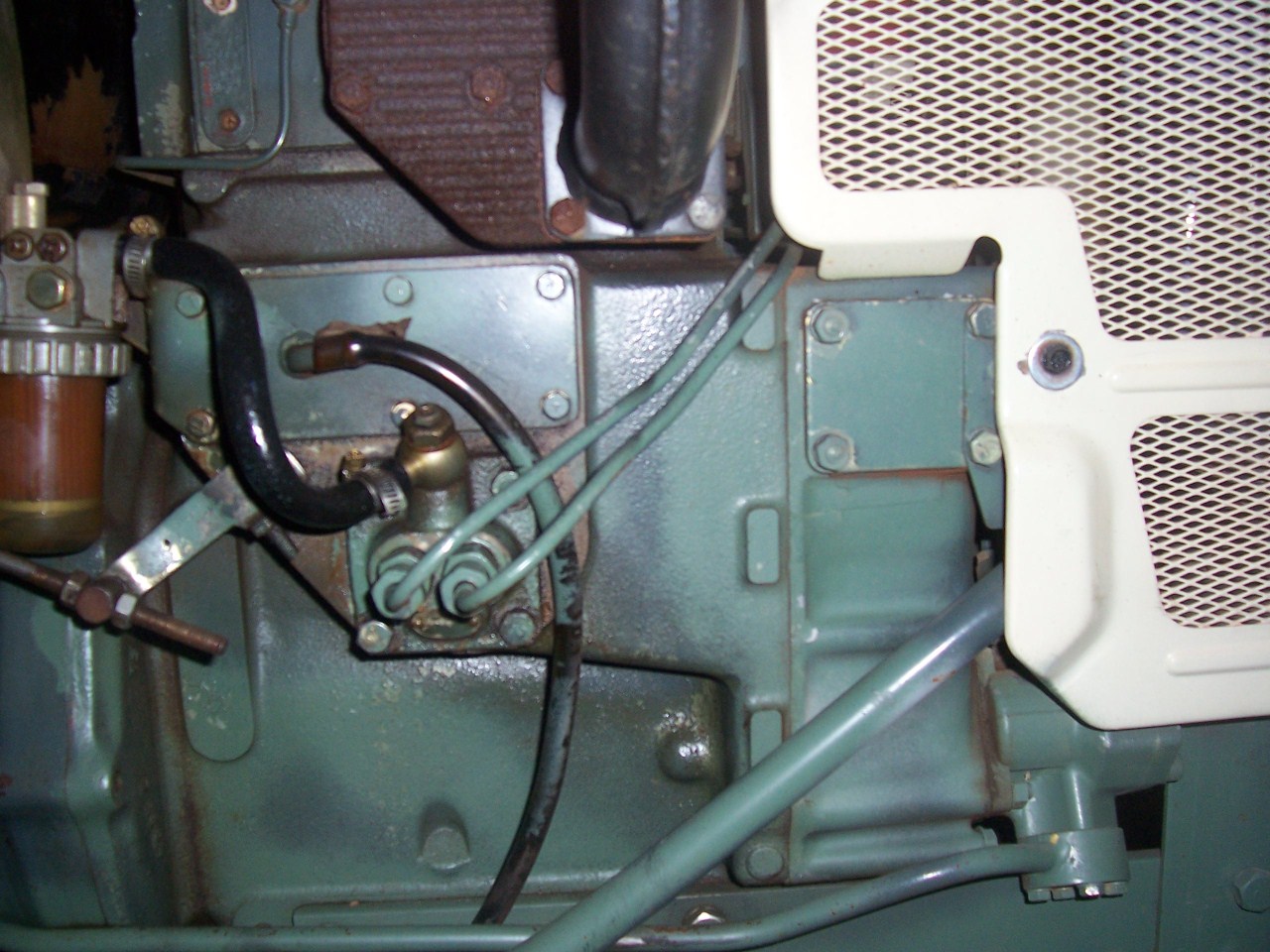

fuel tank has been flushed,cleaned and new filter.....i'll pull the plate and have a look....

I would run injection clearer in your fuel, like Howes or something similar. Even if you changed your filer there could still be gummed up issues past that point
/ ym240d #15
Pull the bleed screw at the injector pump & check flow. Might be the line from the filter to the injection pump is full of crud.

i have injector cleaner in and have good flow to the IP.......i pulled the cover and the rack was sticking....cleaned it with carb cleaner.
it pulls much better and i'm getting some smoke when it lugs down...
thanks for eveyones help!!!

/ ym240d #19
I decided it maybe a good idea to go check my Linkage plate to make sure my linkage is staying clean and no water dirt Etc. could be getting in. That time of Yr. and will have to hook up the FM this week it looks like. I believe I'm good and doesn't appear I may need to check my linkage for dirt or water etc. 11yrs it's been outside under a overhang. Only a couple hundred Hrs. on the Fuel Filter so I don't foresee any problems. My plate looks all intact and tight and in good shape as does my Fuel Filter and Bowl. Only sat about 5 months so it's not all that long but a good bit though. Don't recall any blow bye and if this is the plate I'm sure it's good.
