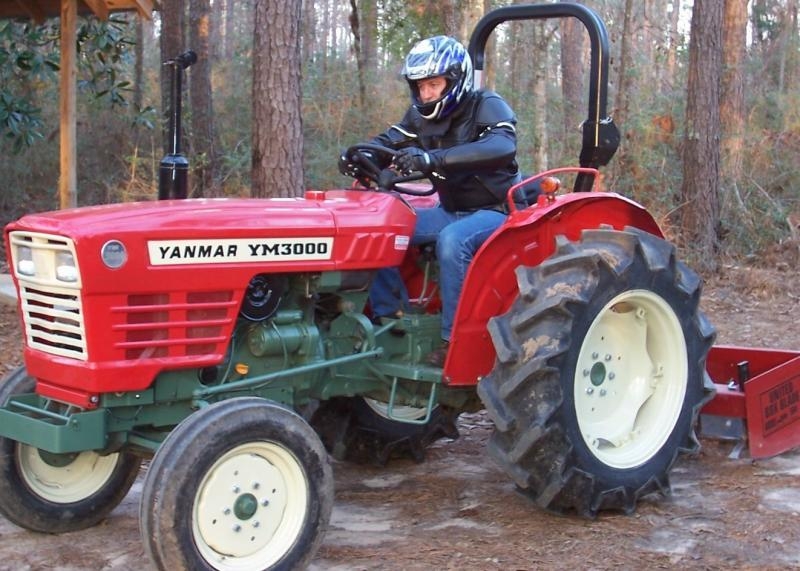

The YM3000R, you'll need a racing helmet like robin has here,

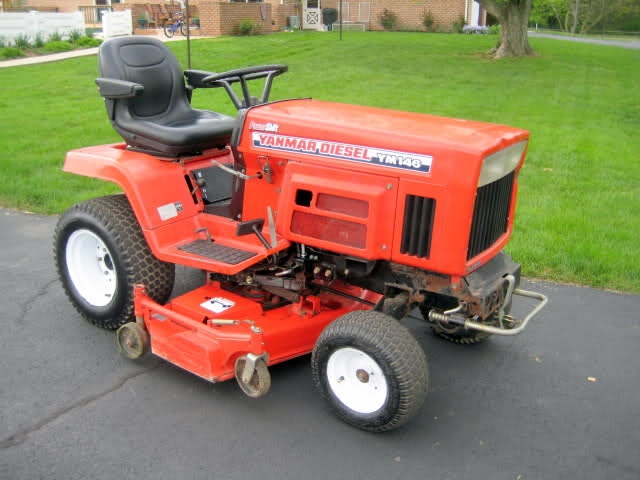

In the photo of the 146 attached it has lines coming out of the front what is that for?
