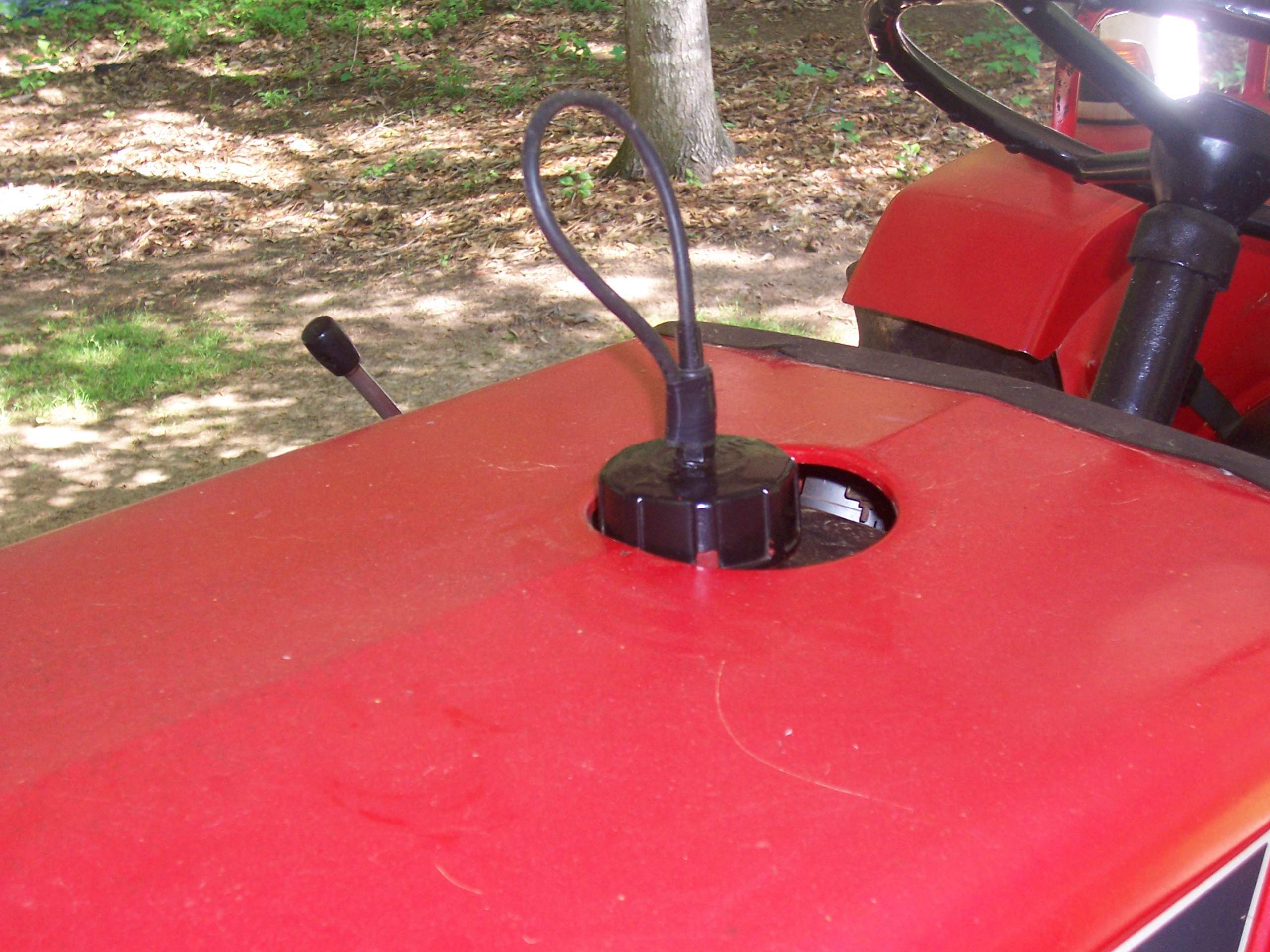

I did have a pressure build up problem so I had to relieve it. There is a return line from the Inj. to the Tank. I had a bad problem with fuel getting blown out of the Tank and leaving a puddle on top of the tank every time I used it. Made a Rubber insert and then seen the small air bubbles still coming out!! My guess is the Return is what is actually pressuring up the Tank. Which ended up to be a easy fix after finding that out. In the Pic. is off a Old ATV. fuel cap. Never even had a fuel issue since and I'm talking Hundreds of Hrs. on the Tractor. Just Reg. Maint..... I can see the Factory Blk. emblem still on the hood. Over 10yrs. easy.
