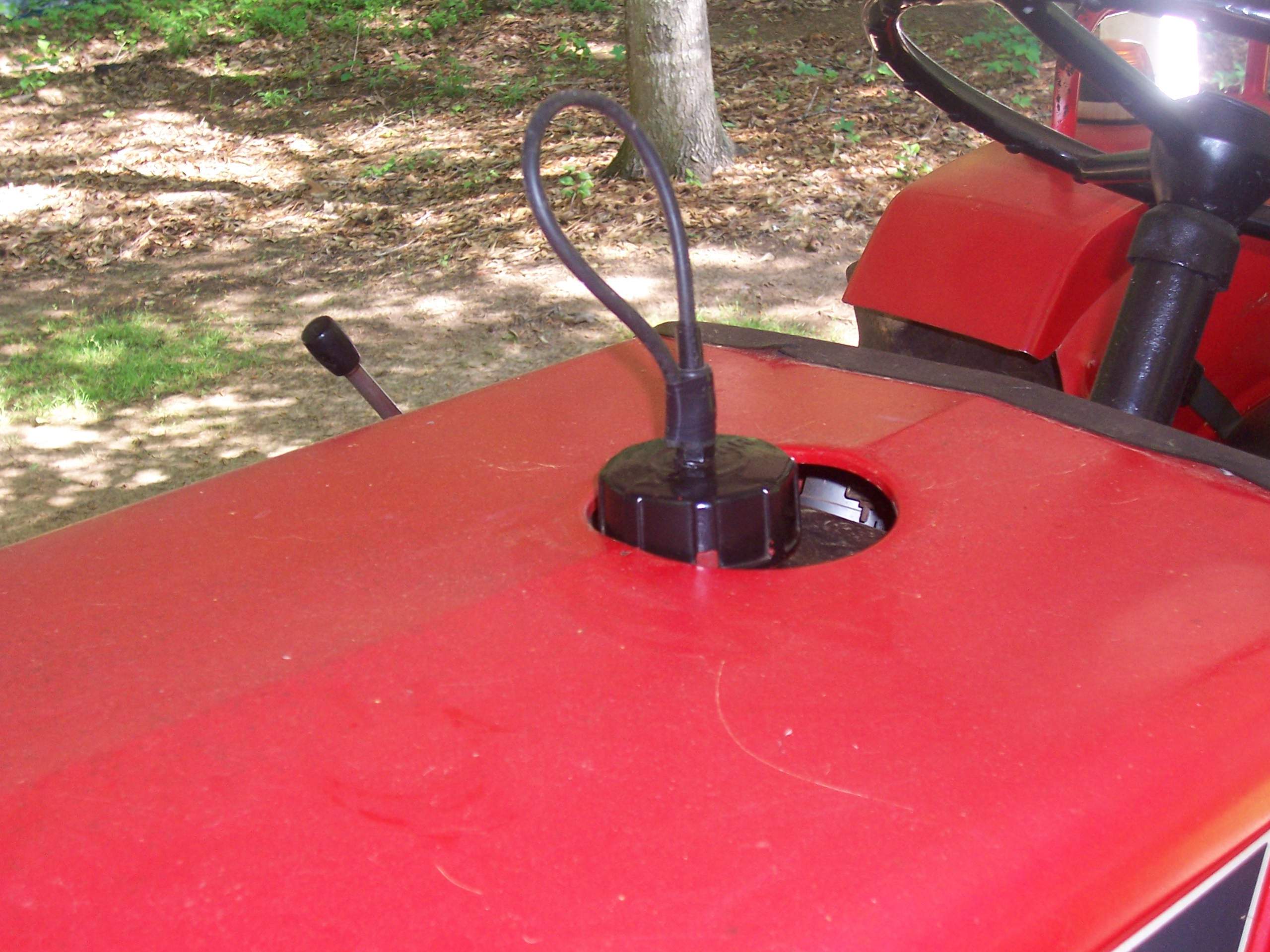

Remember only tighten your fuel cap tight enough to not vibrate off

How about coating/sprinkling the fuel system w/ baby powder.. & pressurizing the fuel tank.??
Look for leaks.. not much, just a few lbs of compressed air will do the trick..
it'll show u cracked/brittle fuel lines, bad connections at the fuel filter.. leaking bleeder screws on the IP..
& maybe even bad orings on the DV holders on the IP..??
