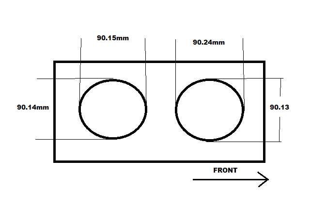

So I did a compression test and its not good, I hooked up a smoke machine to see where my leak is and I have leaking valves and rings :eek: , so I took the head off, cylinders dont look to bad, I measured one of the cylinders its at 90.13mm need to measure other one but ran out of time,maybe I ball hone it and just re-ring it, I will take the head apart in the next day or so and see what I have :confused2:

I think that's a sleeved engine, if the cylinders are too far gone.
Yes, it is sleeved, It is a 2T90, I measured the bore on both cylinders info below, now my measuring devices are not high quality but I think it is close.

WS-90 wet sleeve @90mm I'd be checking the Pistons and if not a lot of wear Hone it and ring it. Worst case new pistons also..

Going to pull pistons and see what they bring me, just looked in service manual and Im right at acceptable on the liners.

Got the pistons out and they are within spec,the rod bearings have some wear so I will change them.
