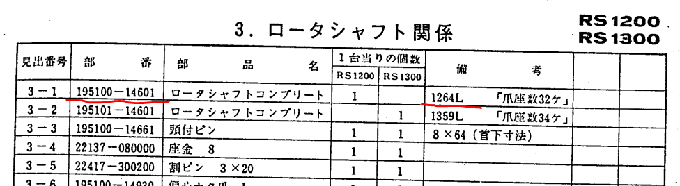

I've replaced the tines once. Got them from Hoye as I remember. There's a serial number on the gear end (23721T)

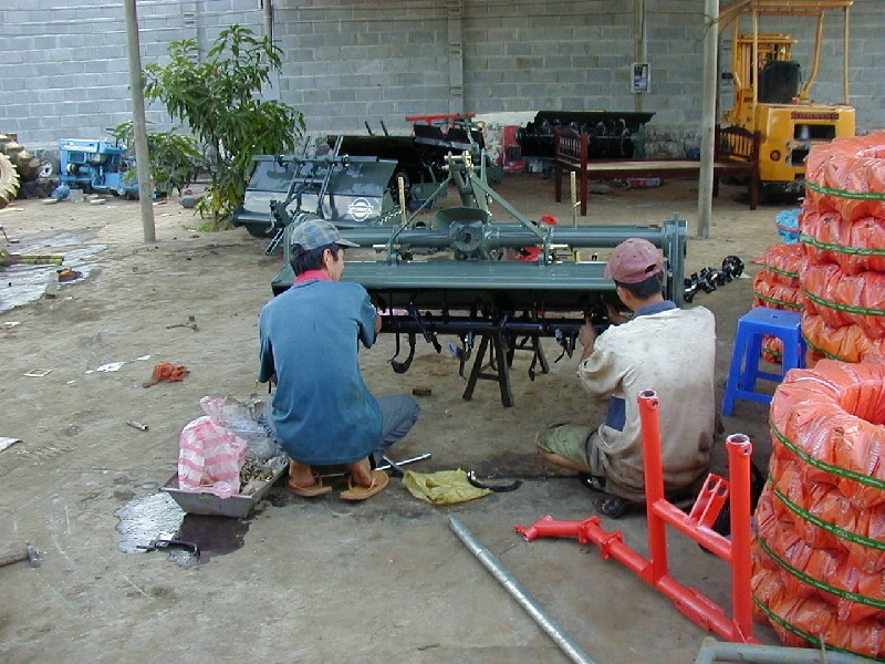

,,, since the Yanmar logo marking and the color don't match up ... your tiller is difficult otherwise to identify.
20-some years ago and far away, in the PNW corner of the Left Coast (inside joke) an importer (not Ernie or Buck) posted a full photo series of the rebuilding process in 'his' rebuild facility with some 250 employees just north of Ho Chi Mihn City (Saigon).
This photo may resolve the mystery of the large unexpected Yanmar logo on this present tiller.

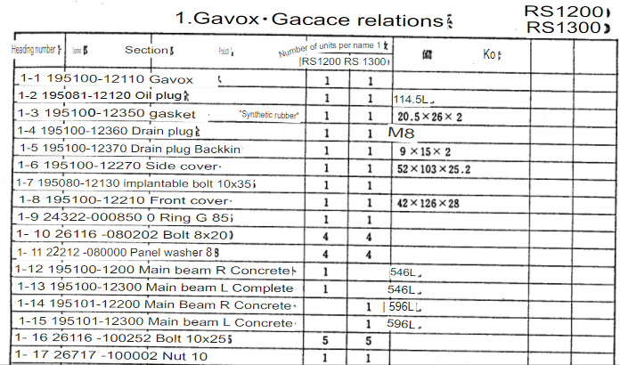

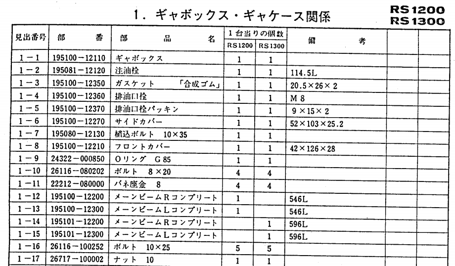

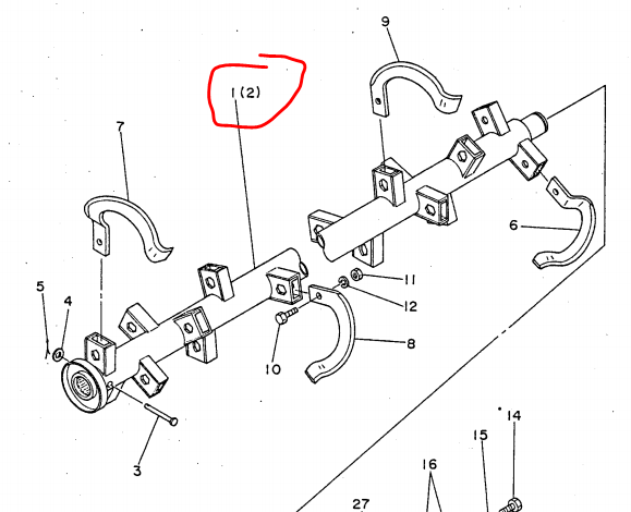

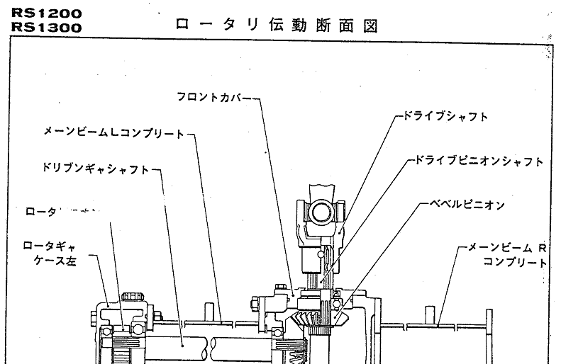

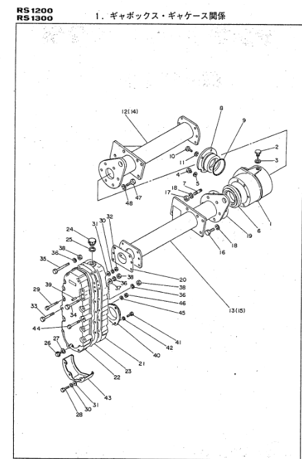

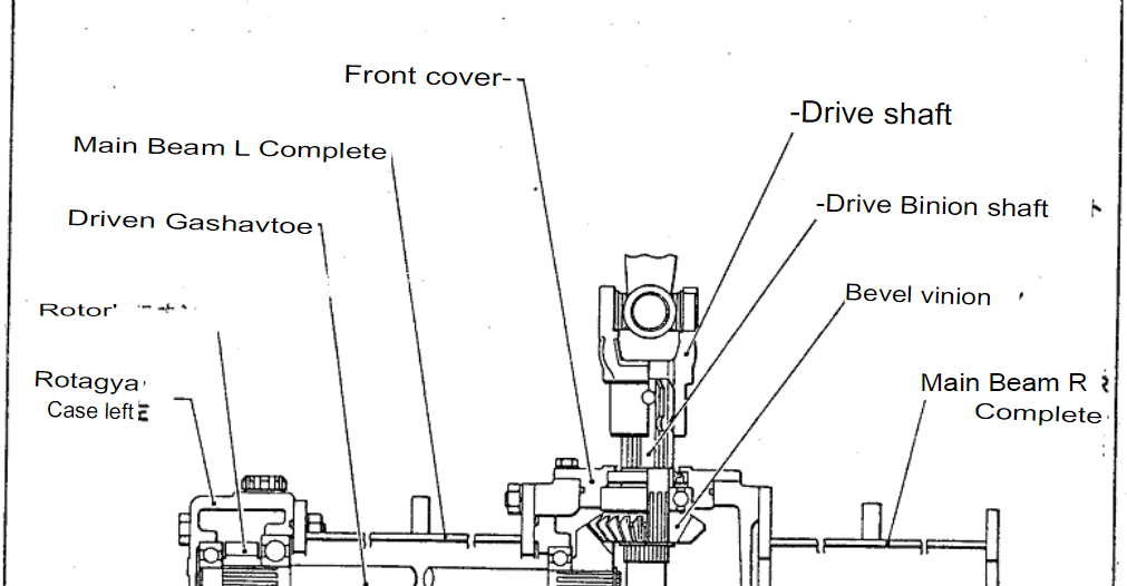

Figured that a Part # or Tine# would work!! I came up with a RS1200.

WOW, that is some really neat history. Look at all that new hardware being installed. :) That would be me on the left, ballcap, jeans and flipflops working on machinery in the garage.
