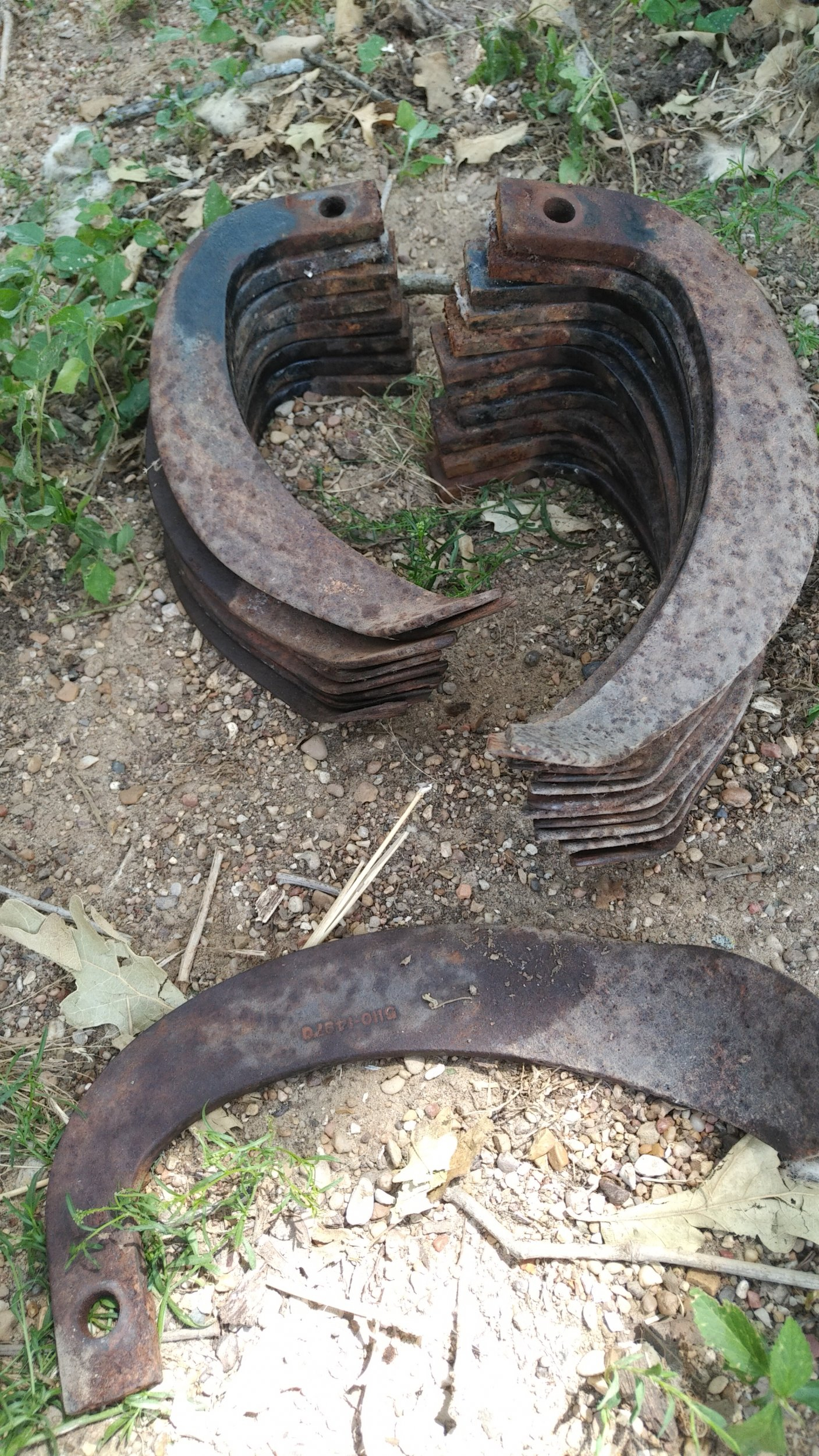

Good eye! Goodness, you are right, they are everso slightly different in size! I didn't even notice as I was stacking, just that some were slanted one way and others another. Lol wow. She said she's seen sets on eBay before. Once I figure out which is correct I will take a look.
Yes, there will be sets going one way and the other. Even in the modern Yanmar tillers it's the same.

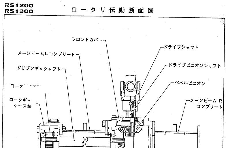

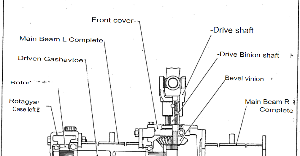

You already know Japanese.
Copy page section as image, then past into Yandex OCR. Pick Japanese <===> English.
Page-5 upper left side.
Via Yandex
If it translates funny, zoom in a little more and try again. ;)
Drive Binion shaft = Drive Pinion Shaft
Bevel Vinion = Beveled Union.
Rotagya Case Left = Rotary Case Left.
Japanese is based on phonic sounds to symbols, thus even in translating we sound out the words until it makes sense.

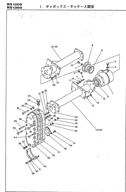

Lets try another one. :)
Page 7 on the parts side of the diagram to the right.
Bouncing to the diagram and then this list, you can figure out the names.
Now with that said, if you find a part, and it translates really whacky, drop the p/n into a search engine and see if the findings turn up with a proper name. I've done this on many manuals already.

FWIW: Hoye Tractor sizes the times by the size of the bolts. 10mm small & 12mm large. The small set has 32 tines, with a note that the special "end/center" times are no longer available.

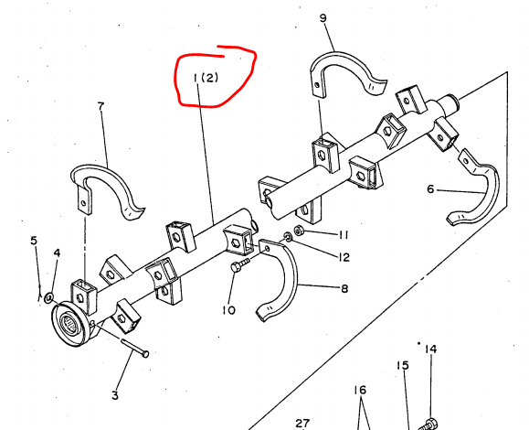

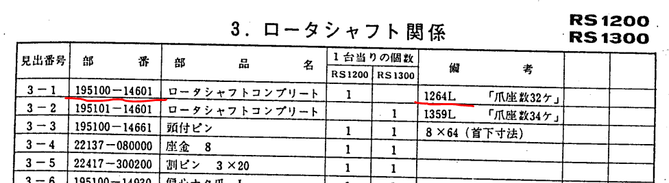

In the RS1200/RS1300 section, go to page 9. Look at item-1.
This is the parts list to the right.
1264L = 1264mm Long.
1264 / 25.4 = 49.763 inches. You measured 48 inside. That item-1 shaft goes to the outside chain case too.
Deduction, you have an RS1200 tiller. :)
The RS1300 is 1359L (1359mm Long.)
1359 / 25.4 = 53.50 inches. Thus it's a 52 inch tiller.
Glad the mystery is solved. Now it's up to you to work towards the restoration. Keep posting to this thread as you make progress. It will keep us intrigued and help others in the near future with an RS1xxx series tiller.
I'm still amazed at the big round Yanmar logo on the machine; Wonder how it became to be on the tiller.
